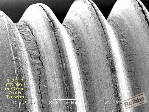

吴老师的每张图片都非常经典!第一次看到氮化层中的裂纹。又长见识了。
签到天数: 474 天
 楼主| 发表于 2012-1-21 22:56:02 | 显示全部楼层
Mr. Shen:
It's also my first time seeing microcracks in a nitrided layer. So, it is my hope that you elite metallurgists can share my experience and broaden your horizon.
I'd say, without the help of SEM, there is really no way that you can see these microcracks.

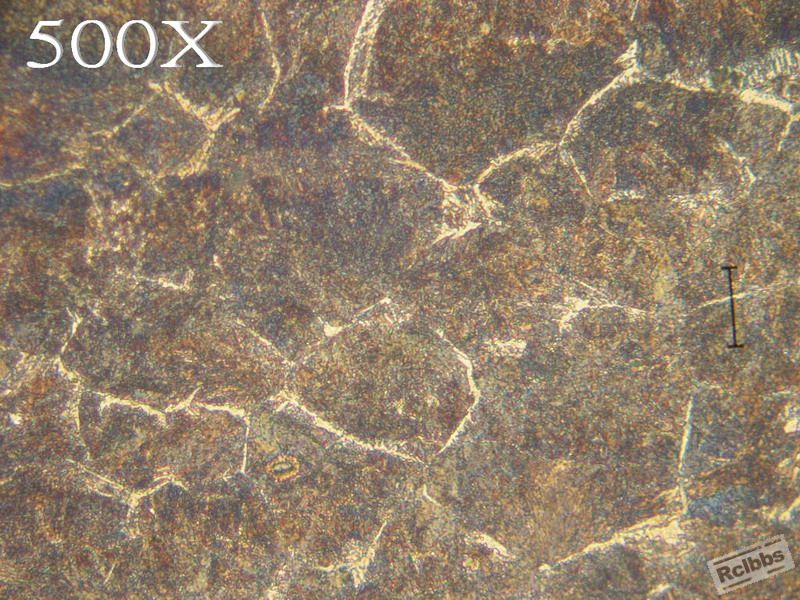

 楼主| 发表于 2012-1-22 14:35:53 | 显示全部楼层

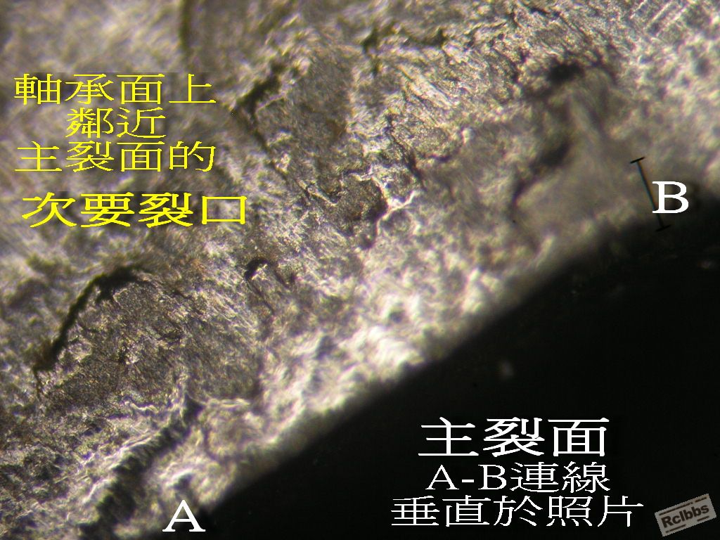

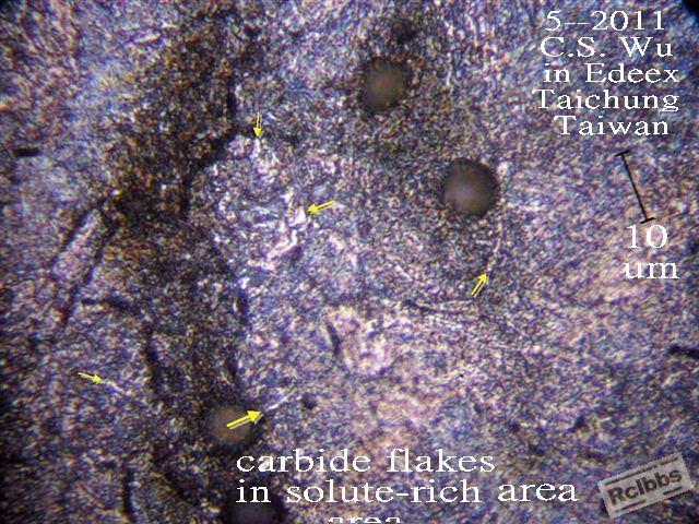

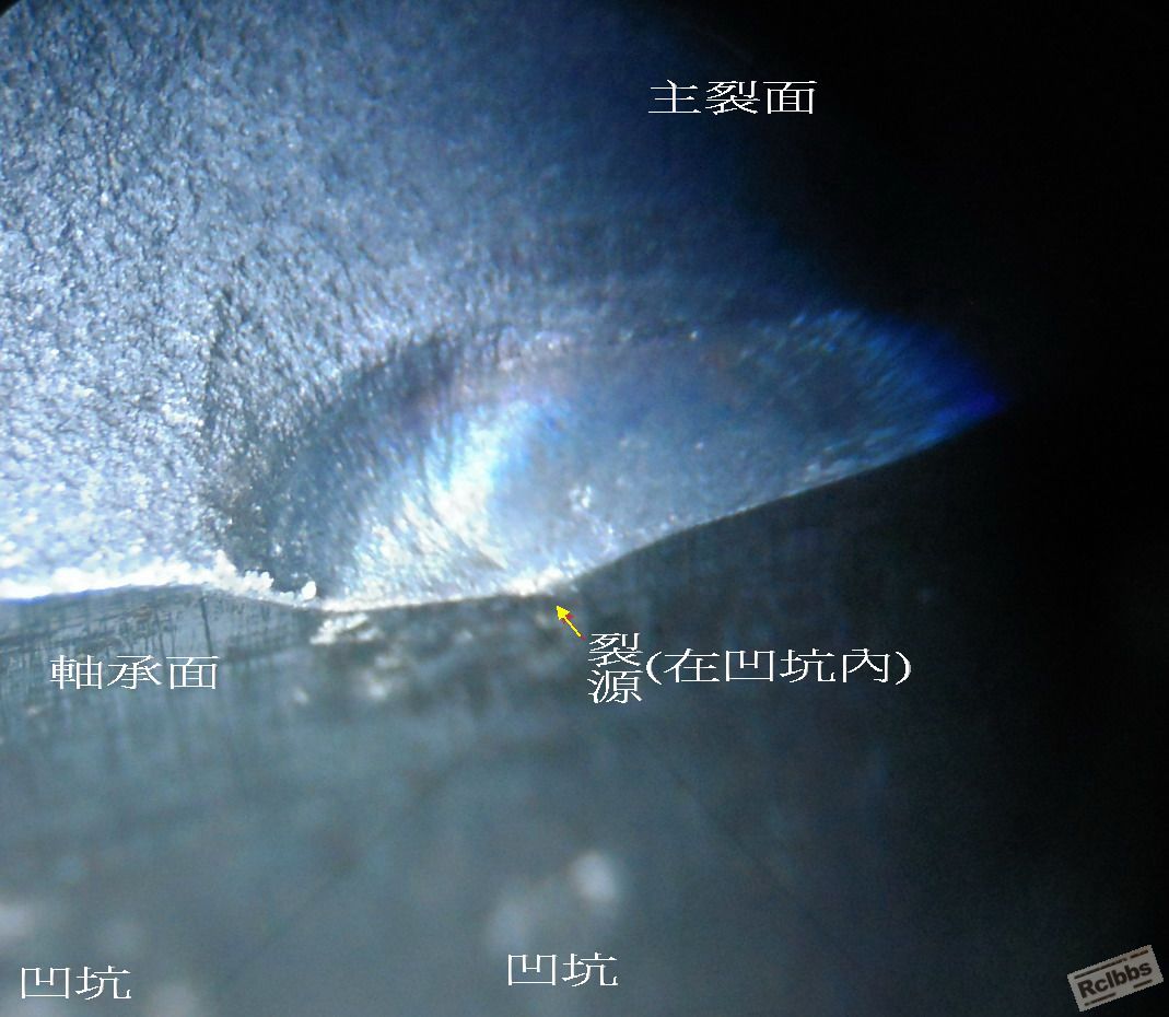

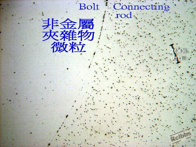

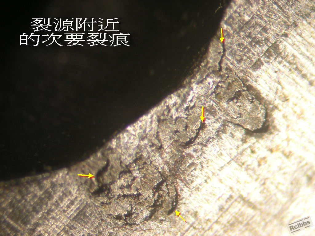

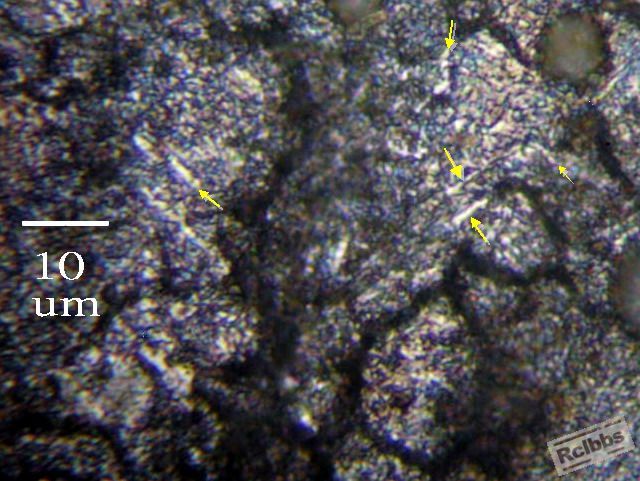

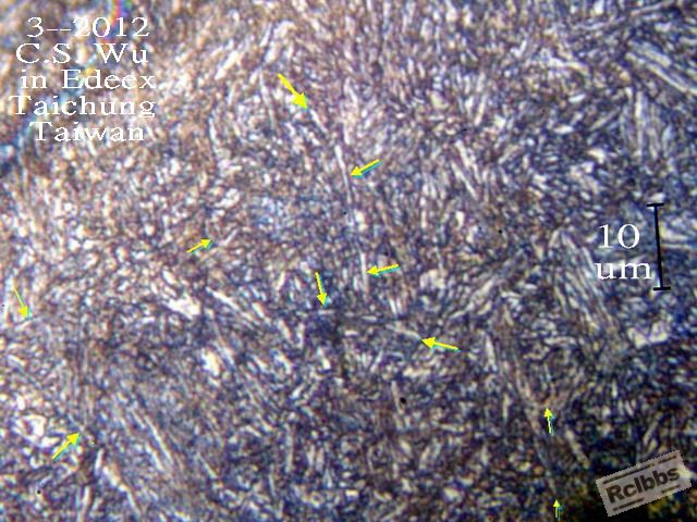

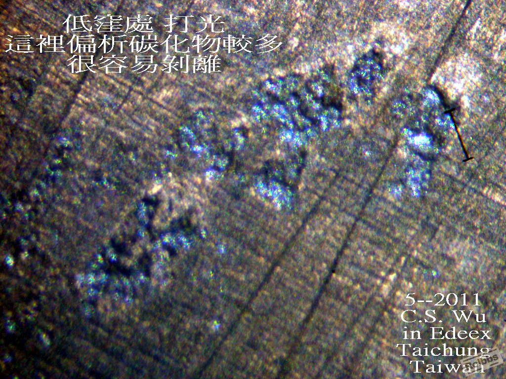

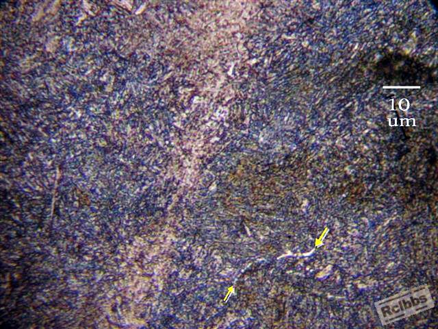

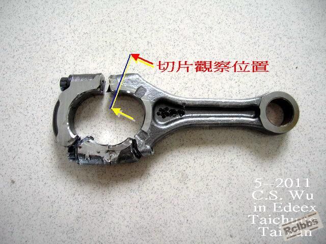

偏析碳化物 = crack initiation sites

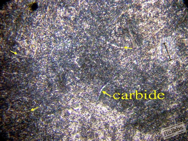

Fatigue fracture of a connecting rod for a car engine.
Too much carbide flakes in the matrix of Tempered Martensite. In the area having
high density of carbide flakes, microcrack is more likely to initiate.
Read the photos from the bottom up.

 楼主| 发表于 2012-1-22 15:02:21 | 显示全部楼层
Your questions will not be answered.

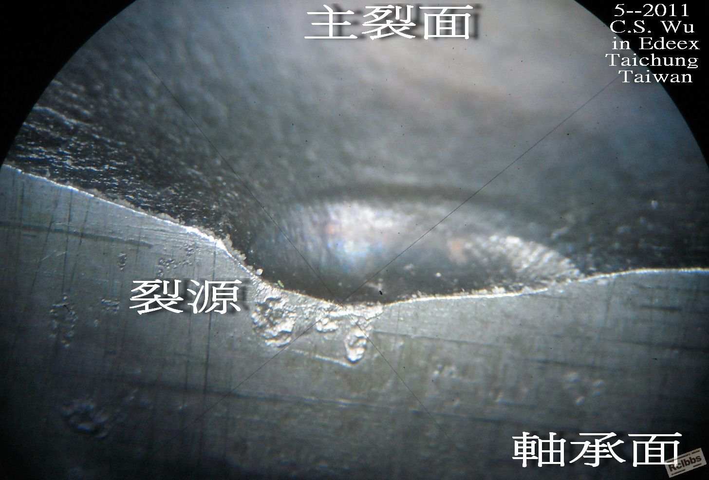

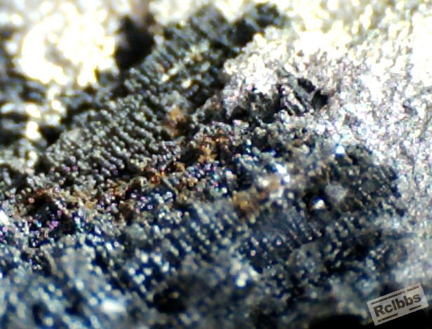

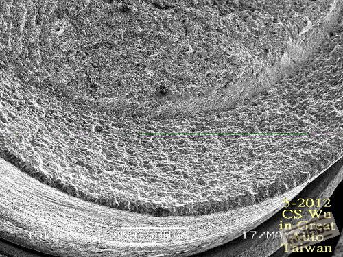

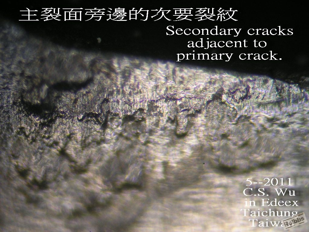

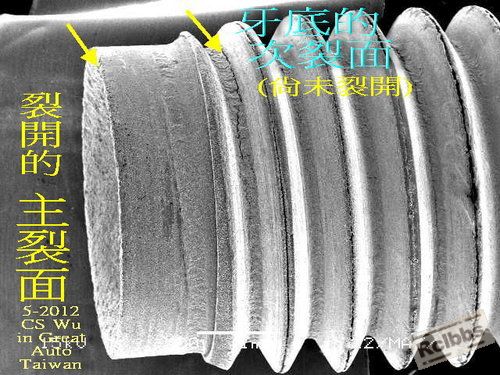

fracture surface of another connecting rod, but of the same lot as above.
参与人数 1热处理币 +10 贡献值 +10 收起 理由
gtn1314 + 10 + 10 感谢上传!

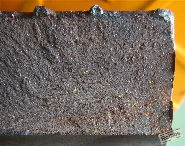

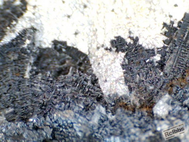

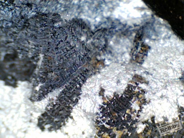

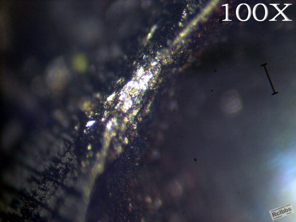

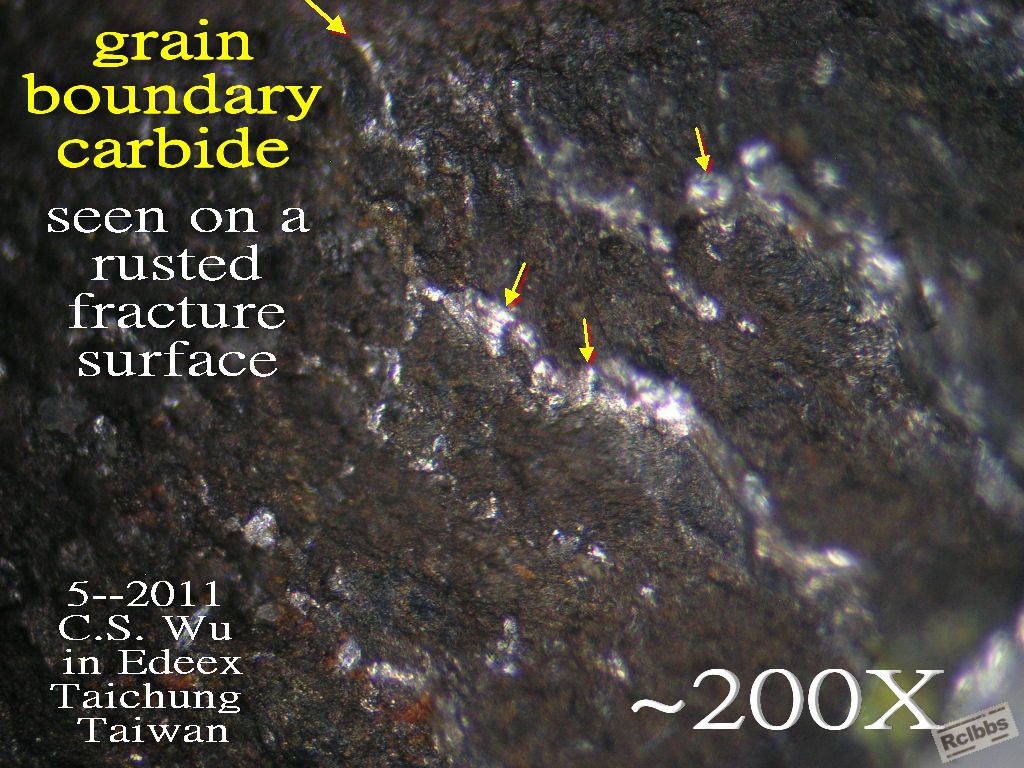

 楼主| 发表于 2012-3-28 21:59:34 | 显示全部楼层

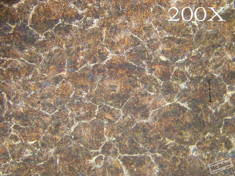

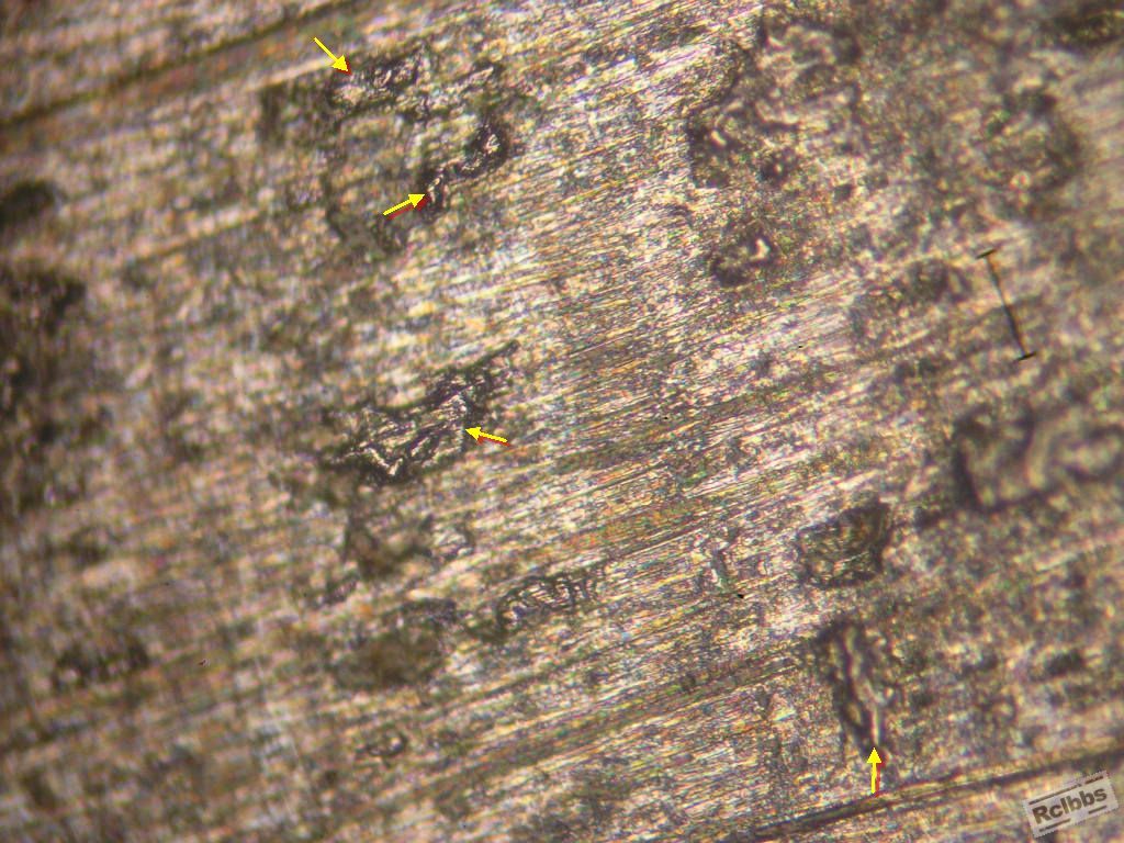

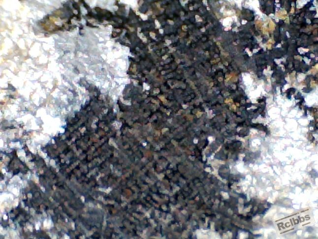

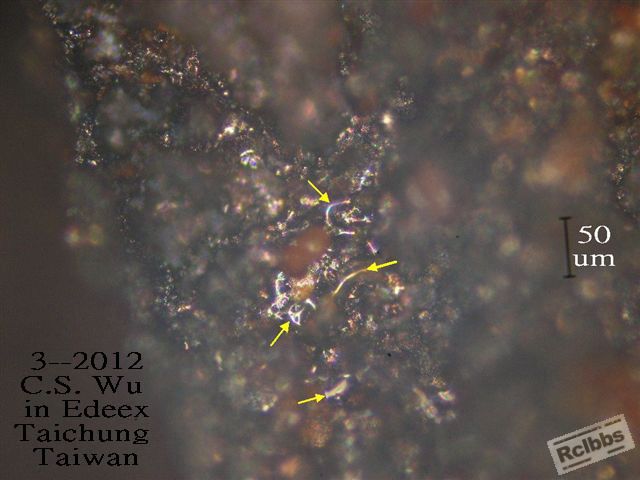

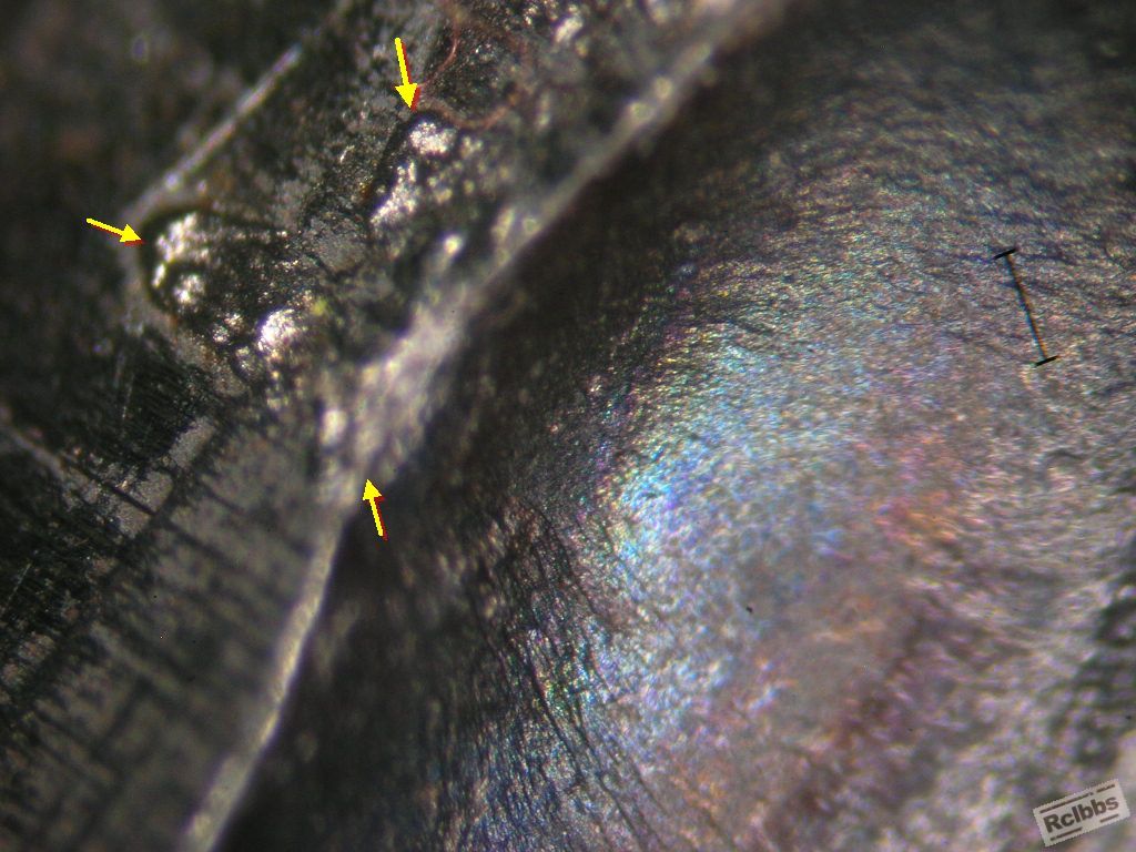

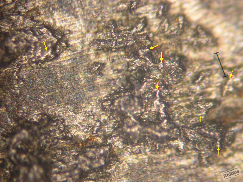

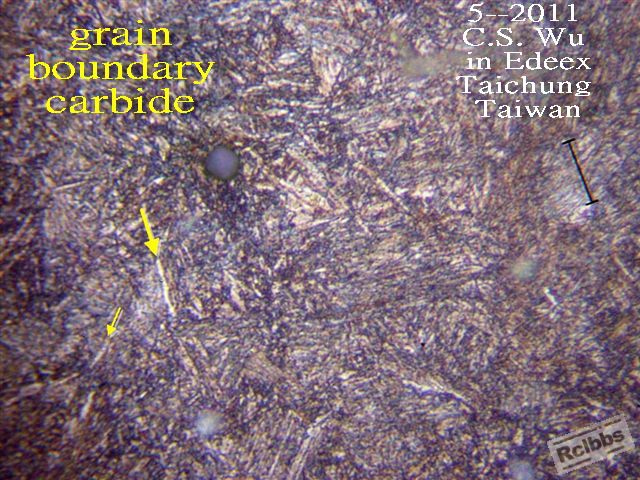

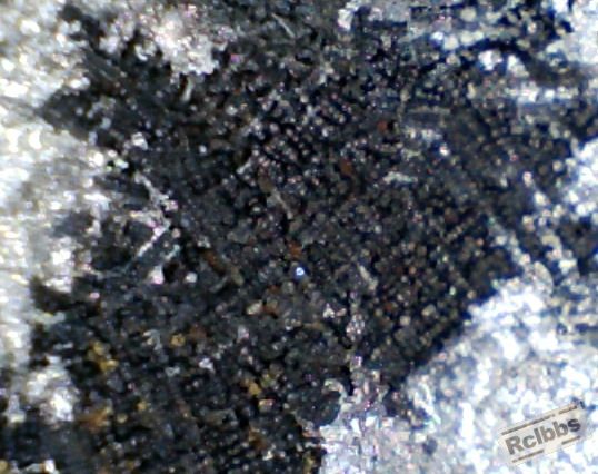

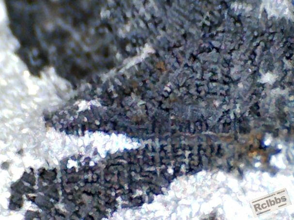

Grain boundary carbide---the toughness killer.

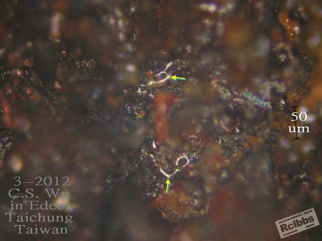

Fracture Surface of an SNCM 439. Steel made by a Korea steel mill.
Photo 1130~1132 were taken from a severely rusted dark fracture surface, using
dark field illumination. Those that glitter are carbide flakes
because they do not rust and they reflect light well. Carbide flakes,
or carbide blades are crack initiation sites.
Any Q/T steel with GB carbide like this lurking in the matrix, cracking is always waiting to happen--for sure.

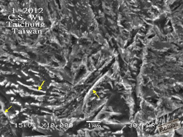

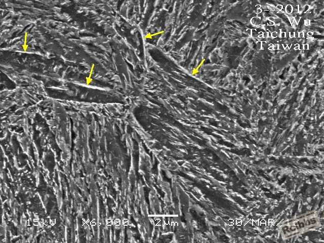

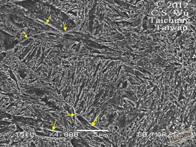

 楼主| 发表于 2012-4-4 15:28:12 | 显示全部楼层
Advanced engineers should know this.

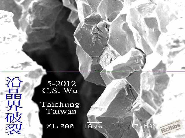

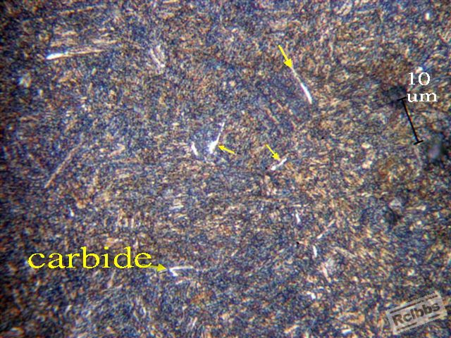

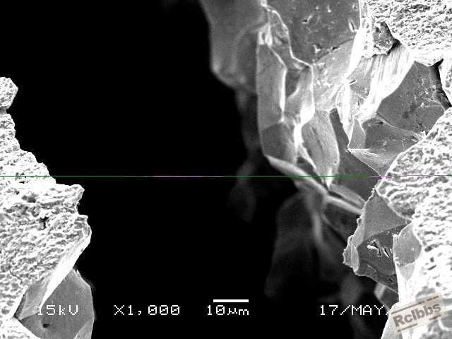

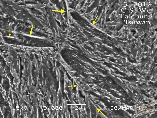

SEM photos for this specimen, showing carbide "blade" (film) at larger magnification.
Carbide blades in the U.B. matrix is always the culprit for  premature failures.
They are stress raisers and therefore----crack initiation sites.Most of the times,
they are so minicule and can only be seen under SEM, but their adverse effect still exist.

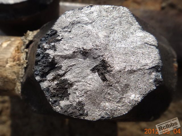

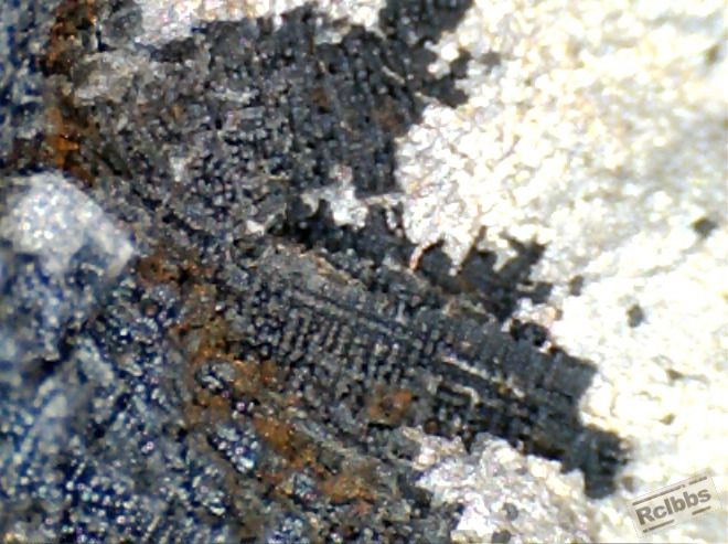

 楼主| 发表于 2012-5-5 18:16:12 | 显示全部楼层

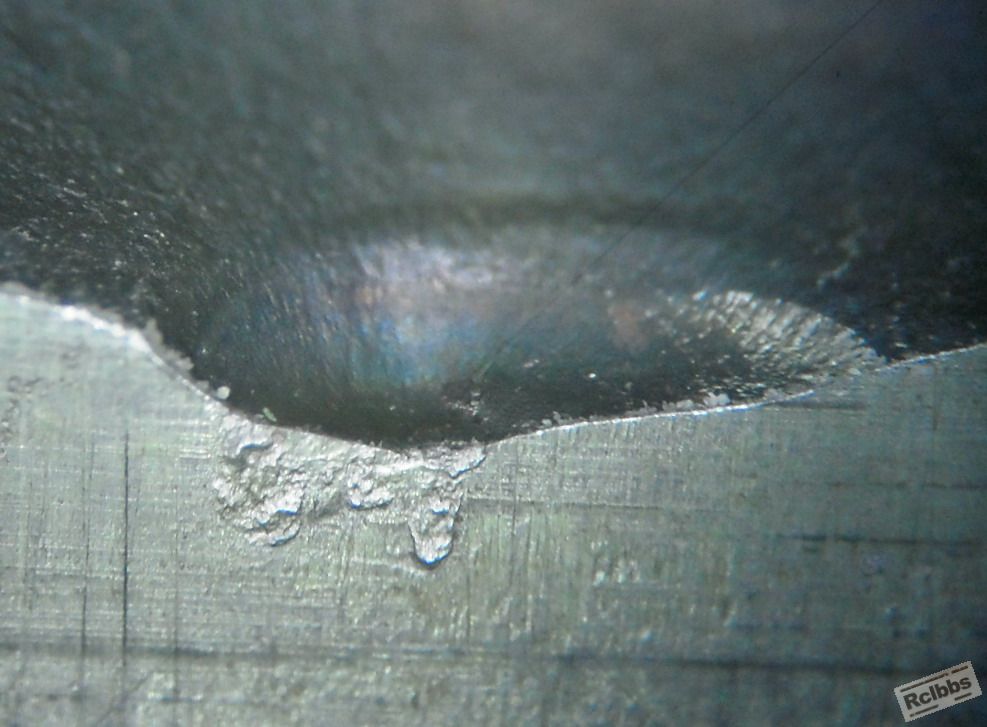

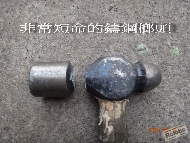

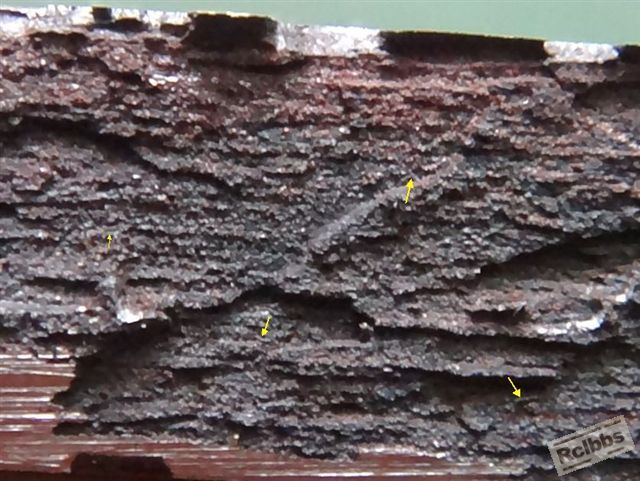

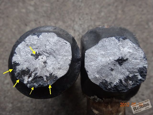

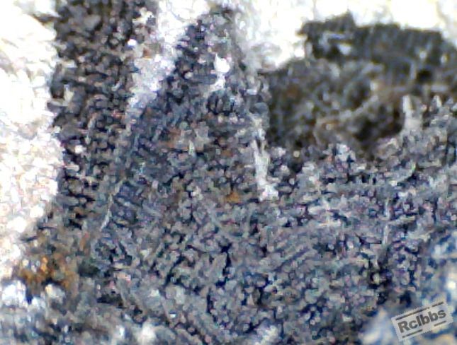

Cast hammer made in China.
不知何方天才(Mr. Smart),做這種鑄鋼的榔頭. 鑄鉄廠敲澆流道, 敲沒十下就斷了.
箭頭所指為縮鬆處.毛細管效應, 吸入油漆.
*: 後來看了金相,不是鑄鋼 是白鑄鐵.
gtn1314 + 10 感谢上传!

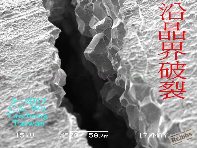

有没有做一下SEM的电子探针扫描. 如果有Cl离子等物质, 可能真是腐蚀.
有一张照片可以看到晶粒的特征, 但也可能是沿晶腐蚀.
所以这个还真不好判定

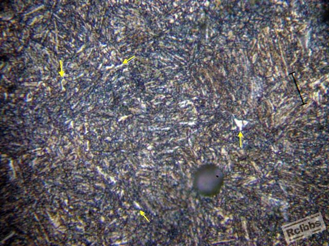

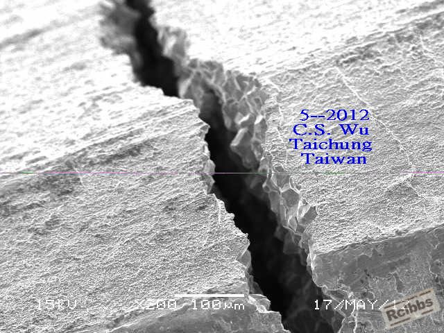

 楼主| 发表于 2012-5-19 19:23:22 | 显示全部楼层

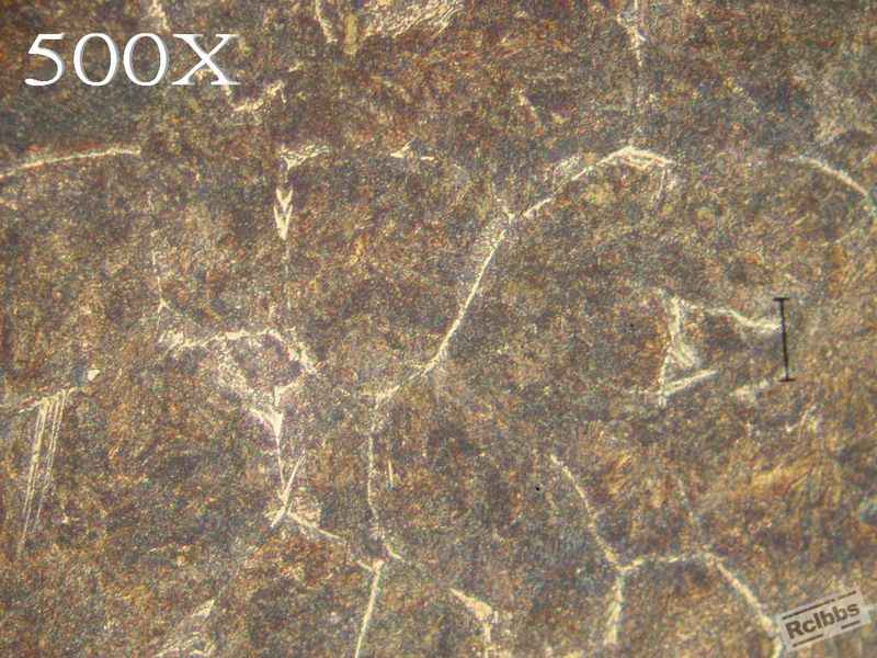

Wrong initial microstructure

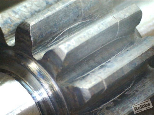

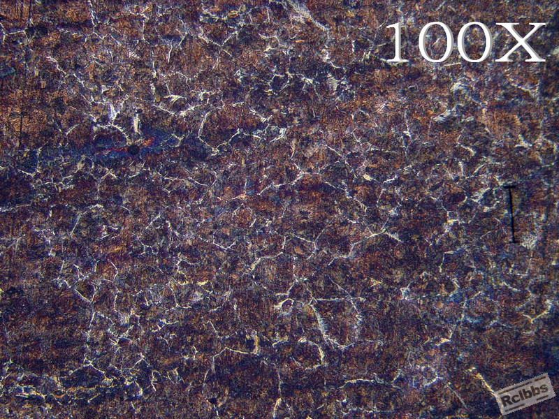

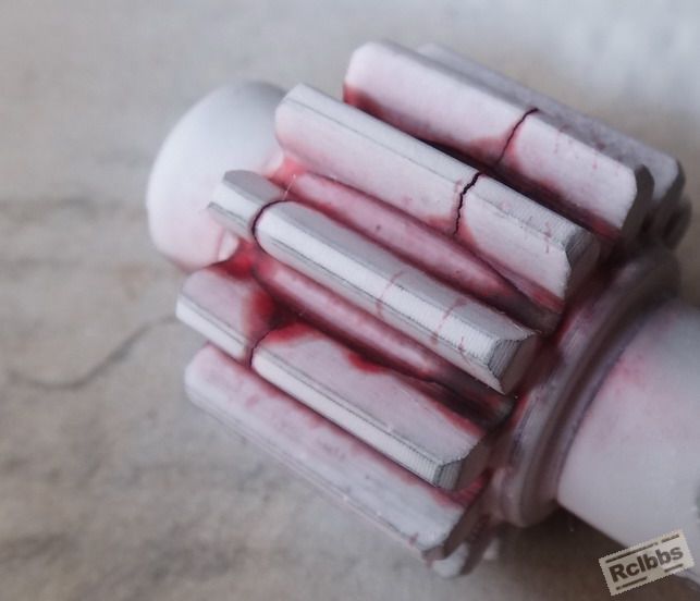

Material: S45C; gear O.D.: 50mm.
Cracks are found a couple of days after this induction-hardened gear was accepted by QC.
Microstructure inspection of the gear was conducted to find the cause of the cracking.
Network of Ferrite is definitely improper initial microstructure for induction hardening.
You should know why if you are good in metallurgy.

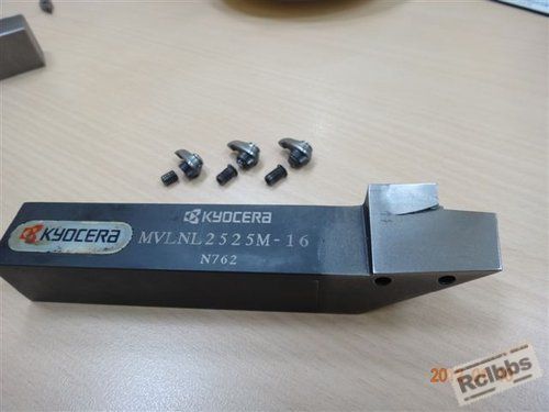

Japanese brand, but made in China.

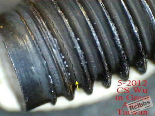

非常不耐用的車刀把與它的鎖固螺絲 M5

你好!
这个图应该是属于腐蚀缺陷引起的小孔.  有晶界腐蚀的特征, 典型的泥状花样特征.
仅供参考!

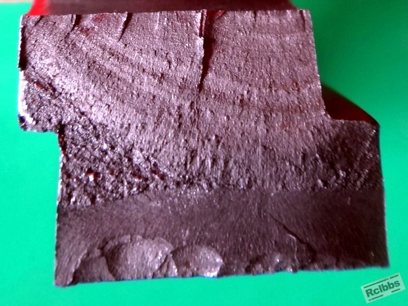

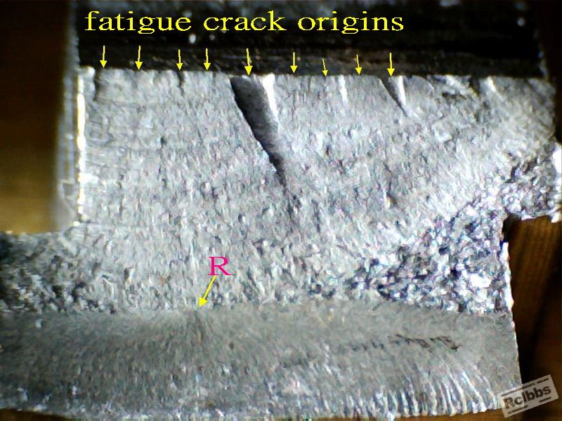

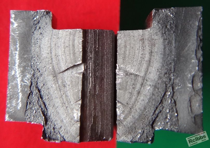

 楼主| 发表于 2012-6-10 18:50:35 | 显示全部楼层
Photo sharing only. No discussion here
leomet 发表于 2012-5-29 12:54
I quoted 6000 RMB for the failure analysis for 1 workpiece. But my customer submitted 4 pieces of failed parts,and asked me to analyze all 4 of them. In the end, they paid 24000 RMB happily because they got the root cause of the failure and knew how to avoid it from happening again. I am happy too, because I earned a big sum of "pocket money". This passage is meant to inspire young engineers to work hard. One of these days, you will be able to give consultant service to the metal industry.
I share my photos only---

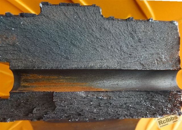

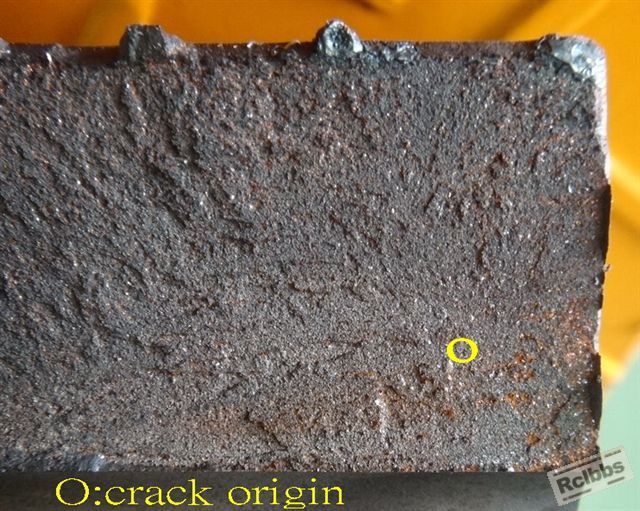

NO INSTRUCTION WILL BE GIVEN TO ANYBODY here.

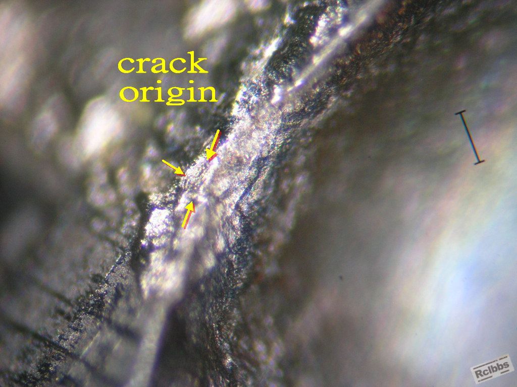

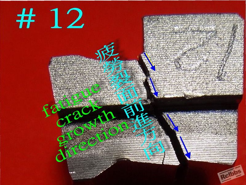

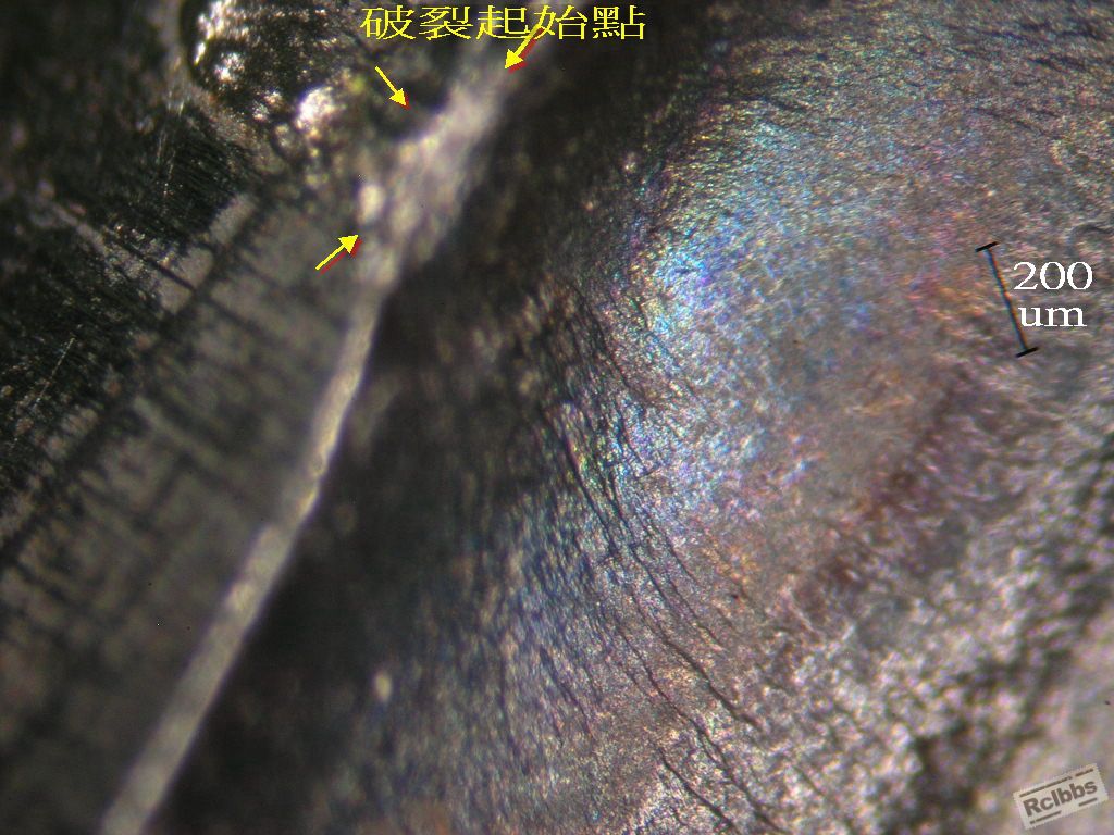

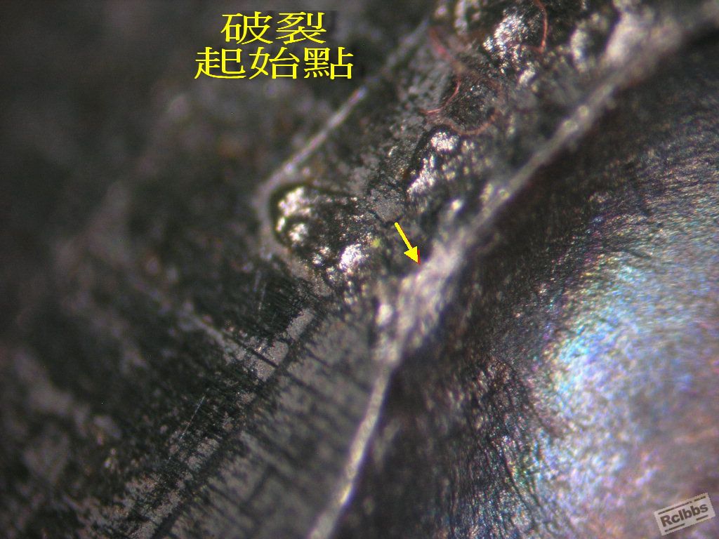

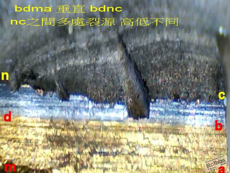

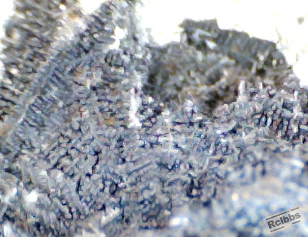

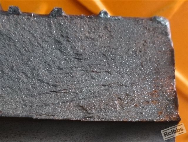

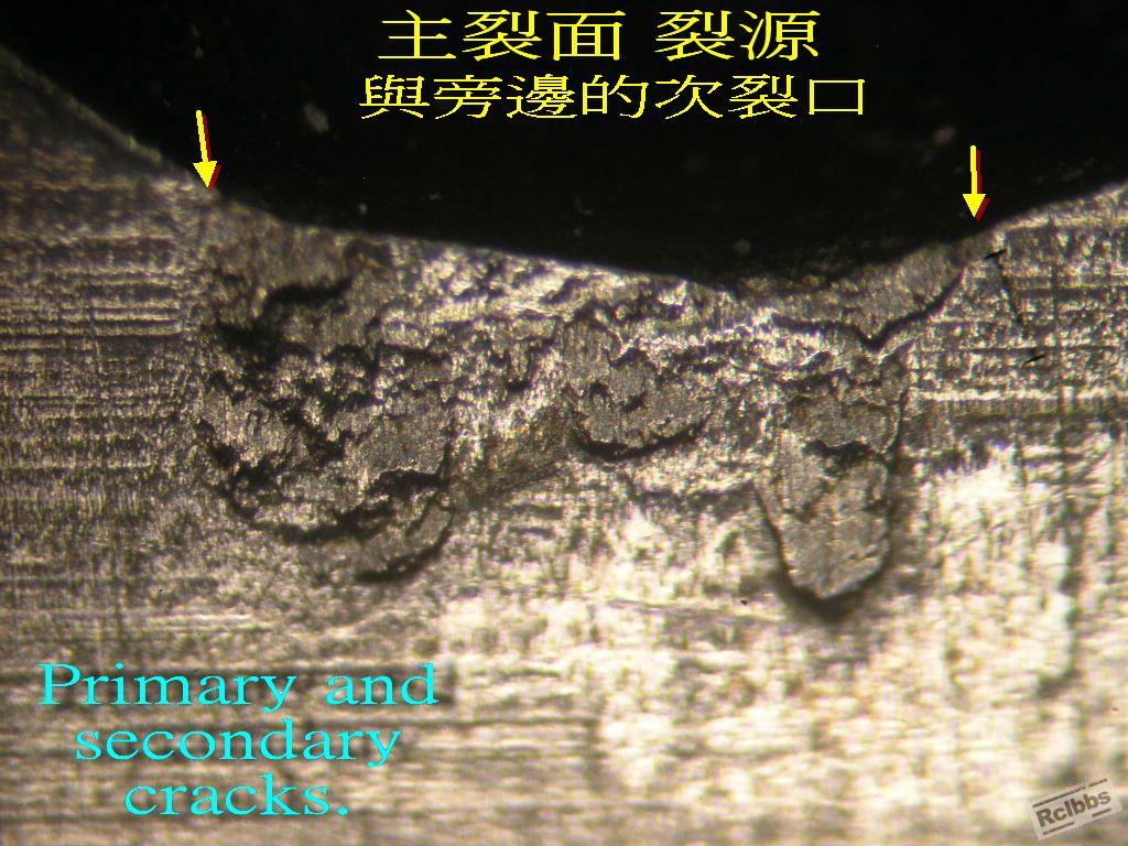

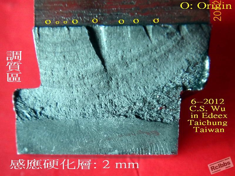

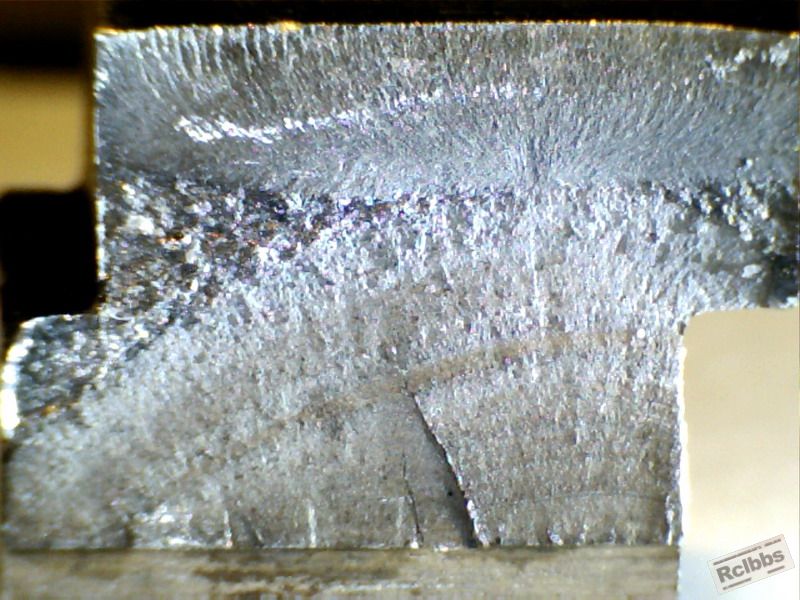

Multi-origin fatigue fracture surface.
Crack originated from broaching marks at a fillet.
cross section : 18 x 12
