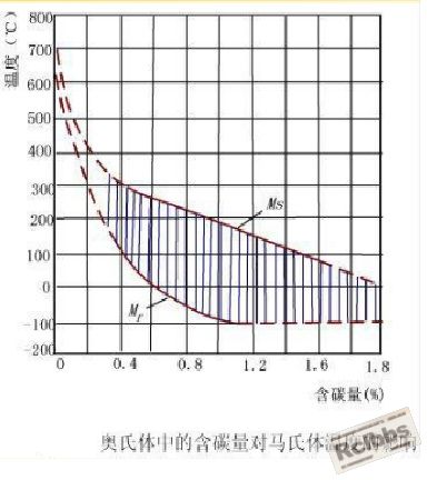

18Cr2Ni4W属马氏体钢,850℃加热后在280℃等温,数分钟后水冷,含碳量>0.3%的区域形成M,而近于0.3%的区域MS点高形成回火马氏体,试样浸蚀形成白色区域和黑区的界线。
请问含碳量在0.3%的钢的Ms温度是多少呢?有木有钢中Ms点和含碳量的关系图?谢谢大婶们!!!!!!!

按原文,0.3的Ms为280度
1.Ms(oF) = 930 - 570C - 60Mn - 50Cr - 30Ni - 20Si - 20Mo - 20W [Ref 1]
2.Ms(oF) = 925 x (1-0.620C)(1-0.092Mn)(1-0.033Si)(1-0.045Ni)(1-0.070Cr)(1-0.029Mo)(1-0.018W)(1+0.120Co) [Ref 2]
3.Ms(oF) = 930 - 600C - 60Mn - 50Cr - 30Ni - 20Si - 20Mo - 20W [Ref 3]
4.Ms(oF) = 1000 - 650C - 70Mn - 70Cr - 35Ni - 50Mo [Ref 4]
5.Ms(oF) = 930 - 540C - 60Mn - 40Cr - 30Ni - 20Si - 20Mo [Ref 5]
6.Ms(oC) = 561 - 474C - 33Mn - 17Cr - 17Ni - 21Mo [Ref 6]
7.Ms(oC) = 539 - 423C - 30.4Mn - 12.1Cr - 17.7Ni - 7.5Mo [Ref 7]
8.Ms(oC) = 512 - 453C - 16.9Ni + 15Cr - 9.5Mo 217(C)2 - 71.5(C)(Mn)-67.6(C)(Cr) [Ref 7]

发表于 2013-4-19 13:34:10 | 显示全部楼层
