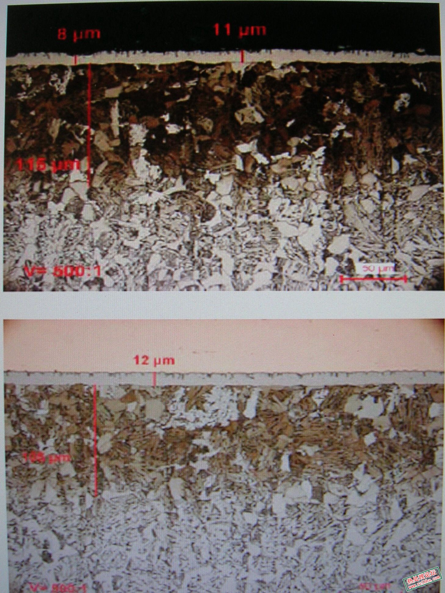

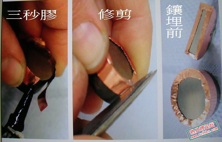

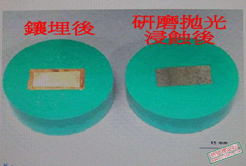

Look at these photos:
Quoted from Dr. Sommer. Germany.
