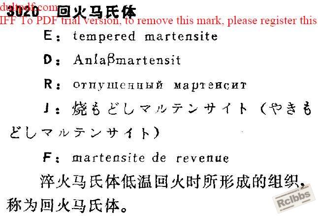

发表于 2009-7-26 17:04:03 | 显示全部楼层
回复 12# WJFU66 的帖子
Does your appendix picture obviously explain the 回火马氏体 is tempered martensite?
I think you have made a mistake for skimming.
But the question is how to say 回火索氏体 in english.I think the more reasonable explaination should be tempered sorbite.
many articles in metal heat treatment magazine also translate "回火索氏体" into tempered sorbite.
发表于 2009-7-26 17:36:58 | 显示全部楼层
回复 13# czwjn 的帖子
在这个链接中(http://www.rclbbs.com/redirect.p ... o=lastpost#lastpost),lian先生称:“在美国回火后组织统称tempered martensite﹔日本才有回火T﹑S之分”,这与9楼观点相同。
尚没有其他依据,对我上传的资料我也同时持怀疑态度。

发表于 2009-7-28 16:21:13 | 显示全部楼层
回复 20# bill_bush 的帖子
我在12楼引用的是《金属热处理1980第6期》的金属热处理名词术语汇编。
