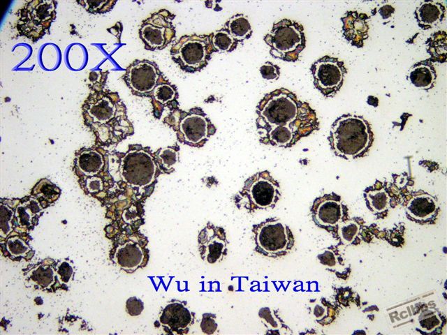

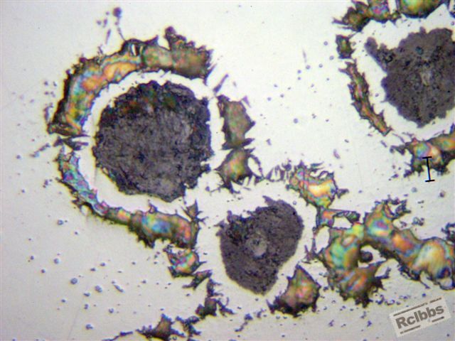

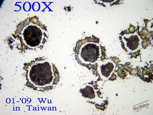

金相欣赏---QT
Induction hardened,
Back polished after etching.
签到天数: 30 天
发表于 2009-1-13 22:21:58 | 显示全部楼层
太漂亮了。台湾的金相照片现在都是彩色的吗?
制作过程复杂吗?如果很实用的话,真想学学!
发表于 2009-2-2 08:47:22 | 显示全部楼层
吴老师,腐蚀后抛光有什么特殊手法吗?怎么叫“black polished“,应该有巧妙的方法才能让石墨周围留下晕圈。
签到天数: 474 天
 楼主| 发表于 2009-2-2 09:04:37 | 显示全部楼层
回复 3# xcy721626 的帖子
Back polish : light polishing after etching.  halos 晕圈 are area with low C% Martensite and were etched deeper, so they are rougher and were not polished during back polish.
发表于 2009-2-2 20:12:48 | 显示全部楼层
Thanks for your kindly instruction. I have ever prepared more than thousands metallographic specimen of ductile iron for production examination, but never tried to light polish the etched sample even one time. What a pity!
You make me understood why interesting is so important to achievement.
