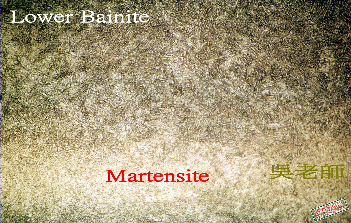

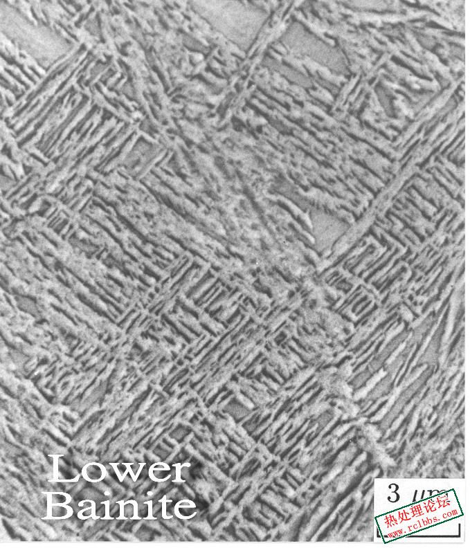

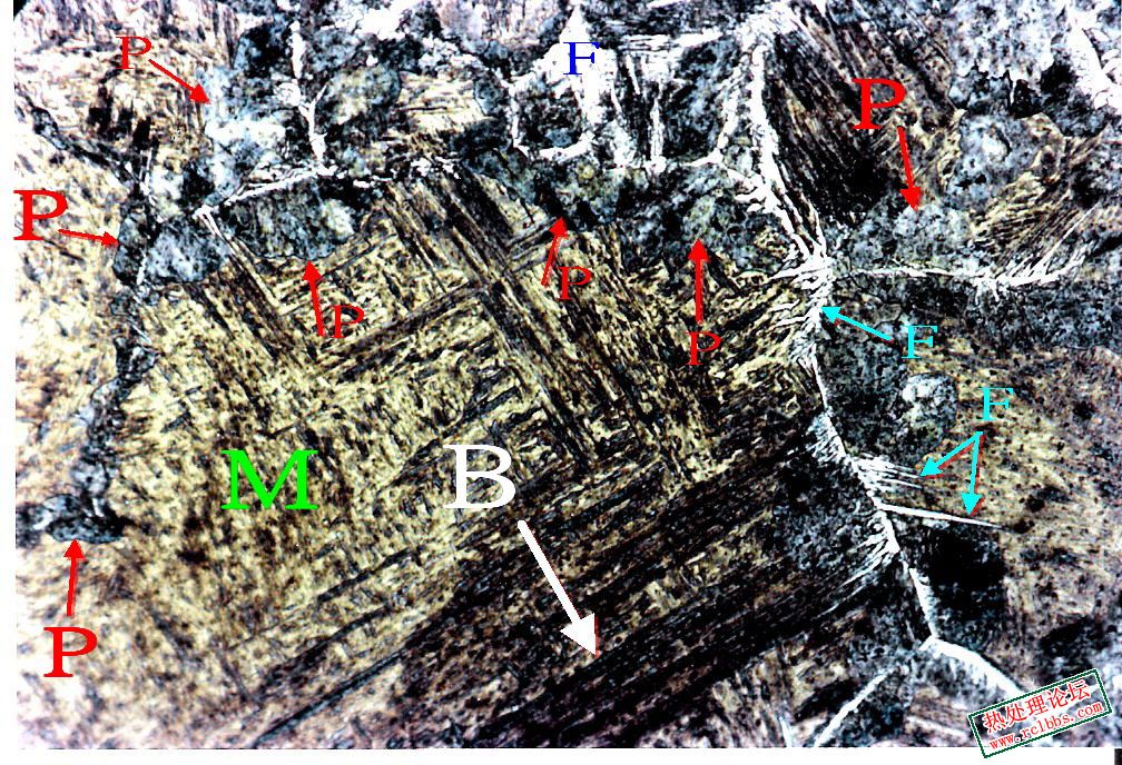

老头子我 born 1951 , 教育界逃兵, 台湾中部 冶金顾问 , 中文输入很慢, 然後又需转换成简体, 远比英文输入慢. 请原谅用英文.
這几張相片 给你们参考
Photo CCT 2 was taken in 1984. A 24-yr-old photo, probably older than some of you readers.
Photo 2344_B52: B=100X  2344 ~ H13, ~ SKD61.  Specimen was quenched from 1020C into 220 C saltbath.
So it's got a bit of Martensite besides Lower Bainite.
SEM is quoted from the Web.
* A single picture worthes a thousand words.
