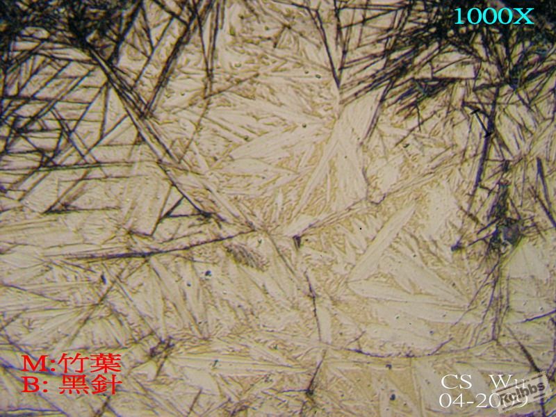

值得收藏: 800X600   More to come later.
It is my hope to leave behind me, after departing,
some footprints on the sands of time. (雪泥鴻爪)
So, decades later, people in this trade will talk----
once upon a time, there was
a Mr. CS Wu,  who did it so well
in the field of metallogrphy.

签到天数: 474 天
 楼主| 发表于 2009-4-17 09:03:05 | 显示全部楼层
回复 2# wty728 的帖子
一時手癢, 吳老師改英文造句.
You are such an expert in  ~.  Your photos along with their explanations are so clear !
I admire you!
An expert I must be. With an M.S. degree in metallurgy
and 20+  years of hands-on experience in metal industries,
it is difficult not to be an expert, Any objection ?
Note: Reading English is my life-long practice.
I am 59 and I fell in love with English at 19.
I Hope this will inspire you. Work hard and it will pay off years later.
[ 本帖最后由 leomet 于 2009-5-22 08:00 编辑 ]

签到天数: 474 天
 楼主| 发表于 2009-4-18 08:33:49 | 显示全部楼层
回复 1# leomet 的帖子
昨天照的   1020C x 1 hr. --->  故意让A晶粒粗大化
淬 180C 鹽浴 x 30 min (?), .  180 恆溫 生黑針下B.
相變未完成, 取出空冷, 殘A中生竹葉 M
白色基地中有許多看不出來的白M
希望我的同儕们,  把能傳諸後世的圖片,
寫下日期, 代名, 能像我使用 800 X 600上傳,  至少把螢幕填滿 好欣賞.
許多我想收藏的相片都只有 400X300,  有奌小器.
[ 本帖最后由 leomet 于 2009-4-23 09:17 编辑 ]

 楼主| 发表于 2009-4-23 09:12:23 | 显示全部楼层
回复 6# leomet 的帖子
200C 回火, 把白M 顯現出來.
基地暗下來後, 晶界碳化物也襯托出來了.
White martensite is as-quenched, untermpered martensite.
Think about how those gbk come into being.
[ 本帖最后由 leomet 于 2009-4-26 07:14 编辑 ]
