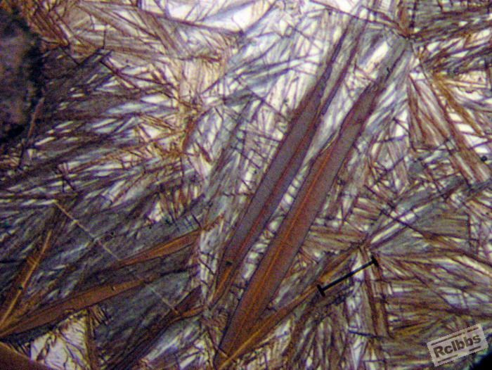

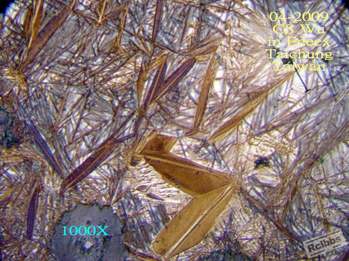

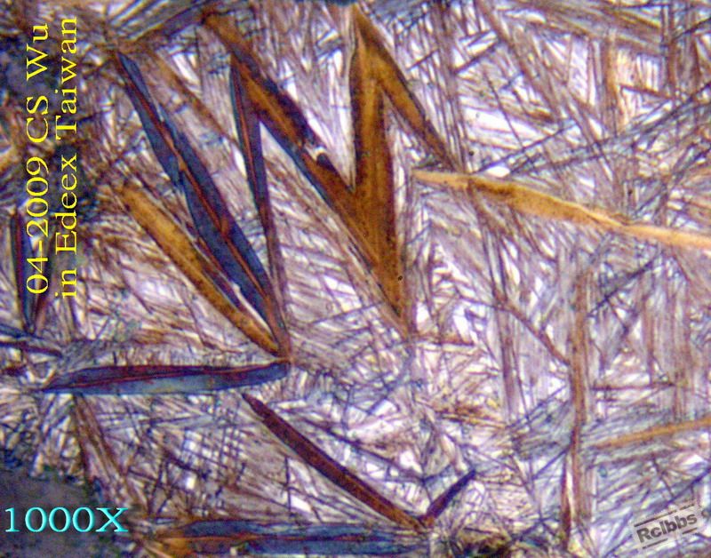

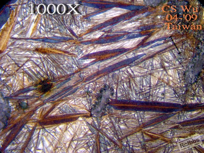

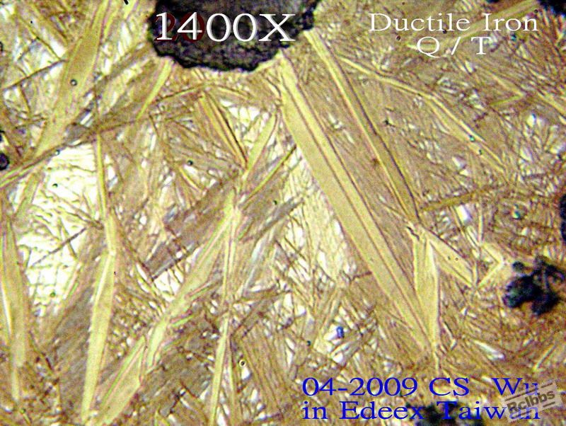

不太成功的彩蝕. They are for you to keep.
---- As hands-on metallurgist at work ,
I am probably the oldest in Taiwan.
故意高溫使Austenite粗大.
1020C淬於180C鹽浴30分鐘.
竹葉:M;  細針:下B.
[ 本帖最后由 leomet 于 2009-6-3 05:52 编辑 ]

there are obviously cracks generated at the middle of the M-needle. pretty typical and high-level.

         怎么不见石墨的踪迹?
     W
签到天数: 864 天
发表于 2009-4-27 21:04:16 | 显示全部楼层
回楼上:图上注放大倍数的都是石墨,x1400,x1000等地方,灰色的、球状的一部分,其他还有一些。
