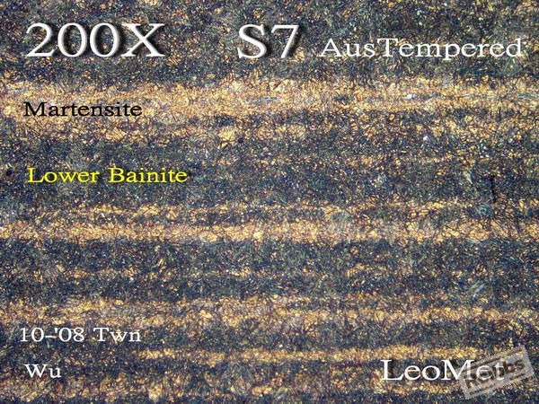

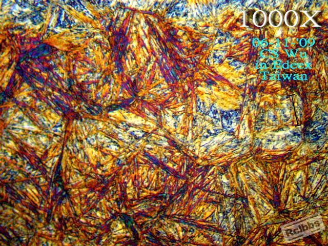

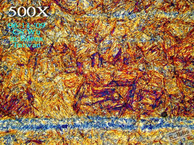

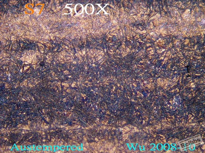

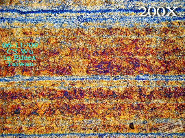

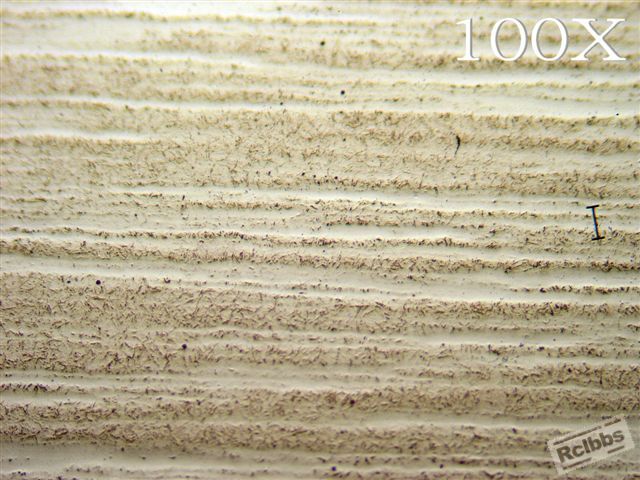

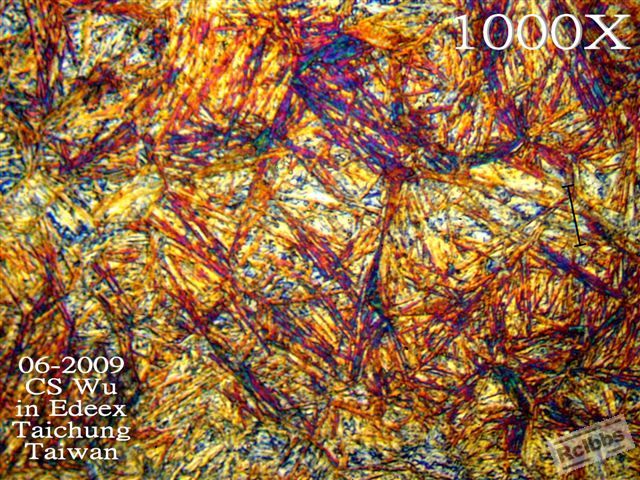

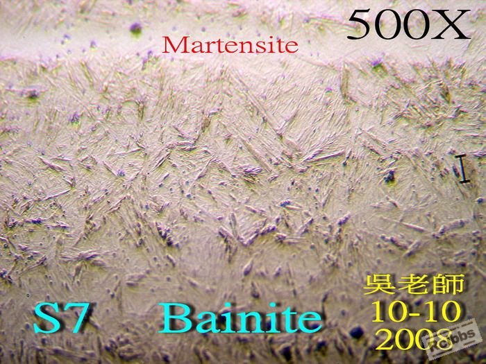

AISI S7. Shock resistant steel.
Quenched  from 1020C to a saltbath at 200 C .
Products obtained are  mostly lower bainite (darker in color)
          and a little martensite and traces of Austenite.

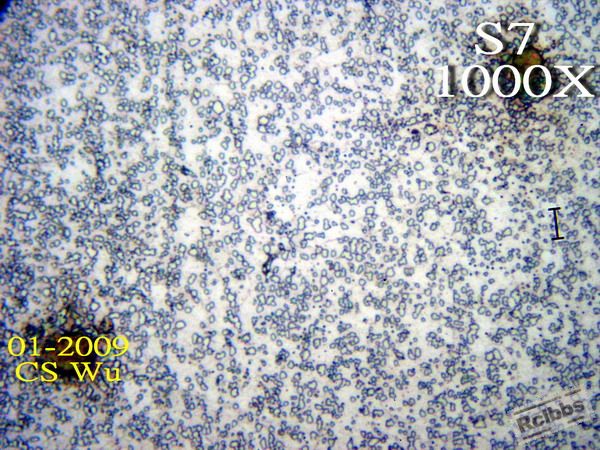

2782: raw material, Small carbide particles evenly dispersed in matrix of ferrite.
7623a : slightly polished after etching to show roughness difference between
bainite and martensite areas.

AISI S7.抗震钢?加热至1020C在200度盐浴中淬火
几乎是下B(颜色黑暗区)组成,还有少量的M和残A。
图2782:小颗粒碳化物分布在铁素体机体中。
图7623a :在腐蚀后实施了轻微的抛光,M和下B区浮凸出来

吴老师好,你做的下贝非常清晰,特征很明显;图片显示应该为低温回火状态;能否采用高温回火下样品,看看这样的下贝形态有什么变化?谢谢.

No time to dig out that specimen. But I can tell you that the HRC of L.B.
drops  much slowly than that of Martensite upon tempering.
Search Google using "tempering of Bainite" and you will find lots of info.

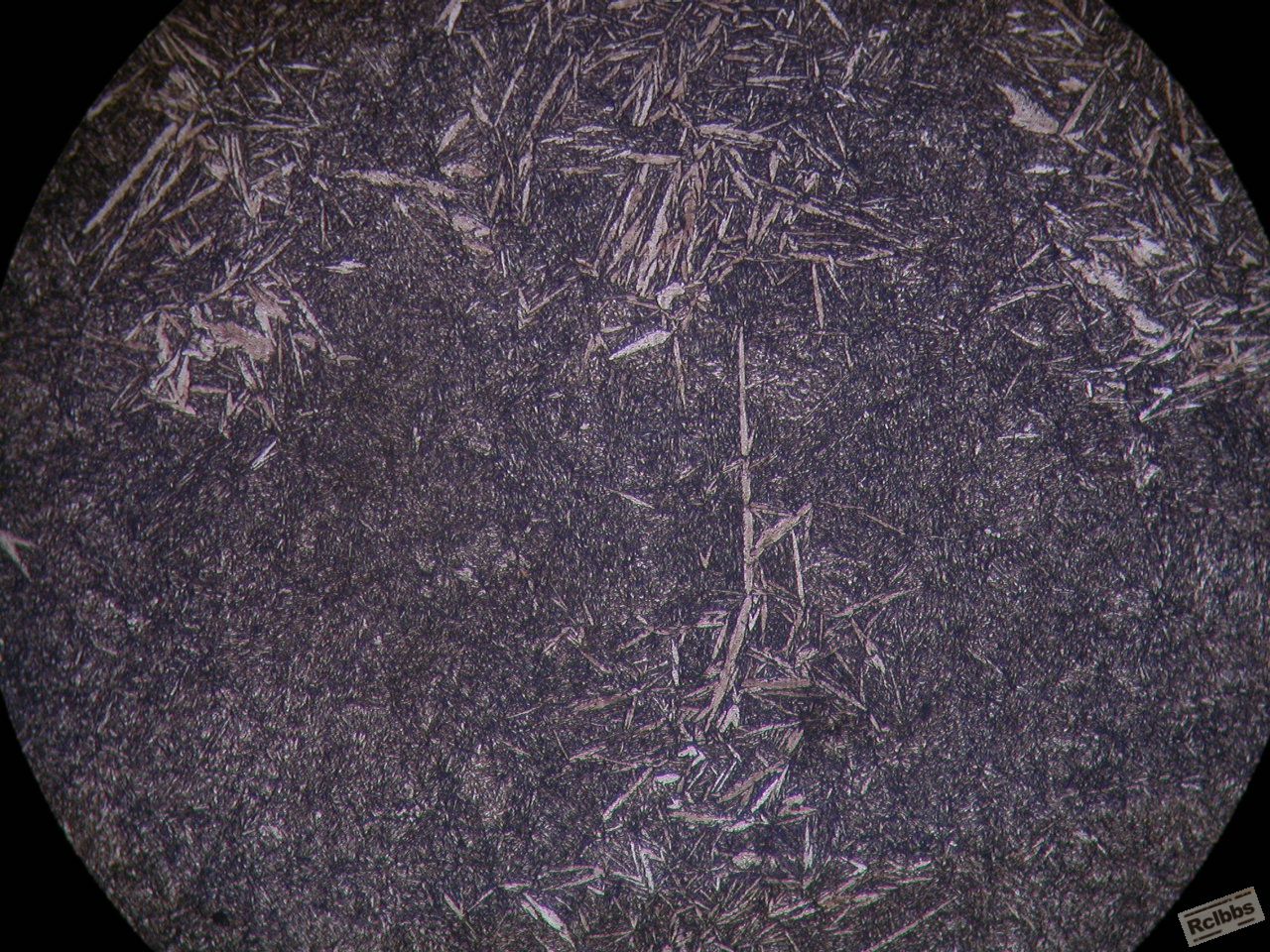

吴老师:我曾经使用H13料在淬火冷却过程种作360度左右做等温处理,高温回火后得到如下形态组织,是贝氏体吗?是上属于上贝还是下贝?烦请解惑.谢谢.

Upper Bainite, I'd say.

发表于 2011-5-15 09:59:57 | 显示全部楼层
回复 8# leomet
    终于搞清楚了,谢谢吴老师。
