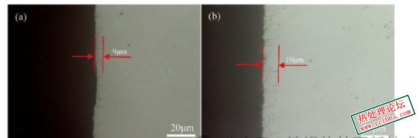

预氧化技术提高渗速的同时含降低了晶界氧化程度。
Reduced internal oxidation by a rapid carburizing technology enhanced by pre-oxidation for 18CrNiMo7-6 gear steel
Abstract
Pre-oxidation was adopted as a pretreatment prior to gas carburizing for 18CrNiMo7-6 steel, and its effect on the carburizing efficiency and internal oxidation was evaluated in this research. The results indicated that pre-oxidation could improve the carburizing efficiency and result in much thicker effective case depth than that without PO pretreatment under the same carburizing condition. Meanwhile, the thickness of internal oxidation layer decreases significantly by PO pretreatment. The enhanced carburizing efficiency and decreased internal oxidation tendency could be ascribed to the oxide layer formed on the surface and the higher surface free energy (SFE) by pre-oxidation (PO).
效果图
效果图
