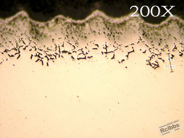

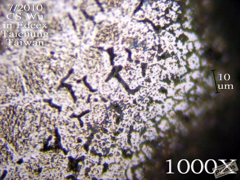

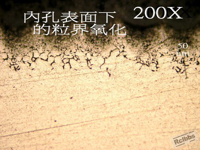

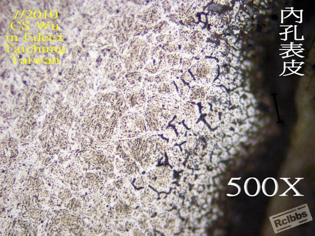

我很少接觸滲碳, 需請教這方面的專家们:
這個晶界氧化, 皮下~ 100 μm, 嚴重嗎?
材料: AISI 8620
参与人数 1热处理币 +10 贡献值 +10 收起 理由
孤鸿踏雪 + 10 + 10 感谢上传!
签到天数: 27 天
发表于 2010-7-22 21:54:44 | 显示全部楼层
这个应该算比较严重的吧,况且这么深
签到天数: 118 天
发表于 2010-7-23 01:05:52 | 显示全部楼层
See AGMA 923-B05, Table 2 as a guideline.  The allowable IGO (intergranular oxidation) depth is dependent on the specified case depth.  The highest allowed is 60μm for 3mm case depth.  Yours appears to be pretty bad, but it all depends on what case depth you're working to.
ISO 6336-5(2003), Table 5 also has similar requirement.
IGO is always checked in the as-polished condition
签到天数: 474 天
 楼主| 发表于 2010-7-23 09:17:12 | 显示全部楼层
回复 3# metart
    Thanks !  Buddy.
签到天数: 118 天

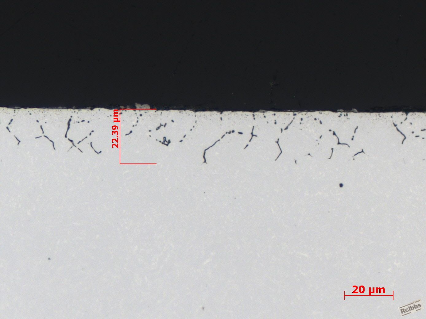

发表于 2010-7-23 21:31:58 | 显示全部楼层
Here's a typical IGO depth for a carburized AISI 4820 with 2.3-2.5 mm case depth.
发表于 2010-7-24 16:20:15 | 显示全部楼层
需要看渗碳层深度,如果深度在1mm以内,这样的晶间氧化肯定不合格。

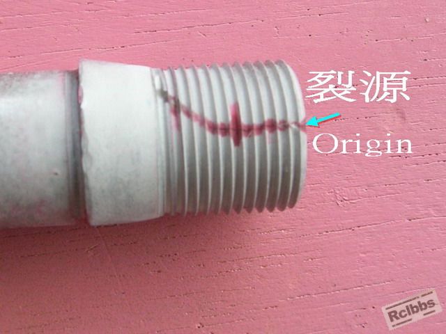

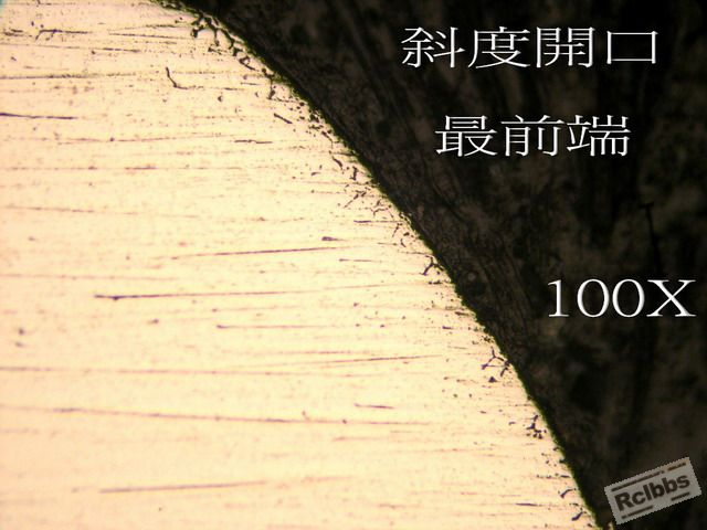

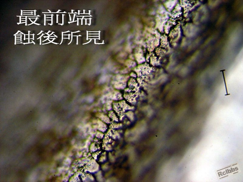

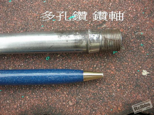

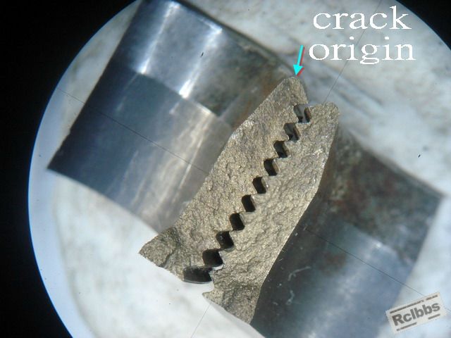

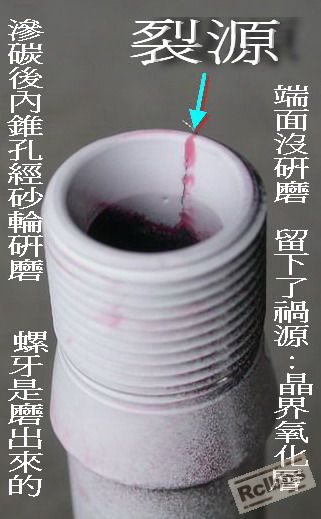

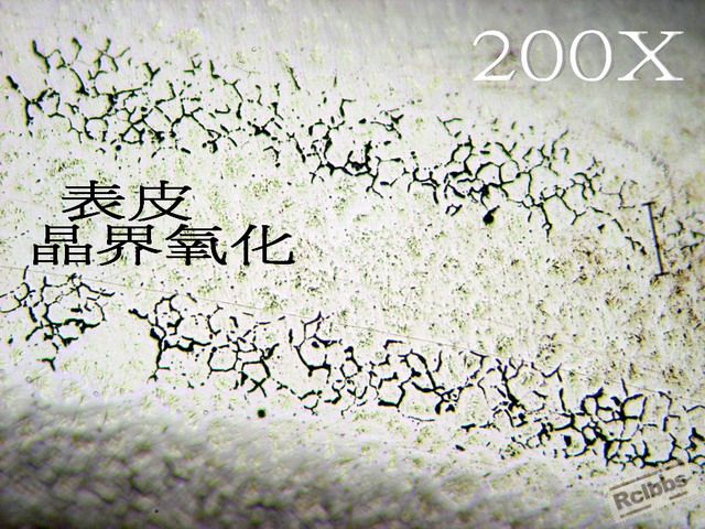

Cracking induced by  Intergranular Oxidation
photo ~717: observed directly on the end surface after it was polished, etched and lightly polished again.
Raw material is pretty good to my trained eyes. No any other defect was found except this grainboundary oxidation.

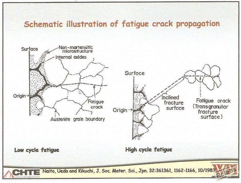

 楼主| 发表于 2010-7-25 16:18:03 | 显示全部楼层
回复 7# leomet
Repost from the Web:
