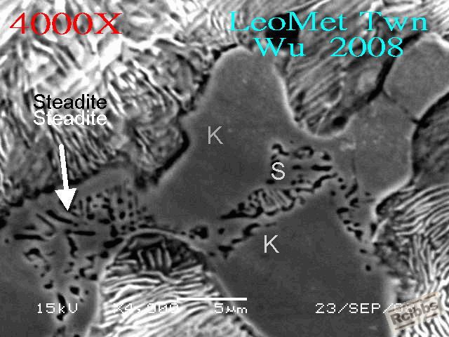

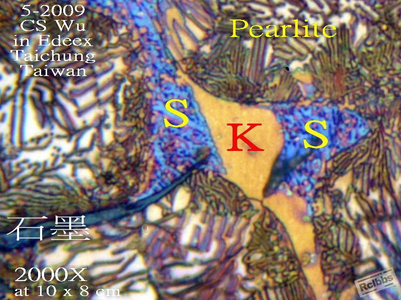

失效及缺陷组织照片 265, 266樓有照片可看.
K: carbide   S: Steadite.
Photo taken by C.S. Wu, a Taiwanese metallurgist.

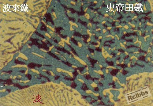

签到天数: 474 天
发表于 2010-11-5 17:57:02 | 显示全部楼层
回复 4# leomet
    ~ 3000x;  Photo quoted from: Color Metalography, by an Isaraeli metallurgist.
磷化鉄: 黑色  碳化鉄: 暗綠.  鉄:土黃.
