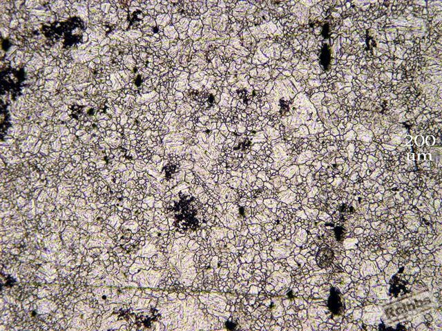

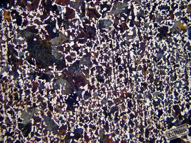

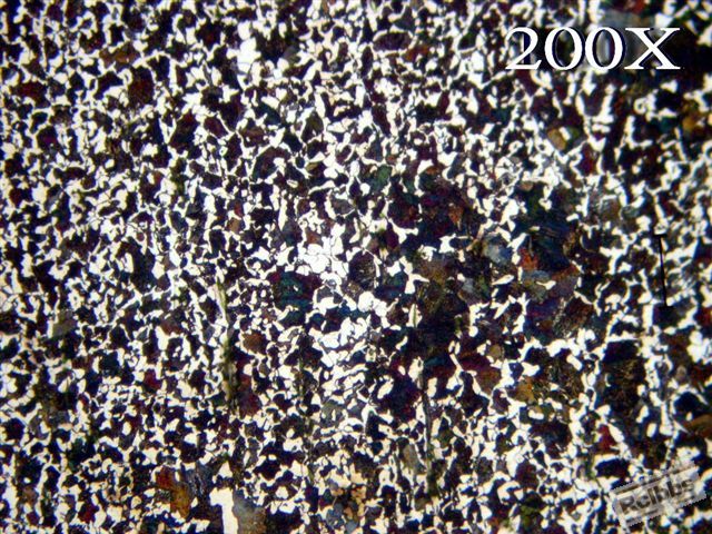

Mixed Grains 混晶

回复 19# leomet
SKD是什么东西呀?锻后的组织是什么啊?铁素体和什么?呵呵,偶是新手

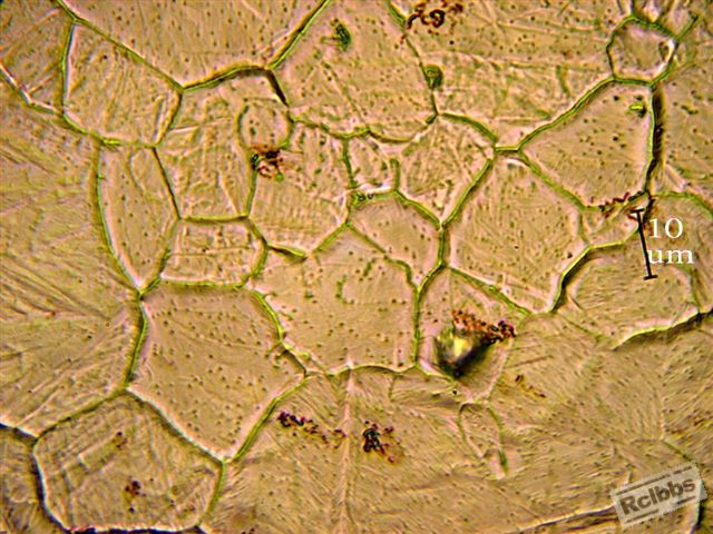

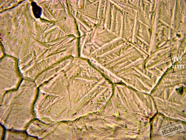

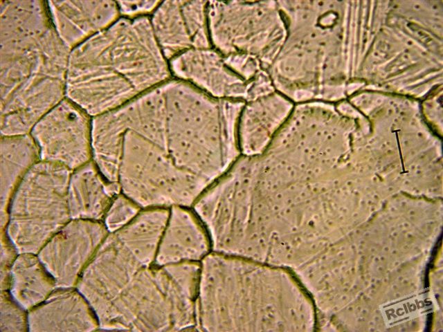

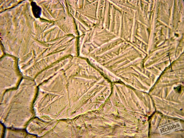

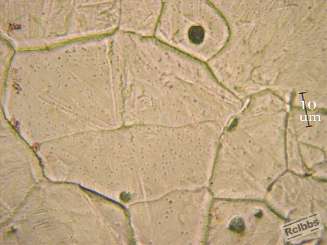

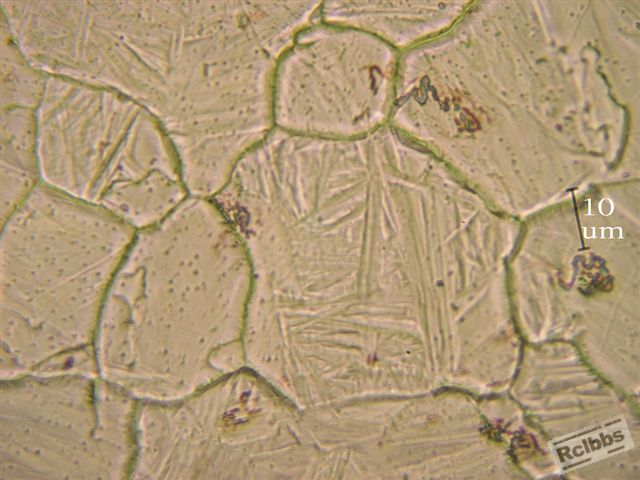

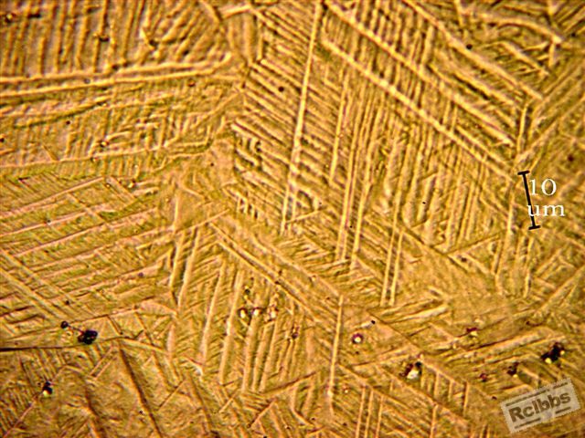

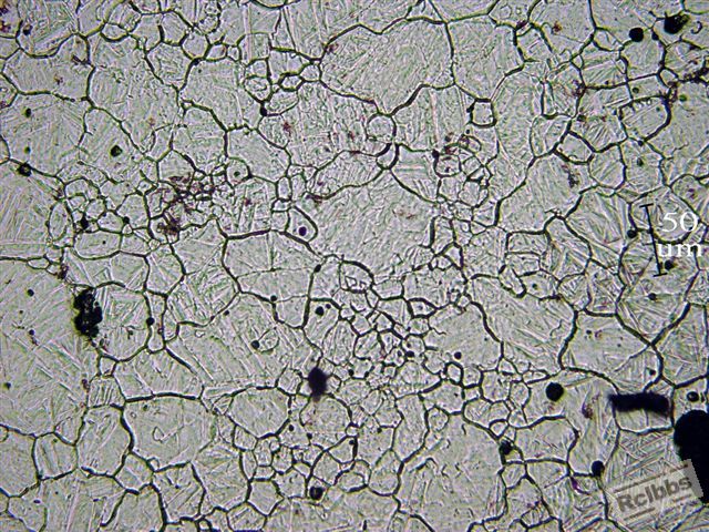

Show you something I have never done before.
SNCM 440 (?) specimen, polished, vacuum quenched from 1040 C, and observed the mirror surface after quenching. (not etched)
Shown below are Austenite grain boundaries and surface reliefs (浮凸) produced from phase transformation.
Note the subgrains in some larger grains. Subgrains should not be counted during determination of grain size.

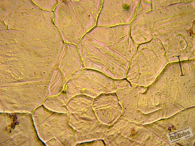

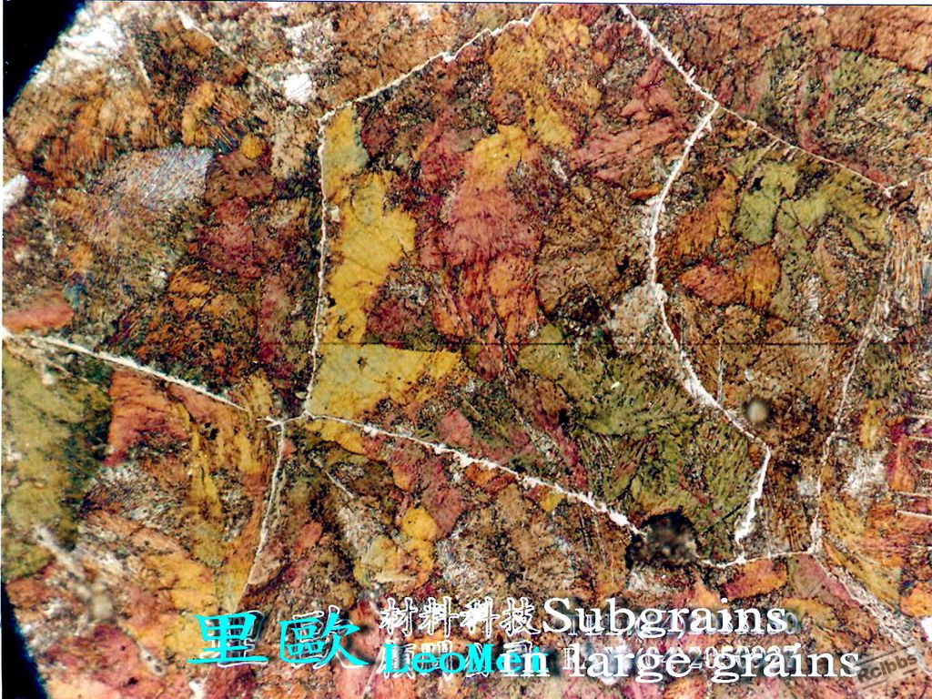

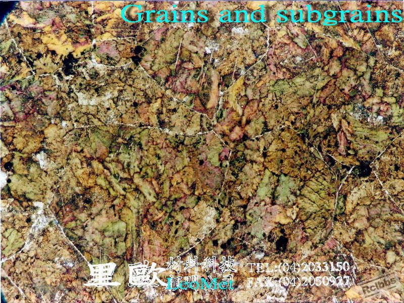

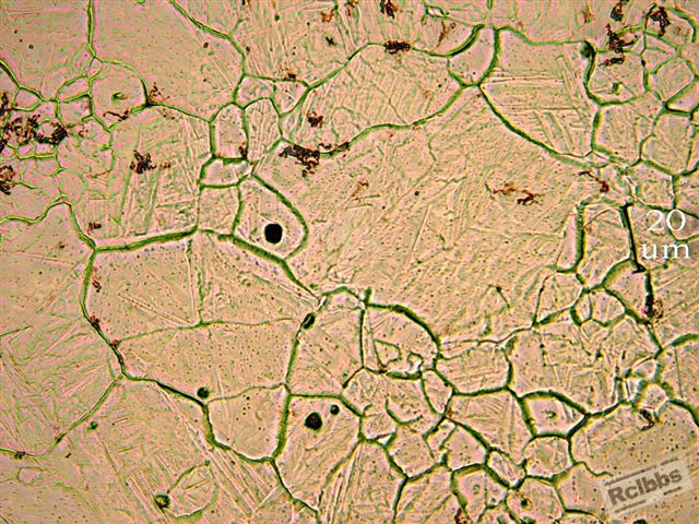

Grains and subgrains of a unknown steel specimen.
Photos were taken decades ago. That is why I do not remember the name of the steel.
Note the subgrains inside real grains out-lined by proeutectoid product.

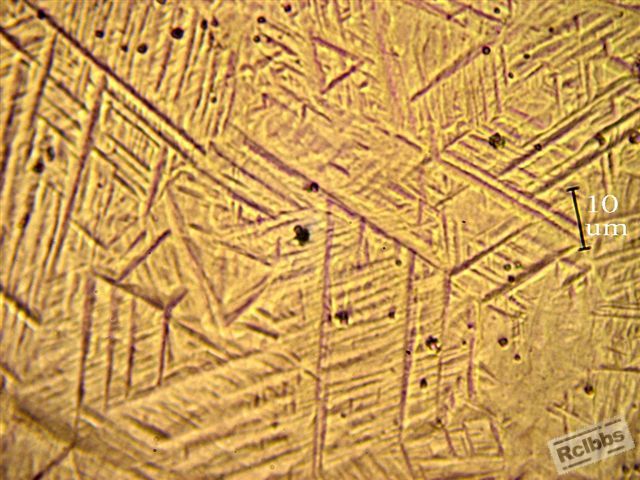

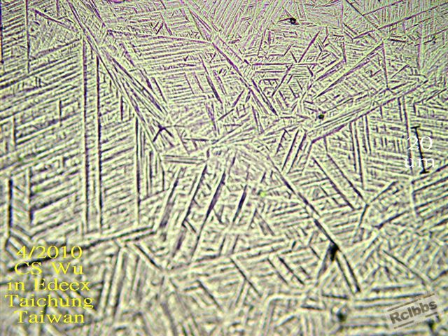

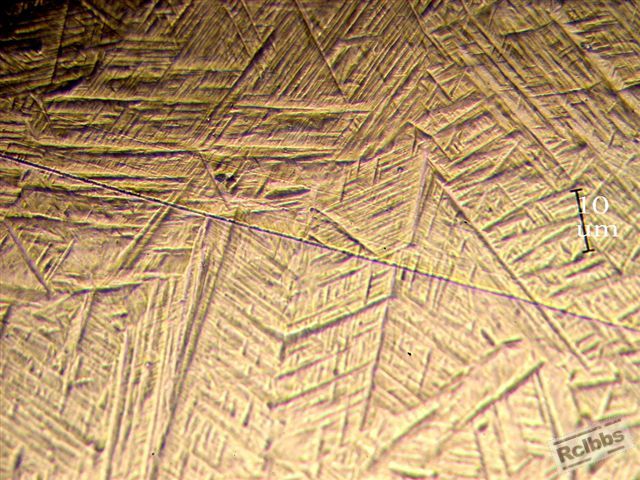

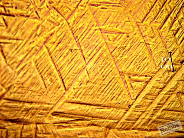

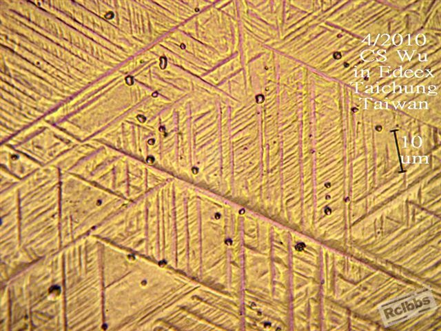

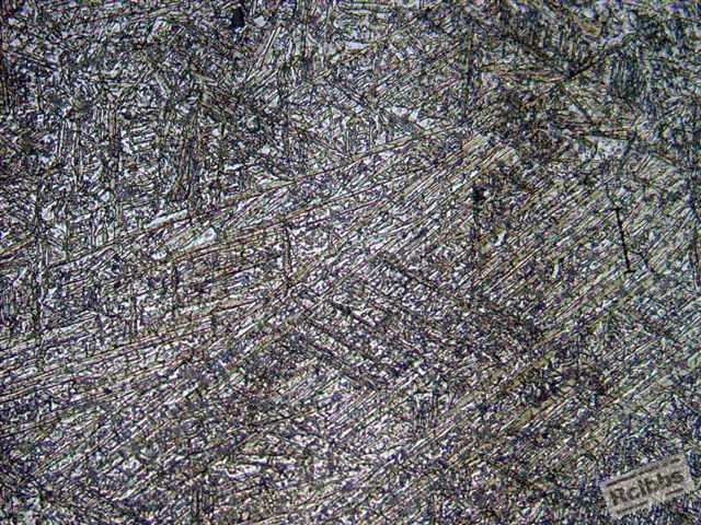

A unknown steel specimen (probably SCM 440?), polished, vacuum quenched from 1040 C, and observed under OM.
Shown below are surface reliefs produced from phase transformation.
Interesting pattern.

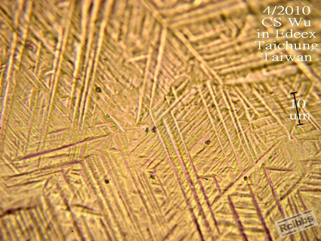

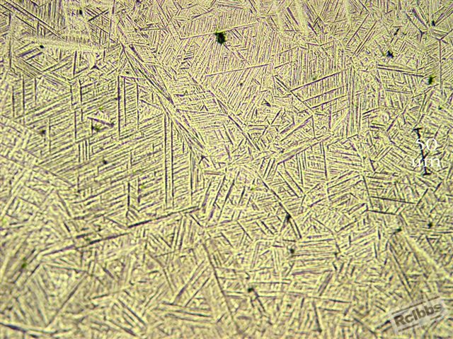

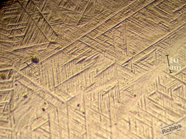

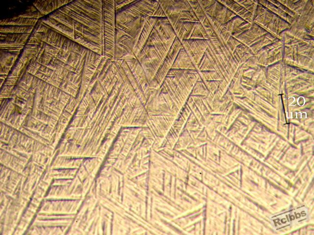

An unknown steel specimen , (SNCM 440 ?) polished to mirror-surface and quenched in a vacuum furnace from 1040 C.
Shown below are photos of surface relief related to phase transformation.

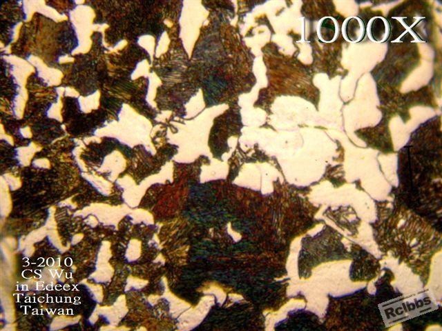

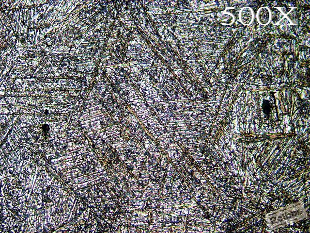

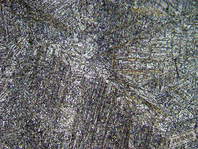

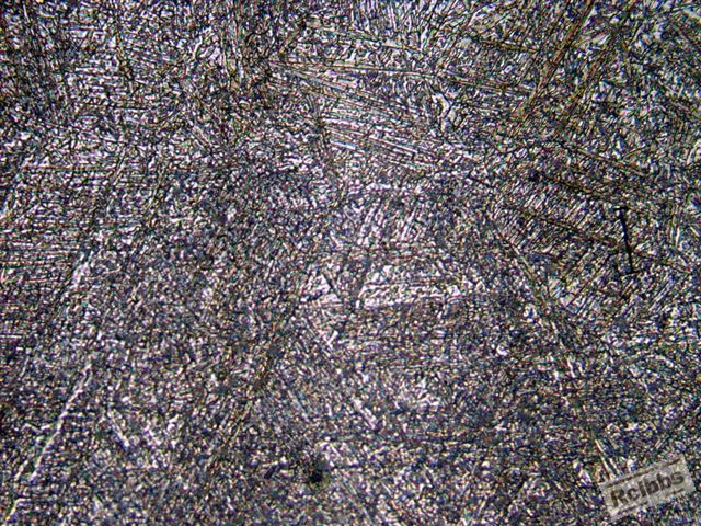

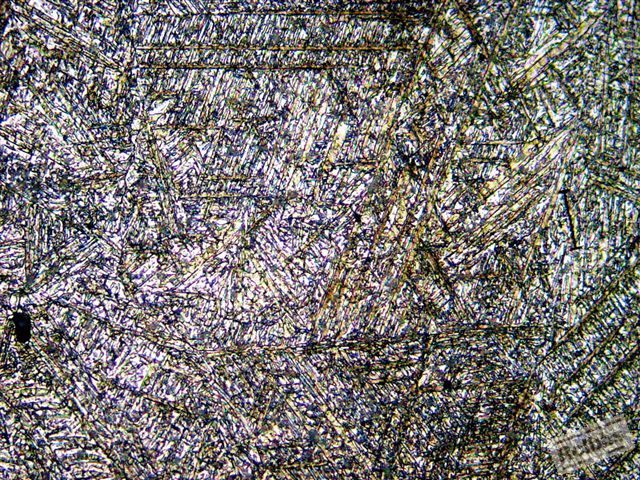

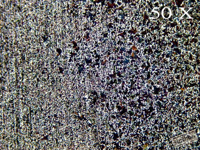

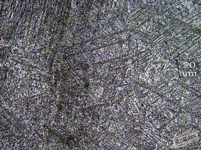

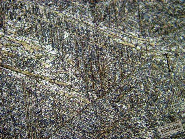

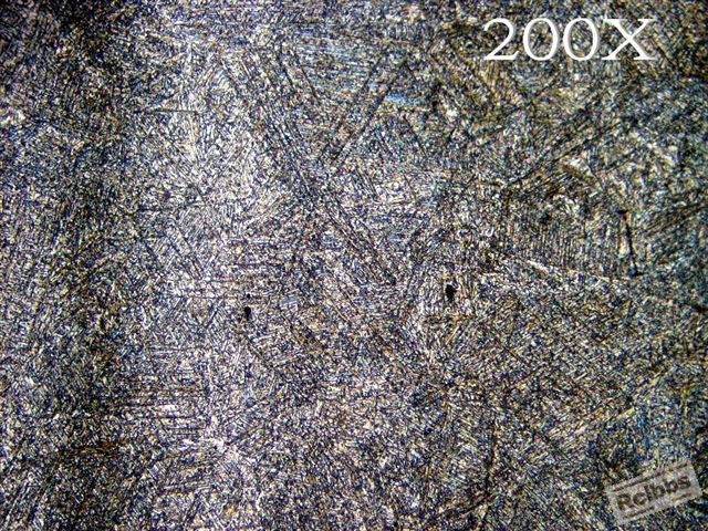

This very specimen, (AISI 4340?), ground, polished and etched.

perfect photo!
but  it lack of heat treatment method ,it is a regret.

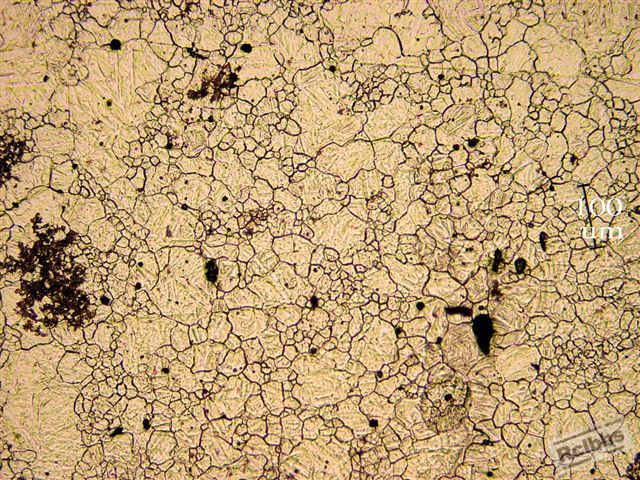

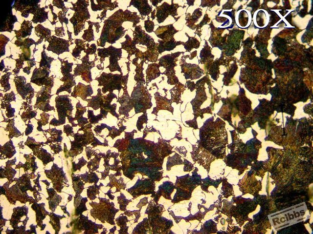

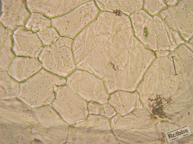

An unknown steel specimen , (SNCM 440 ?) larger in size than previous one (#241)
Shown below are photos with surface relief related to phase transformation.
Black spots are rusted shrinkage pores existed before mirror polishing.
Smooth areas are obtained from Ferritic/Pearlitic transformation and
rugged areas are related to Bainitic / Martensitic transformation.

请问这张照片是普通的光学金相彩照吗,不像啊?
签到天数: 474 天
 楼主| 发表于 2010-6-4 16:59:51 | 显示全部楼层
回复 253# Ronbin
    Photos in #242, #246 were taken from specimens right after quenching.
    photos taken with OM.  NOT SEM.
