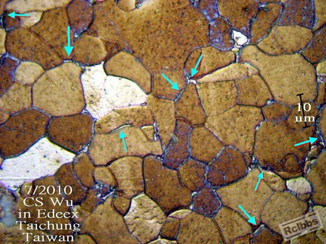

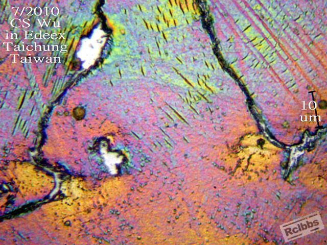

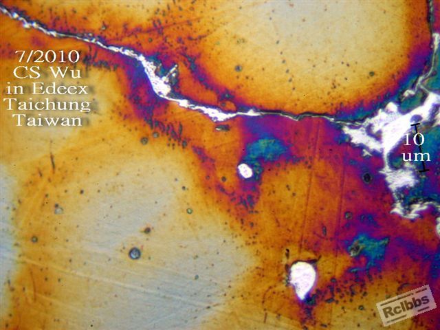

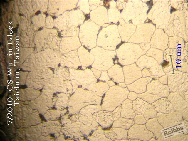

 楼主| 发表于 2010-7-2 06:49:20 | 显示全部楼层

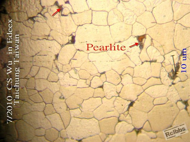

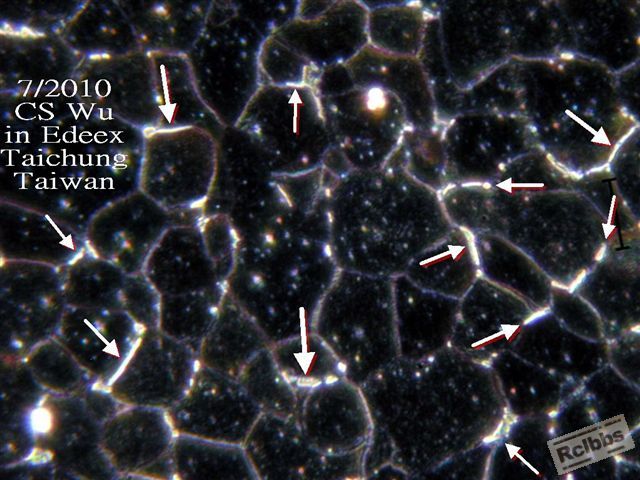

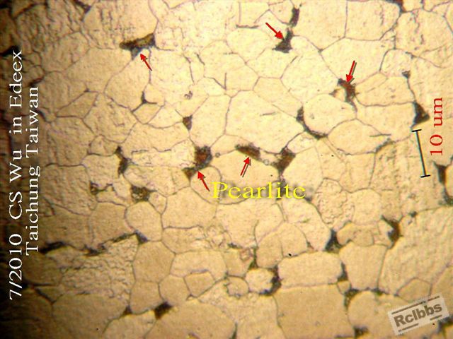

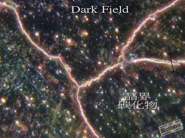

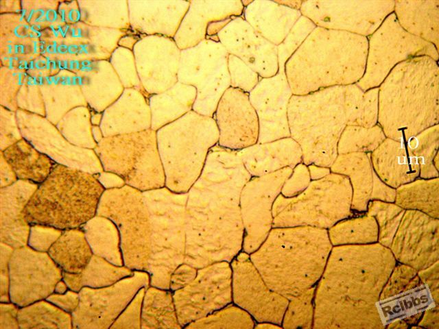

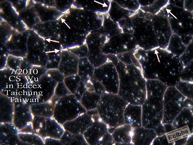

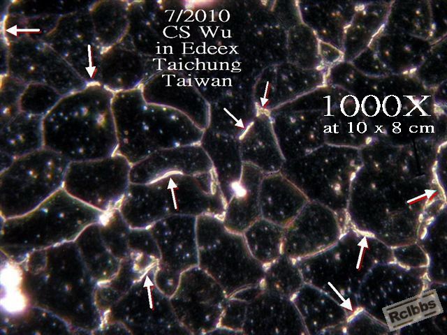

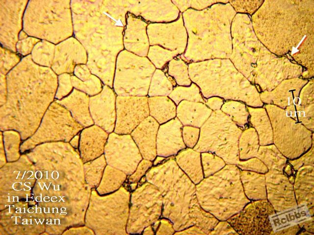

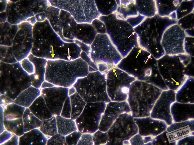

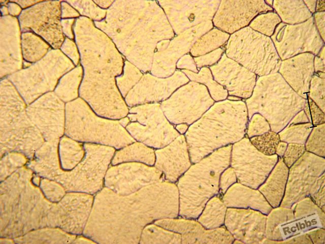

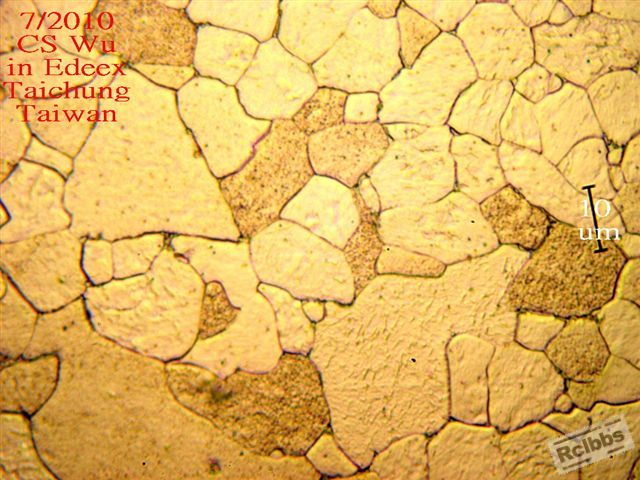

Photos for you to keep---for good.
Very low carbon steel sheet for forming. 2 mm thick.
Photos without Pearlite (arrowed) are taken from near-surface.
Last photo, dark field.  white arrow: grainboundary; yellow arrow:
carbide film.

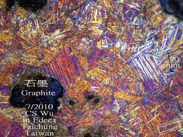

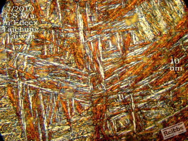

 楼主| 发表于 2010-7-4 10:04:25 | 显示全部楼层

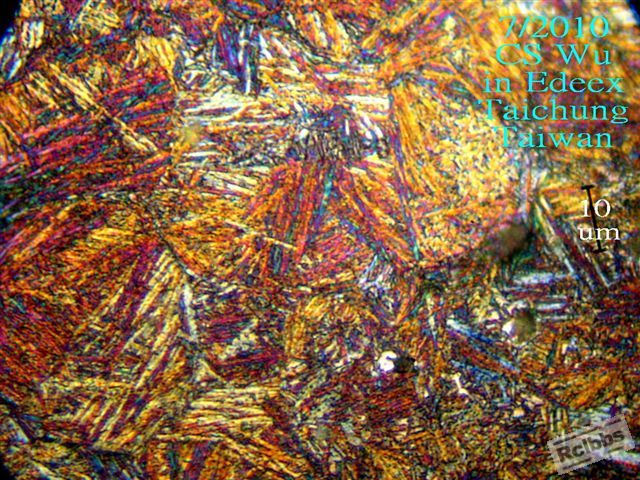

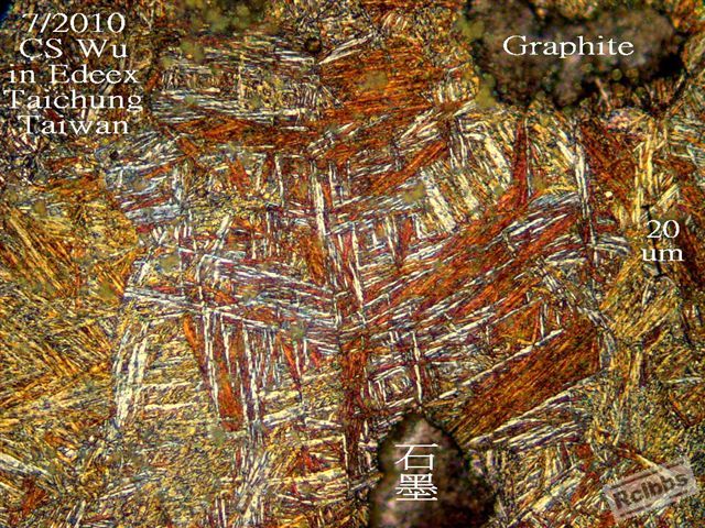

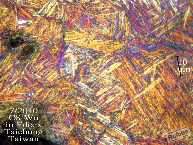

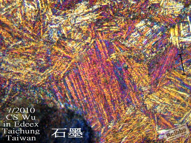

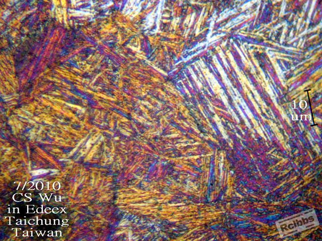

ADI color micrographes for your visual delight.

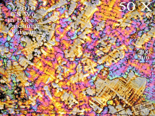

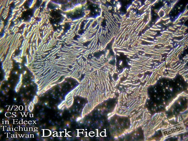

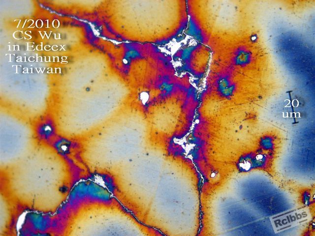

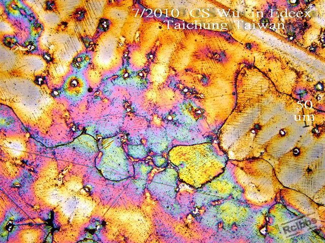

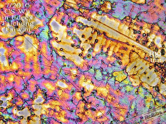

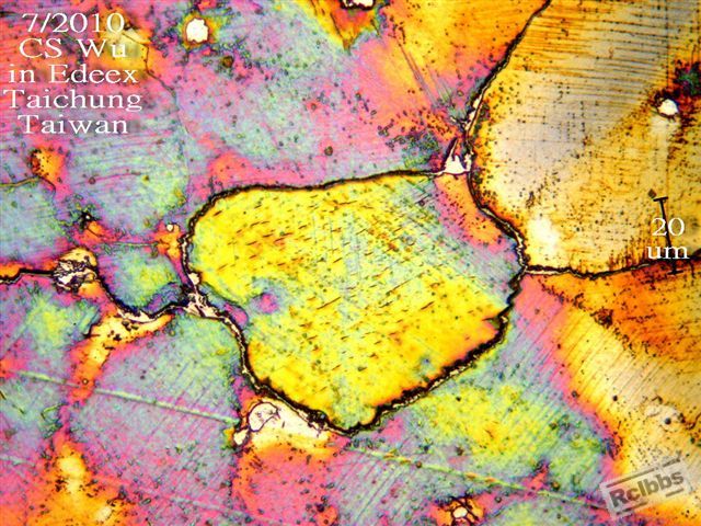

 楼主| 发表于 2010-7-17 18:28:22 | 显示全部楼层

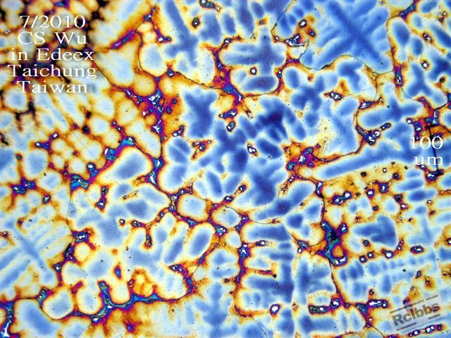

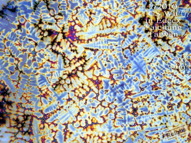

Art works from LeoMet

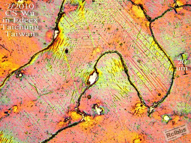

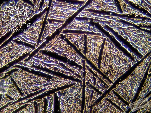

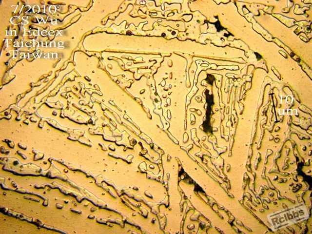

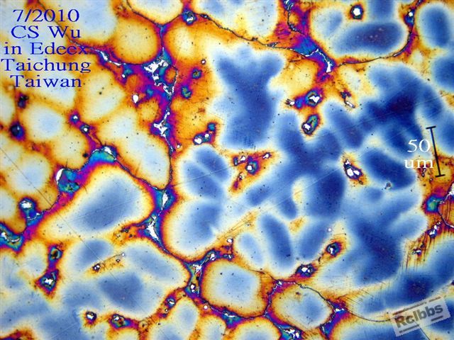

Austenitic Manganese Steel. Cast.
Shown in the photos are: interdendritic carbide particles and
"coring" (漸層) of the dendritic arms.
This as-cast specimen was not successfully solution annealed. It stayed
at 1020 C in a salt bath for too short a time (20 min) and then quenched in water.

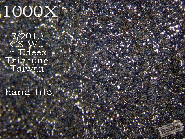

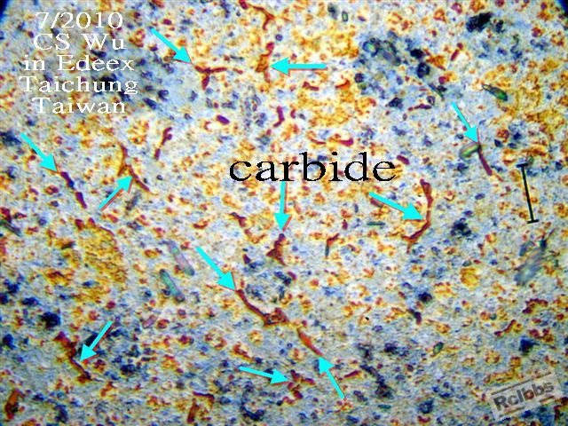

 楼主| 发表于 2010-7-17 18:46:22 | 显示全部楼层

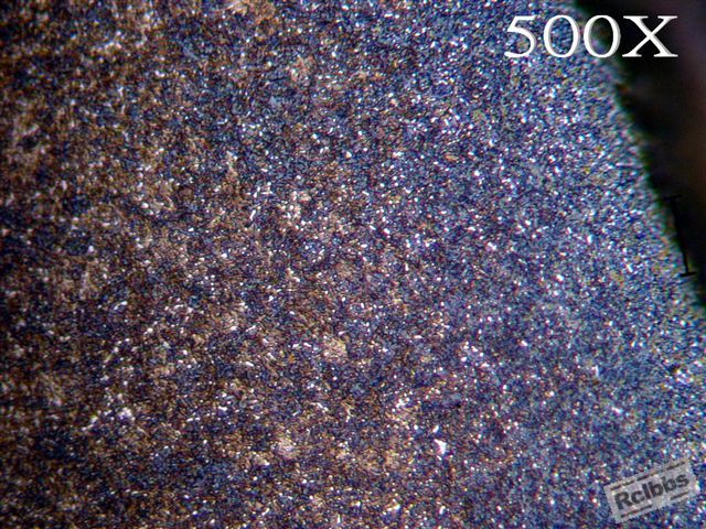

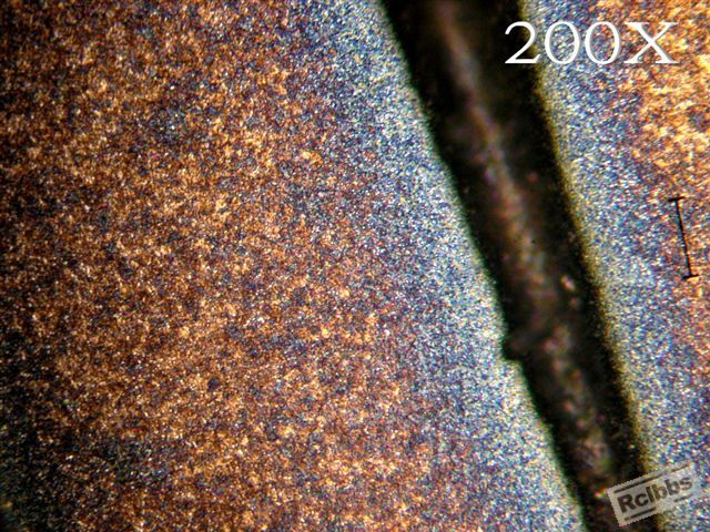

hand file  銼刀
Carbide particles dispersed in the matrix or Martensite.

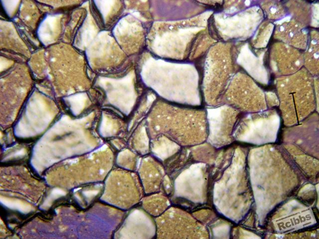

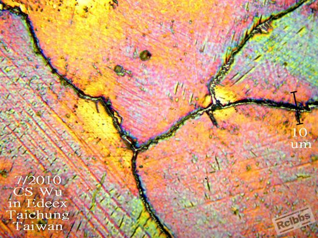

 楼主| 发表于 2010-7-17 19:06:23 | 显示全部楼层
回复 265# leomet

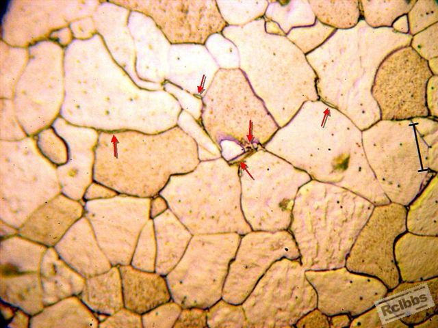

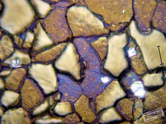

Grain boundary carbide films in a very low carbon steel sheet.
051 -  carbide tinted
088 -  Ferrite tinted
others  -  dark field

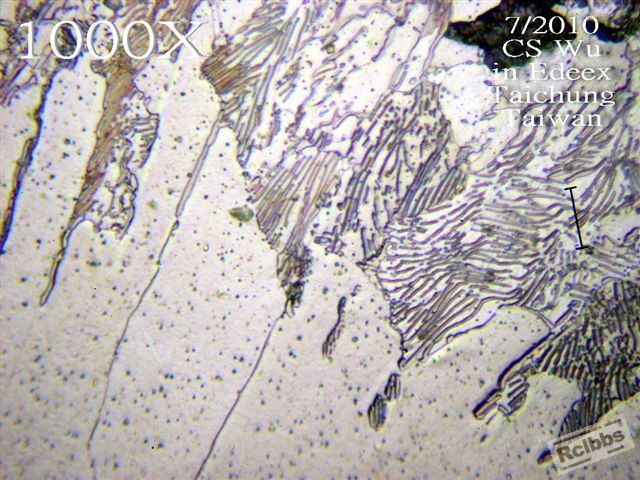

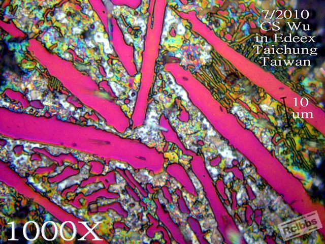

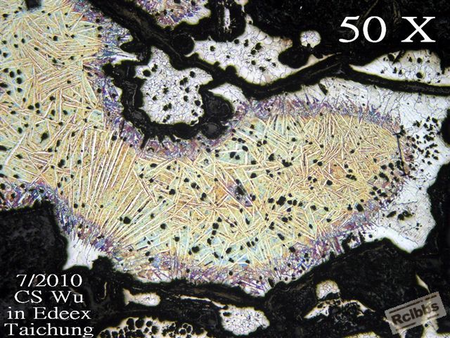

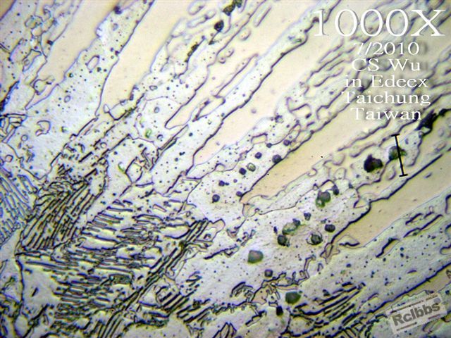

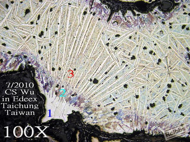

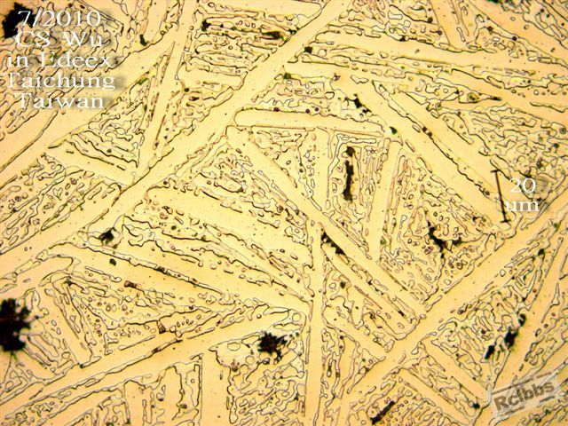

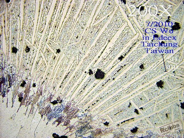

 楼主| 发表于 2010-8-1 13:21:15 | 显示全部楼层

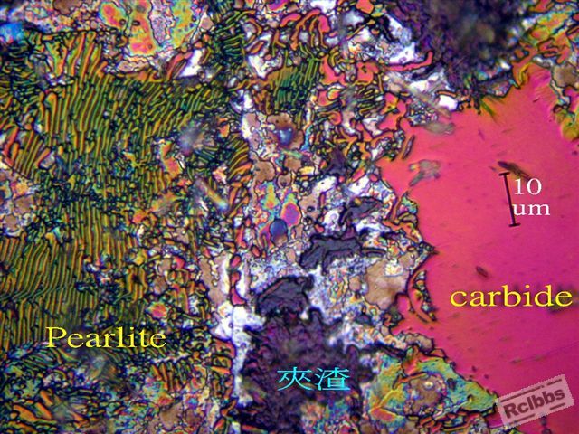

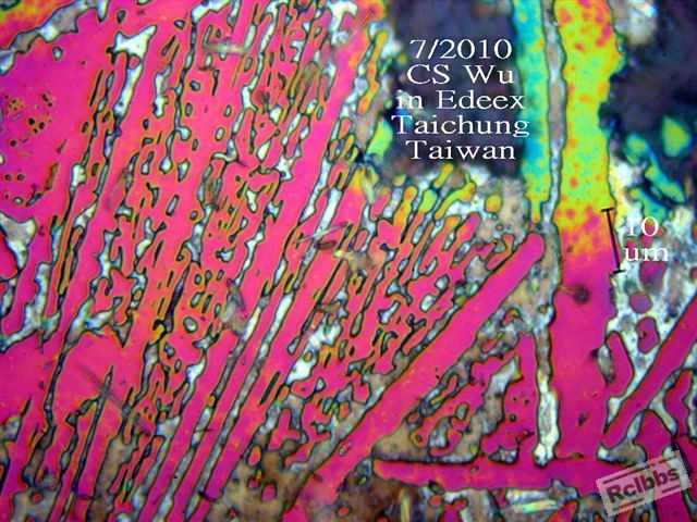

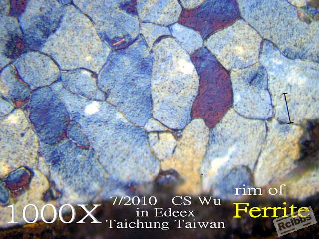

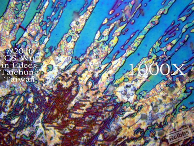

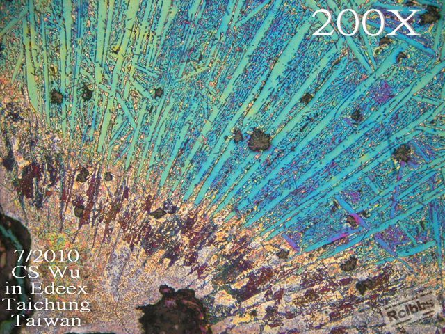

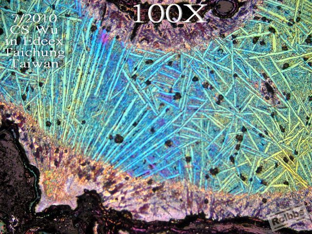

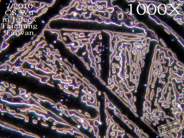

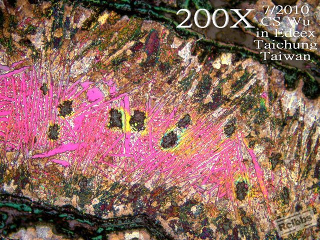

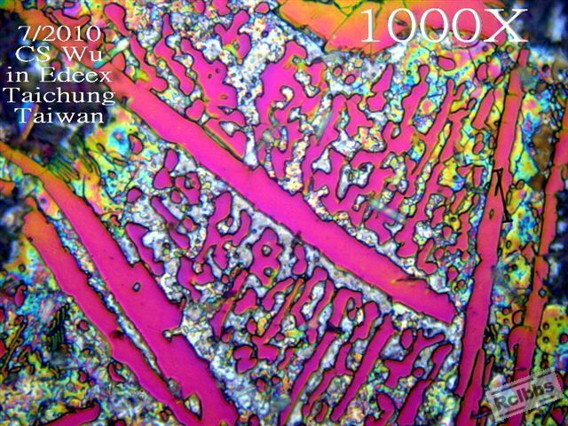

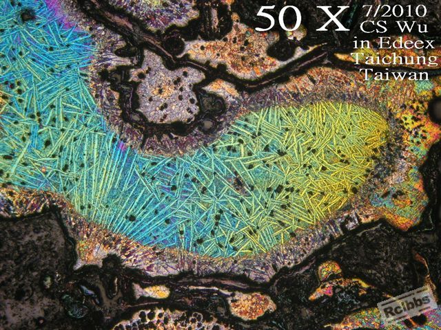

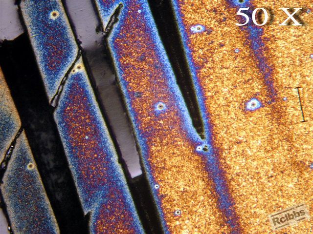

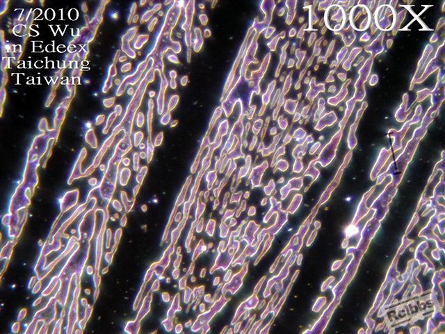

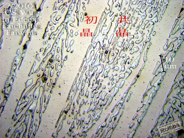

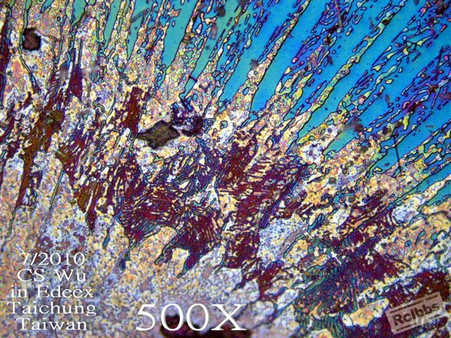

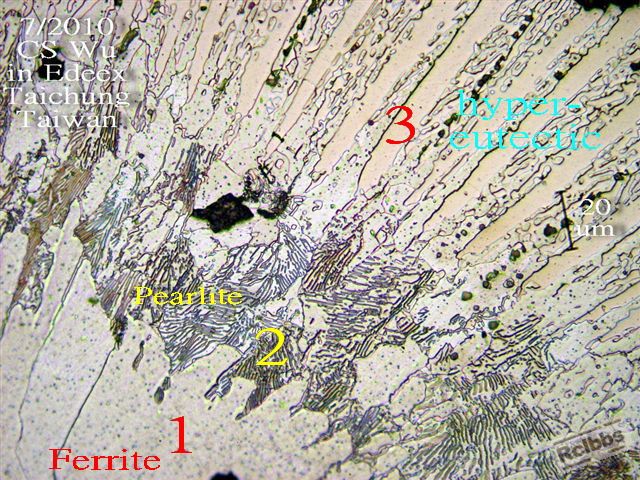

高爐 鉄渣
高爐是把鉄礦砂先做成生鉄的設備. 生鉄CE值很高(~ 5%), 為過共晶成份. 其鉄渣因急冷而成白鑄鉄.
外圍在空氣中脫碳形成一層Ferrite (1), 往內碳素漸高 有Pearlite層(2) 最後是正常的過共晶白鑄鉄(3).
参与人数 1热处理币 +10 贡献值 +10 收起 理由
秋天的风 + 10 + 10 感谢上传!
签到天数: 474 天

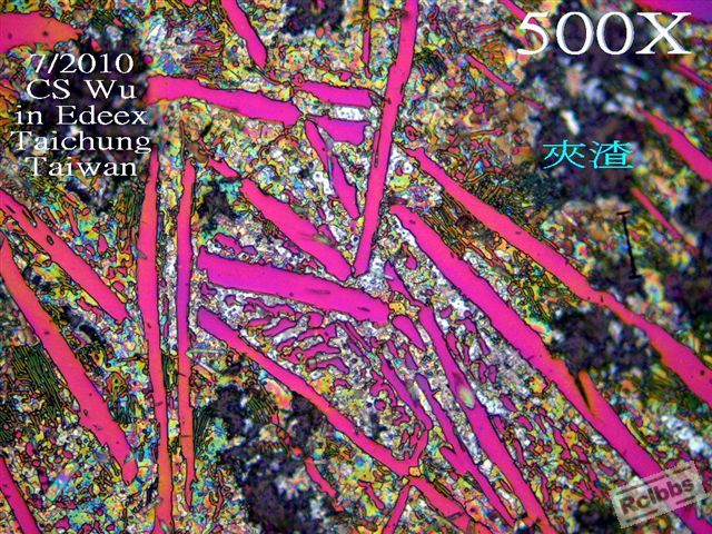

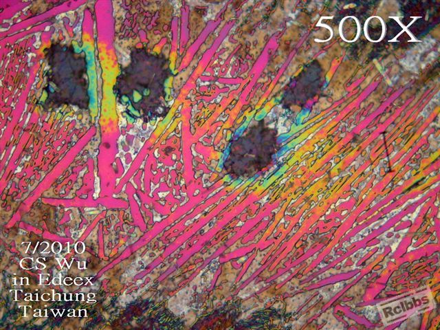

 楼主| 发表于 2010-8-1 15:35:00 | 显示全部楼层
After color etching
Many hours of  hard work in total to turn out this and #283 above.
