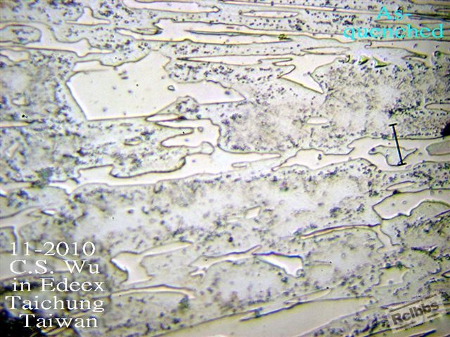

 楼主| 发表于 2010-11-20 10:09:24 | 显示全部楼层

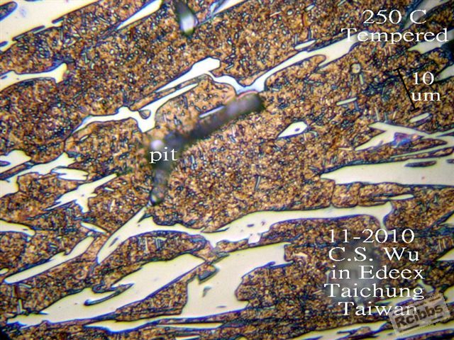

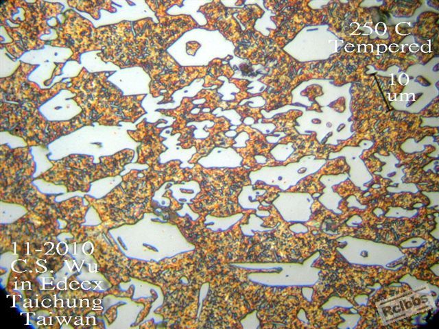

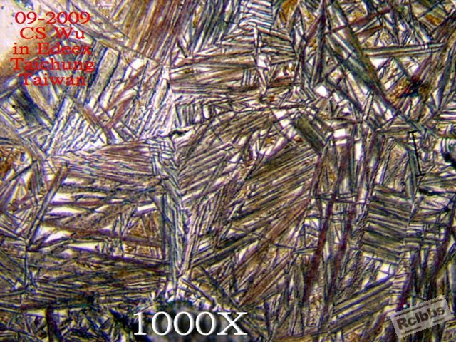

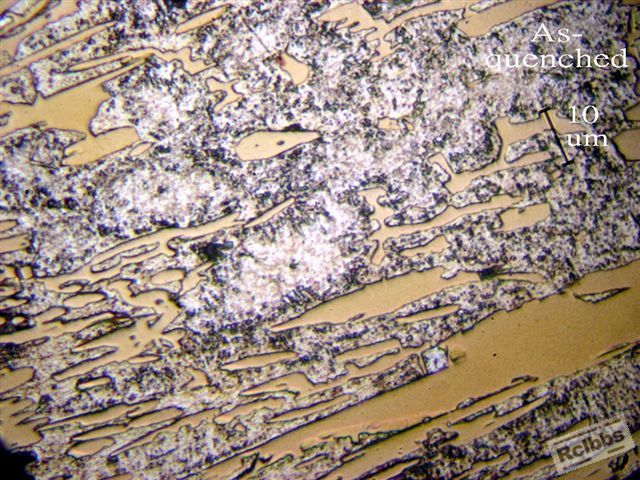

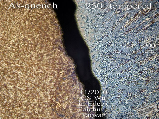

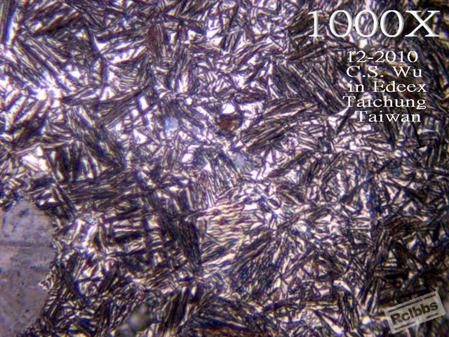

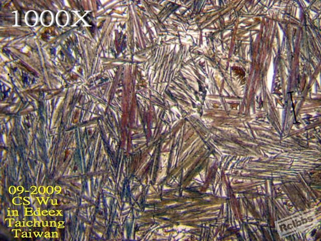

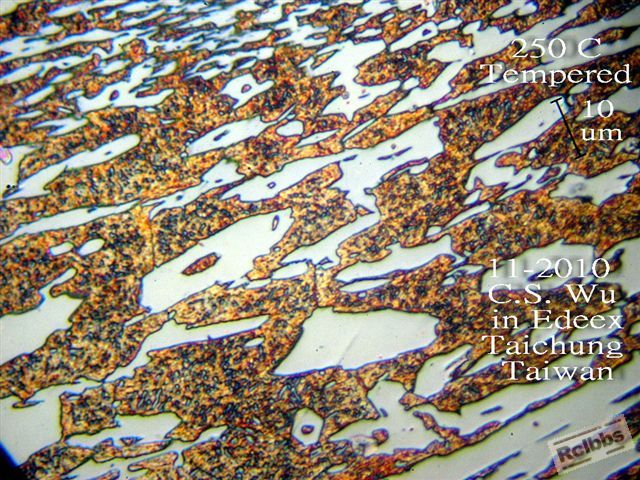

25Cr Alloyed cast iron.
~778; ~852   As-quenched : Untempered martensite matrix  is difficult to
etch / tint and appears brighter than the matrix that is tempered .
~780  Tempered: matrix easy to etch / tint, so the matrix appears to be darker.
Also, A large number of carbide particles precipitated from matrix.

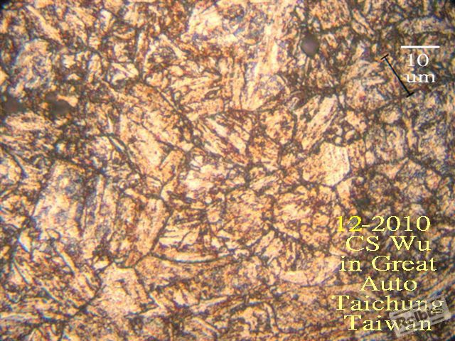

 楼主| 发表于 2010-12-9 18:10:07 | 显示全部楼层

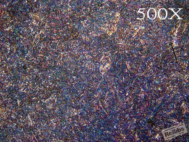

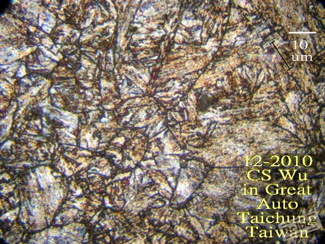

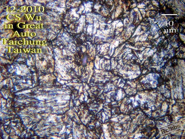

Drum Stick   AISI 4135 Q/T

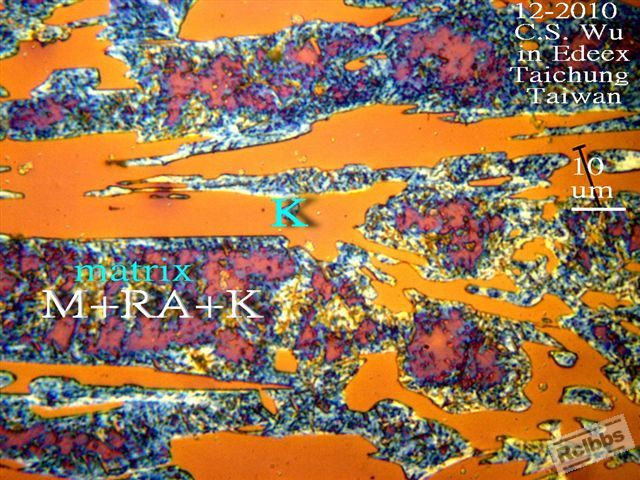

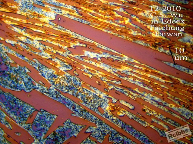

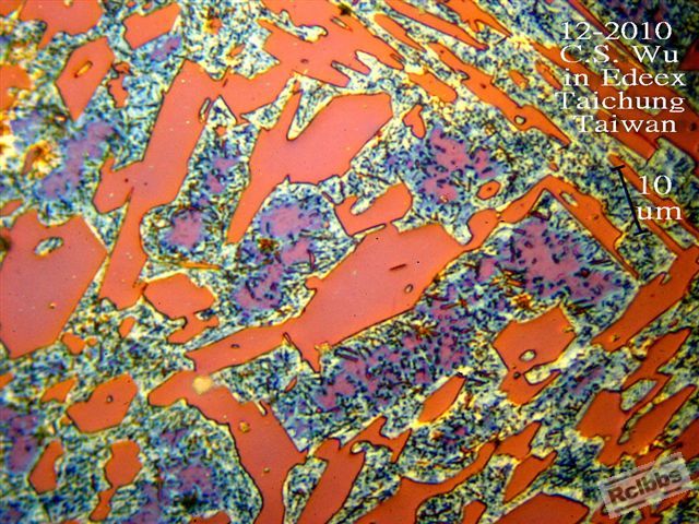

 楼主| 发表于 2010-12-15 08:48:57 | 显示全部楼层

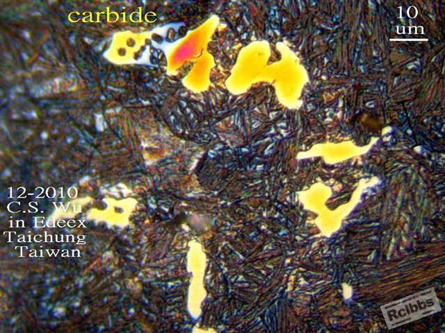

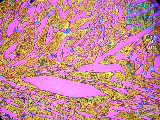

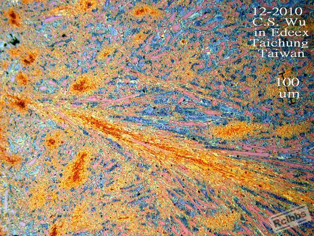

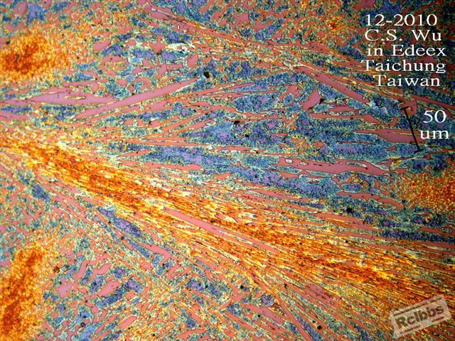

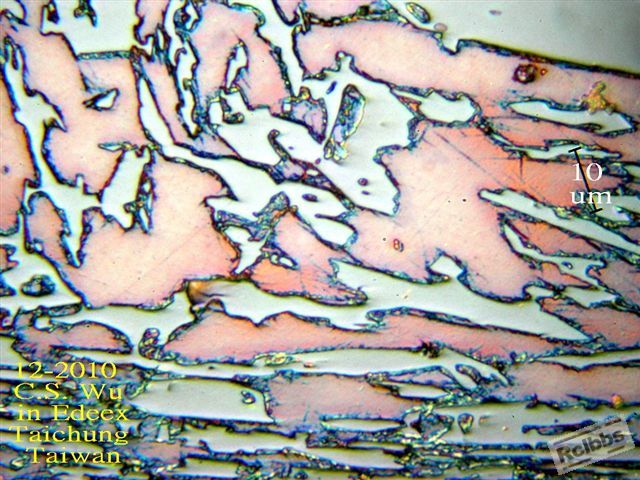

For your eyes only. 007電影 有一集片名

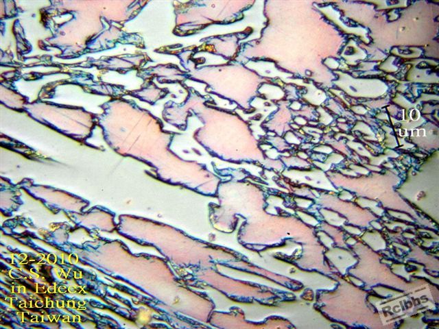

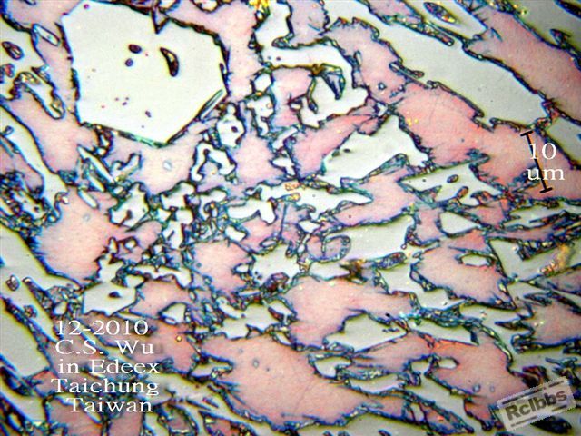

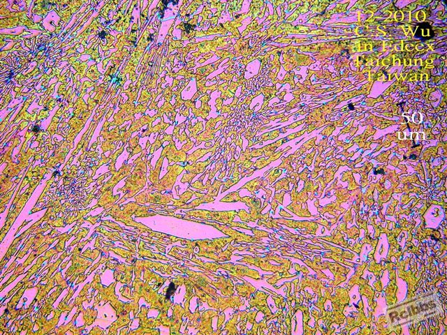

25Cr alloy white cast iron
Carbide tinted pink.
参与人数 1热处理币 +10 贡献值 +10 收起 理由
秋天的风 + 10 + 10 感谢上传!
签到天数: 474 天
 楼主| 发表于 2010-12-15 08:52:16 | 显示全部楼层

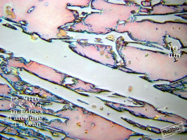

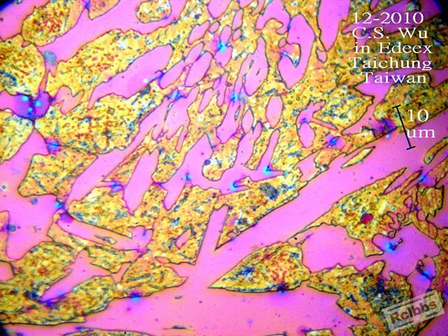

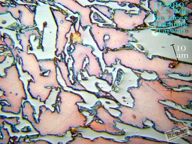

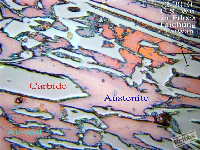

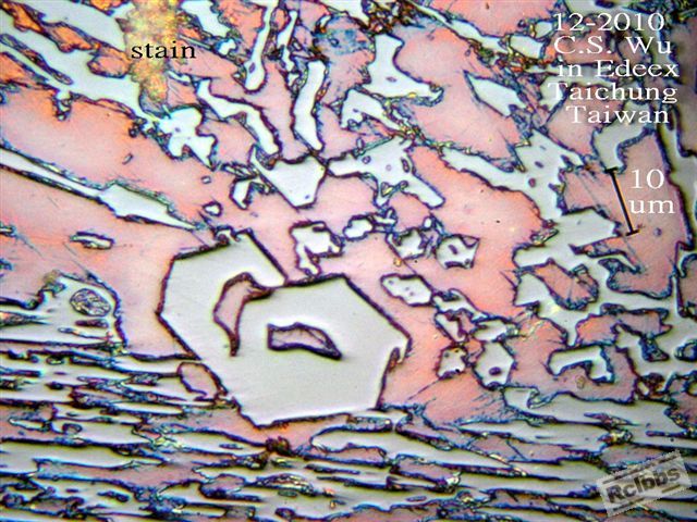

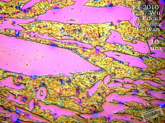

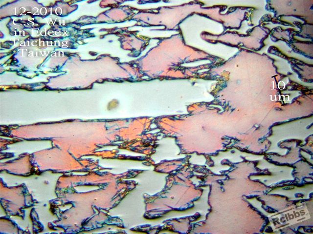

25Cr alloy white cast iron, as-cast.
Carbide in the matrix of Austenite.
Austenite tinted pink.

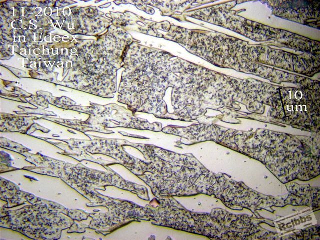

 楼主| 发表于 2010-12-15 09:10:10 | 显示全部楼层

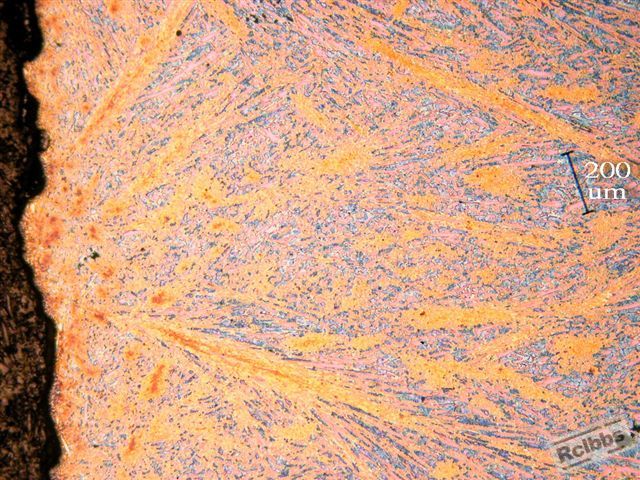

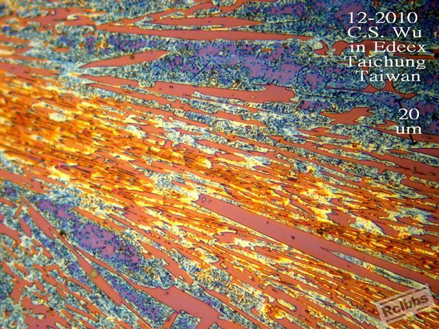

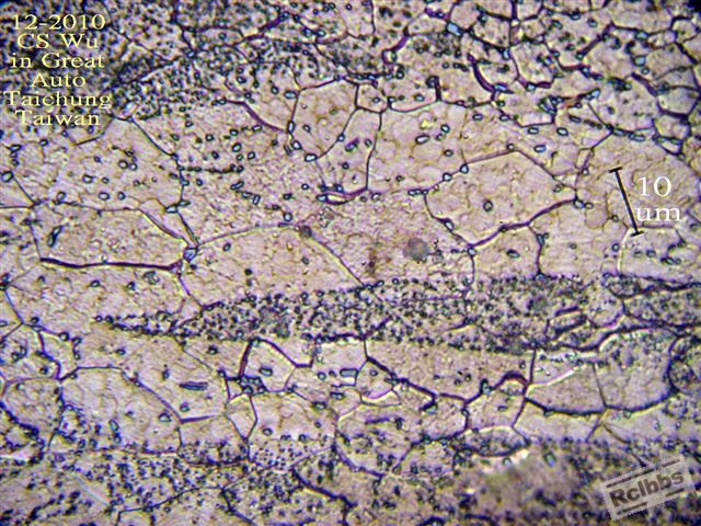

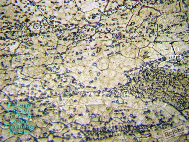

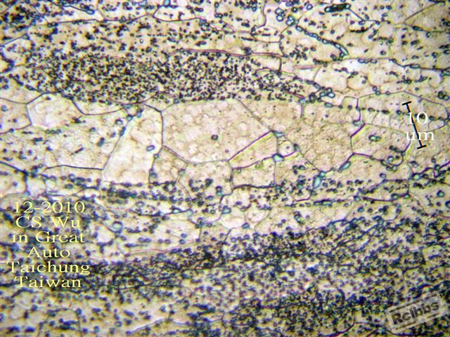

 楼主| 发表于 2010-12-27 18:58:23 | 显示全部楼层

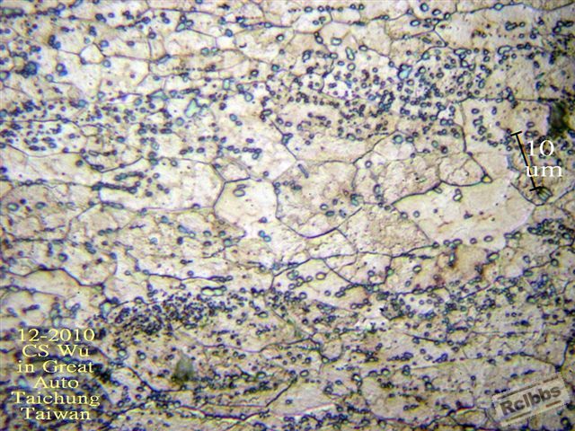

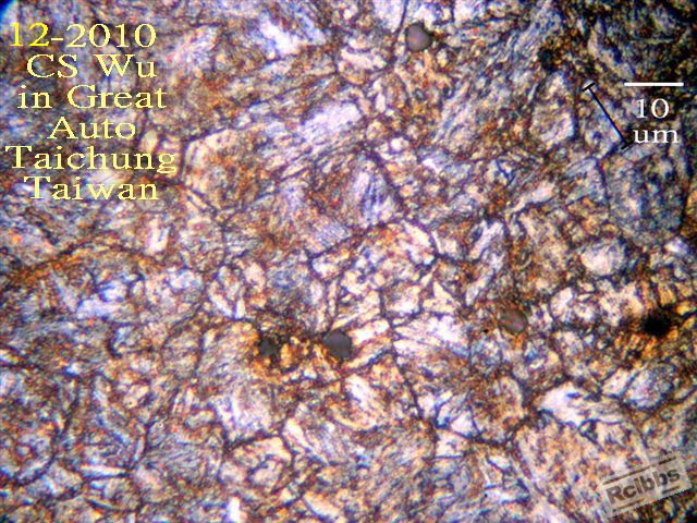

回复 323# leomet

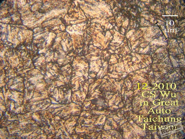

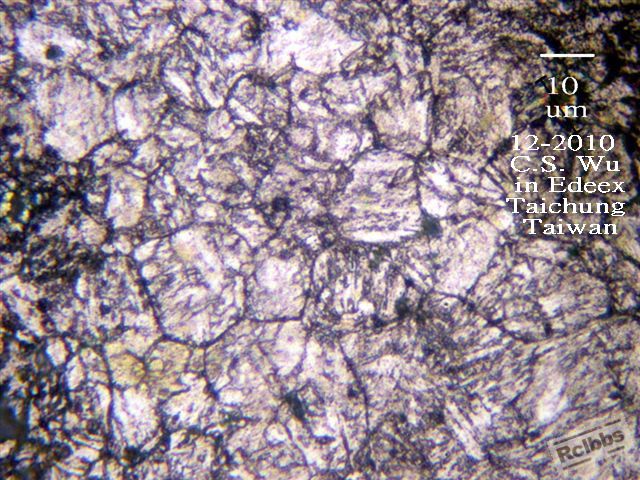

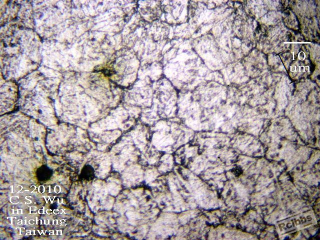

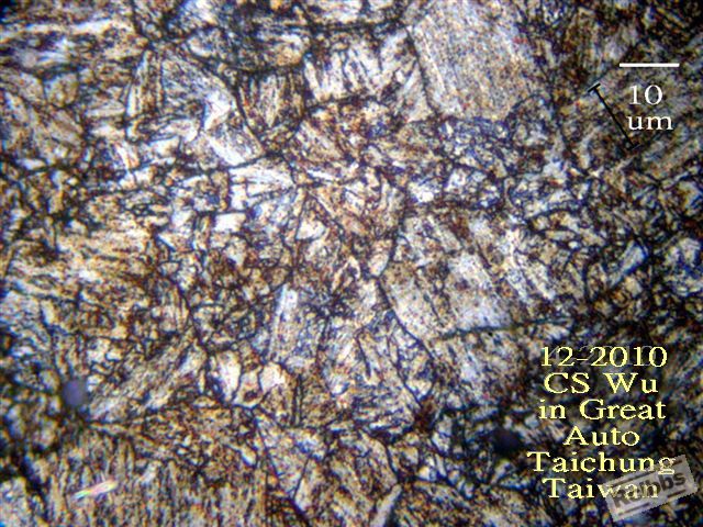

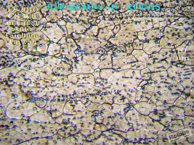

    Photos you seldom see.
AISI 4140, cold forged part.
Recrystalized at ~600C for 30+ min
Note the subgrains in big grains.

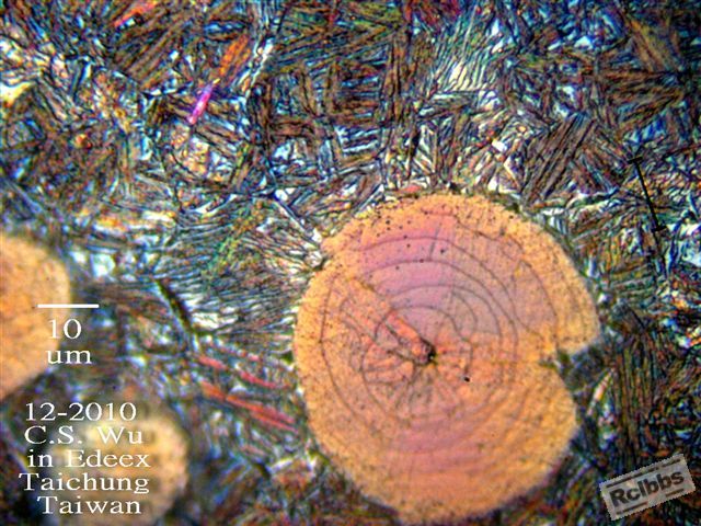

 楼主| 发表于 2010-12-31 19:14:07 | 显示全部楼层

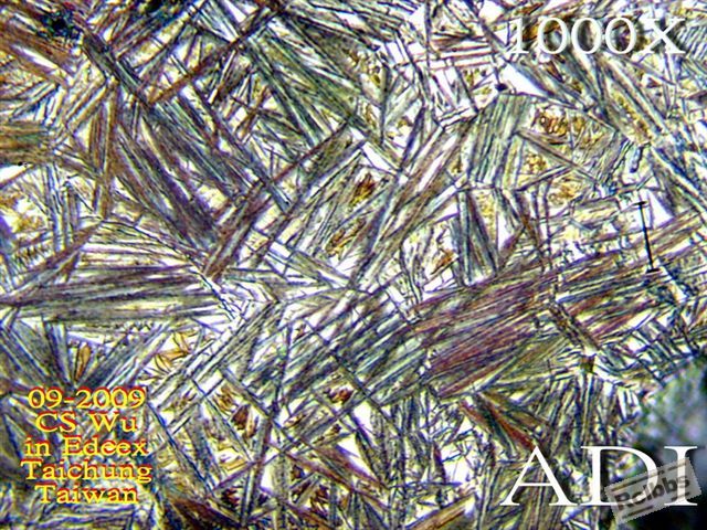

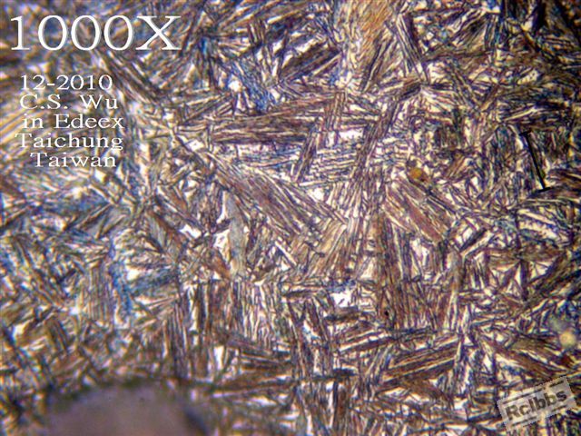

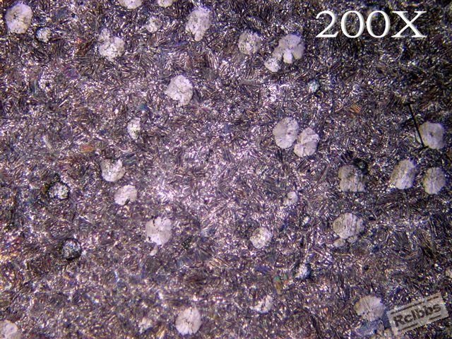

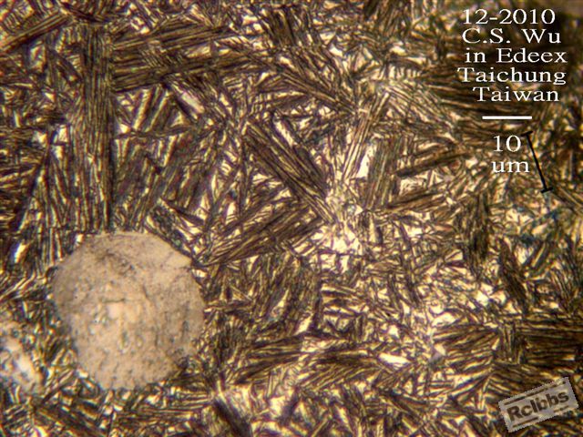

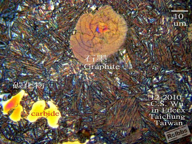

ADI

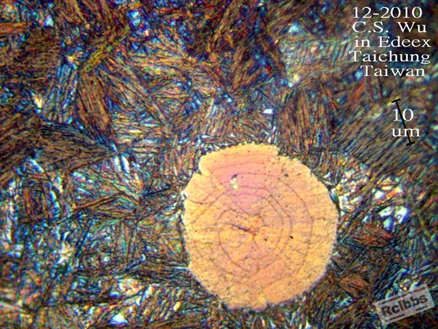

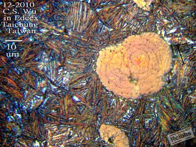

回复 328# leomet

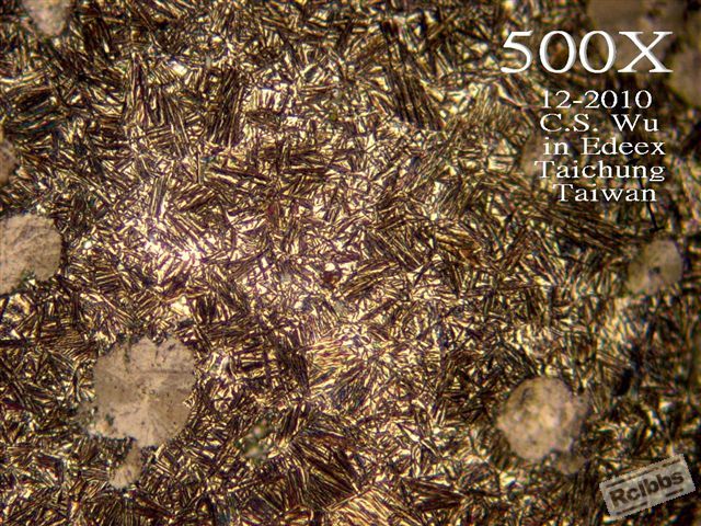

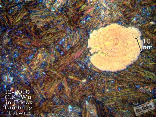

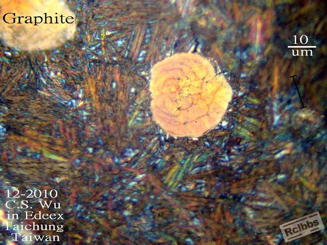

Art work from one of the best metallurgists from Taiwan.
Ductile Iron  Austempered at 350C
Today, 12/31, the last day of 2010, obtained by chance, this wonderful tinting  reveals  details of graphite nodules.
These graphite nodules look somewhat like the cross section of "Swiss rolls", don't they? 瑞士卷
I am pretty much satisfied with these photos and hope you guys enjoy seeing these photos as well.

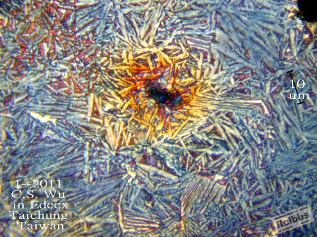

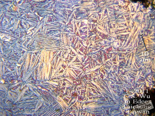

 楼主| 发表于 2011-1-9 10:41:59 | 显示全部楼层

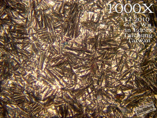

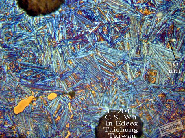

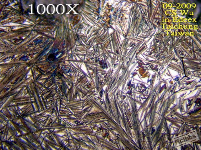

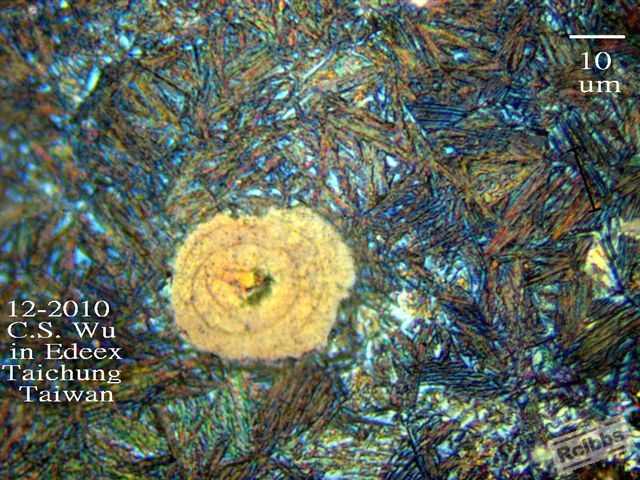

回复 333# leomet

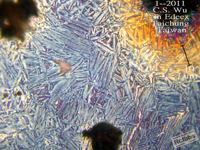

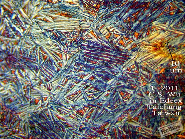

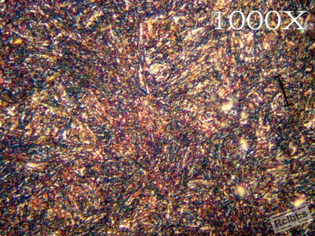

ADI  color etched again.
Austempered  台灣叫"沃斯回火"

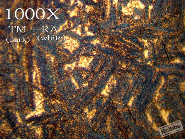

 楼主| 发表于 2011-1-9 10:47:01 | 显示全部楼层
回复 337# leomet

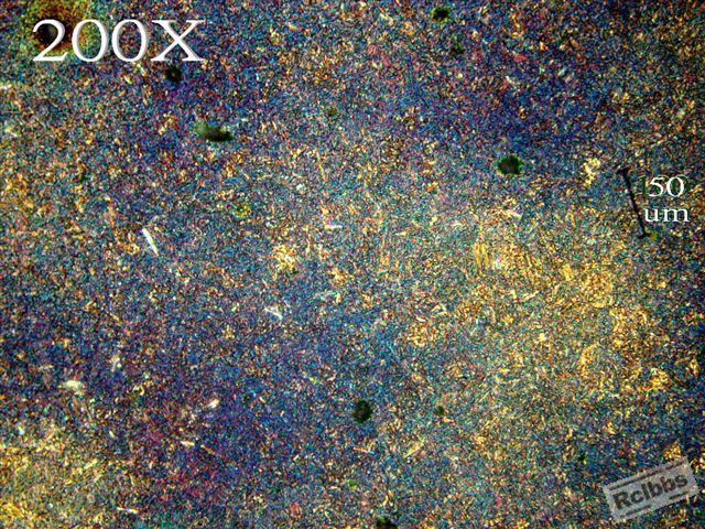

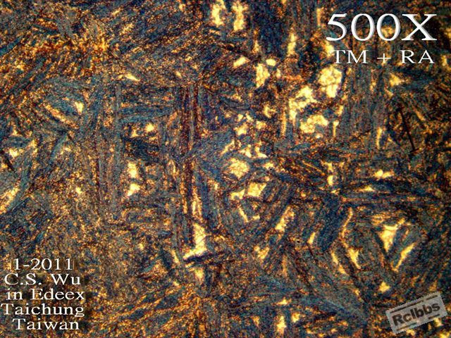

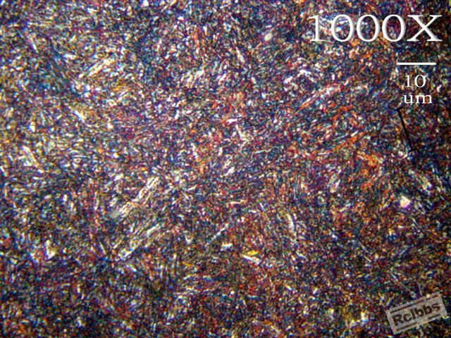

P3,  Cast  + Normalized + Q.T.
To be used for injection mold and die.

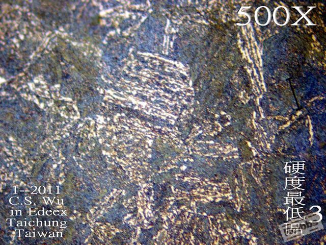

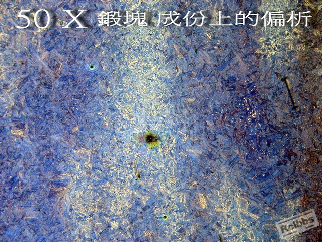

 楼主| 发表于 2011-1-9 10:51:15 | 显示全部楼层

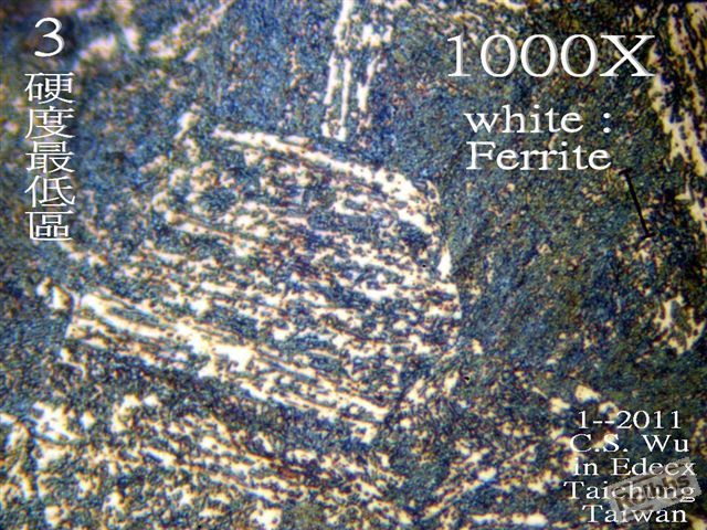

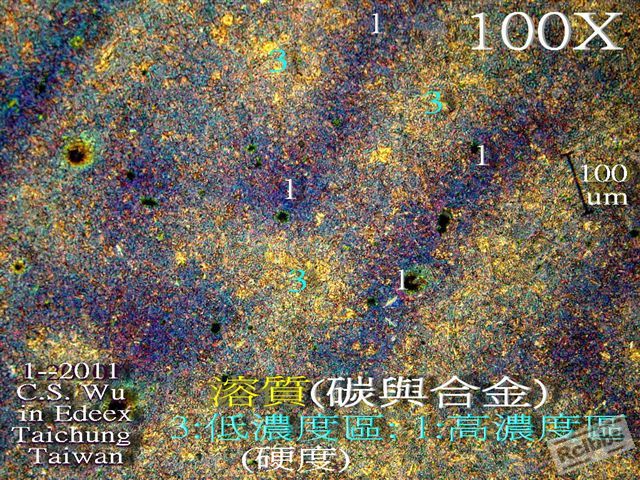

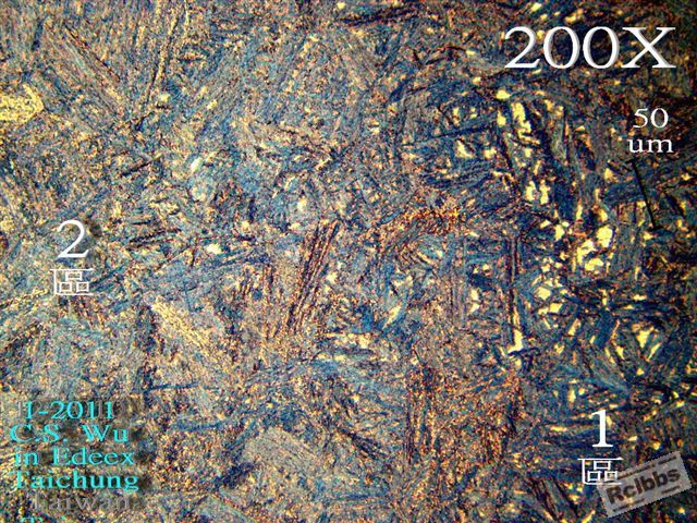

回复 338# leomet

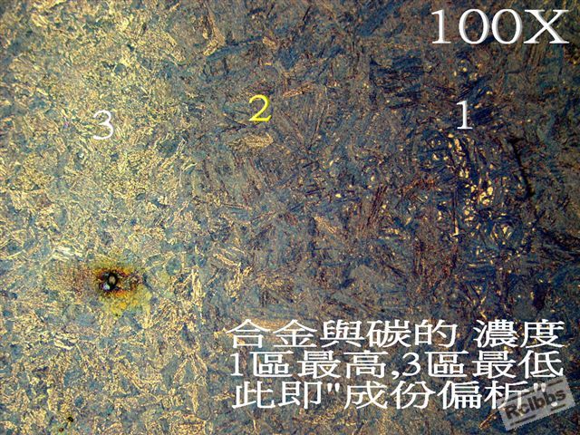

    P3, 鍛塊.
   1 區: 高碳M+殘A               Solute-rich
   2 區: Martensite
   3  區: M + 微量Ferrite      Solute-poor

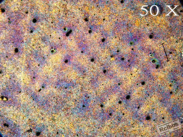

 楼主| 发表于 2011-2-5 19:10:48 | 显示全部楼层

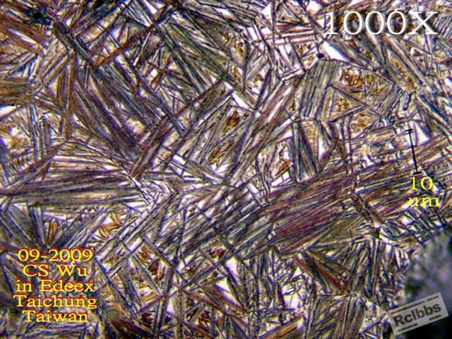

These  ADI photos are really feast to my eyes.
Hope they are so to your eyes too.

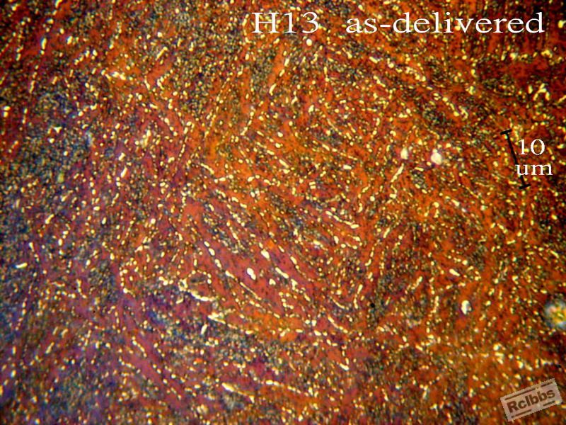

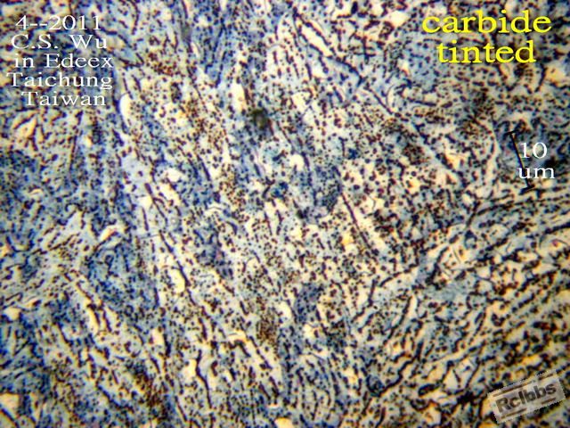

 楼主| 发表于 2011-4-18 18:37:10 | 显示全部楼层

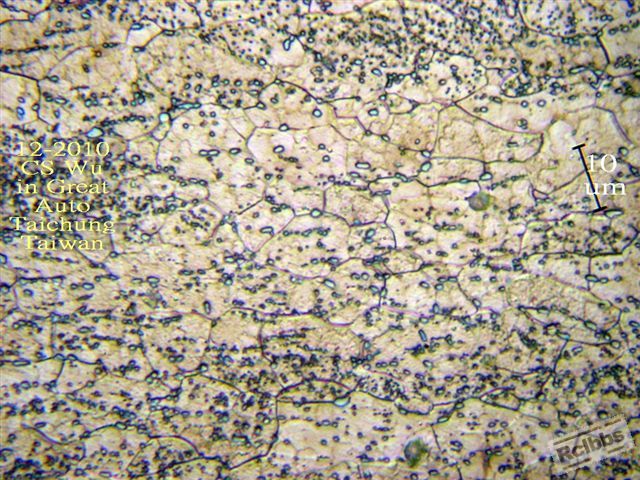

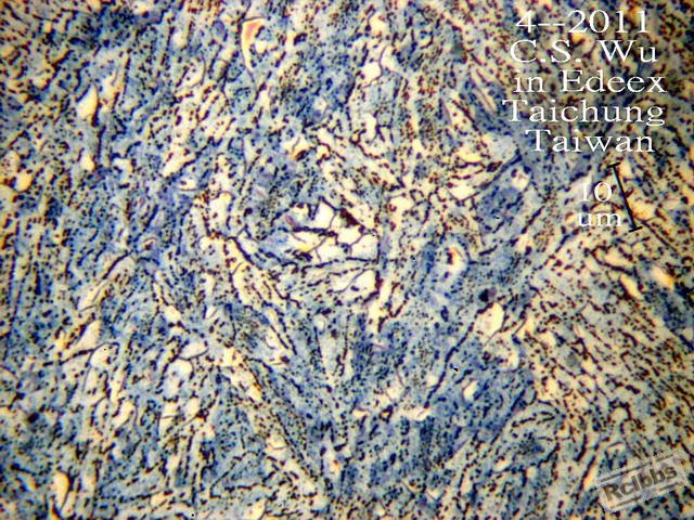

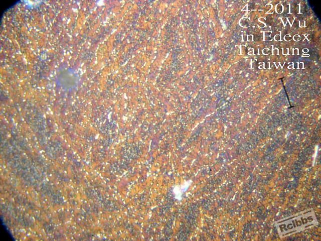

H13, 原材料
H13, 原材料, Distribution of carbide particles is NOT so good.
~188, ~190  Carbide tinted.
~216, ~218,  Ferrite tinted, carbide remained white.
