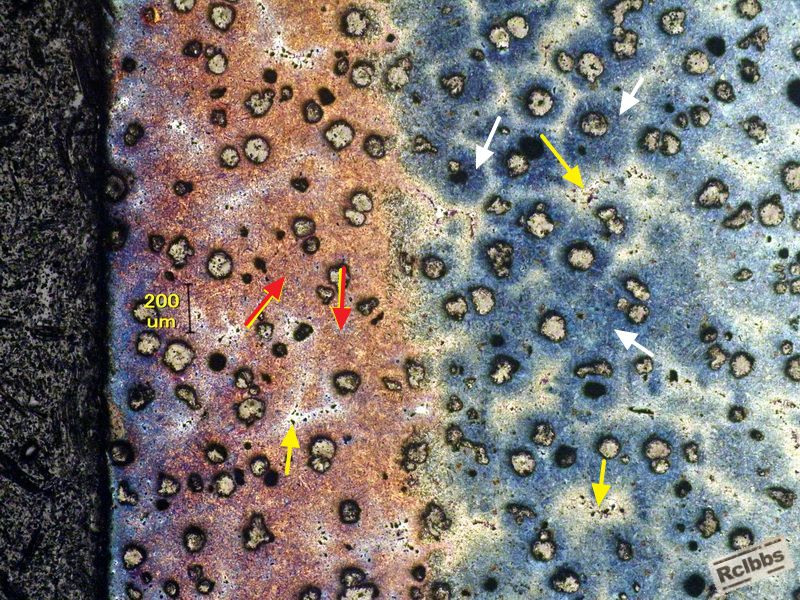

[讨论] Whis is this microstructure?

发表于 2015-9-13 19:47:32 | 显示全部楼层
针状马氏体加残余奥氏体

签到天数: 474 天
 楼主| 发表于 2015-11-1 16:37:26 | 显示全部楼层
I am in English mode now.
ADI is Austempered Ductile Iron
white arrows: Lower B + R.A.; obtained by Austempering.
red arrows:  high C% M + R.A. obtained by induction hardened area,
yellow arrows: interdendritic areas, rich in alloy elements.
Therefore, micro-voids and carbide present, and M and R.A. abound.
R.A. is highly reflective, and that is why these areas appear "white".
photo iq3 is taken from this area.

签到天数: 524 天
发表于 2015-11-2 10:51:52 | 显示全部楼层
楼主还未公布答案?
白色毋庸置疑,残余奥氏体
彩色有两种颜色,灰色的是?浅黄色的是?

 楼主| 发表于 2015-11-2 20:13:17 | 显示全部楼层
hawkch 发表于 2015-11-2 10:51
楼主还未公布答案?
白色毋庸置疑,残余奥氏体
彩色有两种颜色,灰色的是?浅黄色的是?
I just did.  Please see #31...................
