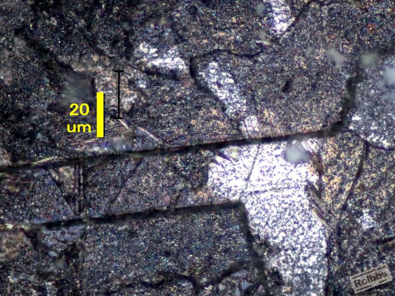

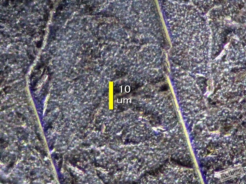

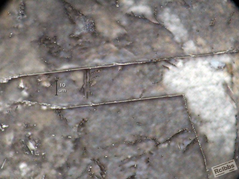

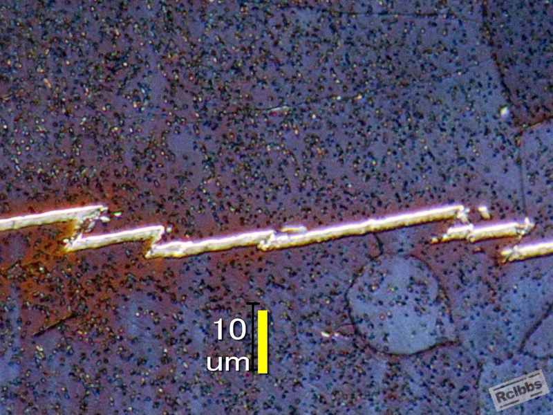

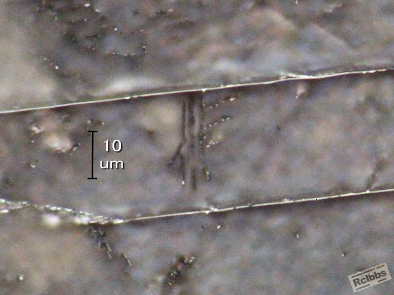

Hello, Mr. Wu, matrix which is close to twin boundary is always short of carbide particles, can i say that it was twin boundary carbide the cause the shortage of carbide particles?
签到天数: 474 天
 楼主| 发表于 2015-10-30 17:29:21 | 显示全部楼层
Yes, you are right. Carbon atoms gather at twin boundary to form carbide, so there is always a carbide-free zone/band (PFZ) beside twin carbide, and boundary carbide as well.
签到天数: 474 天
 楼主| 发表于 2015-10-30 19:48:32 | 显示全部楼层

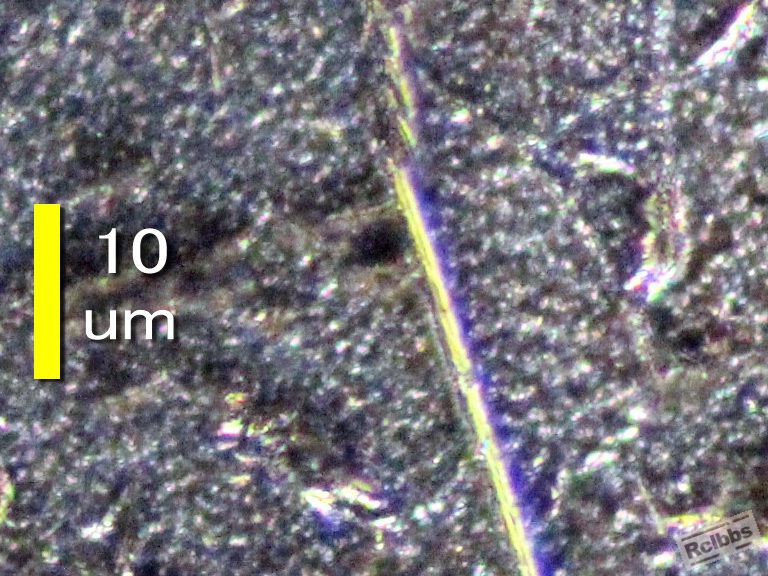

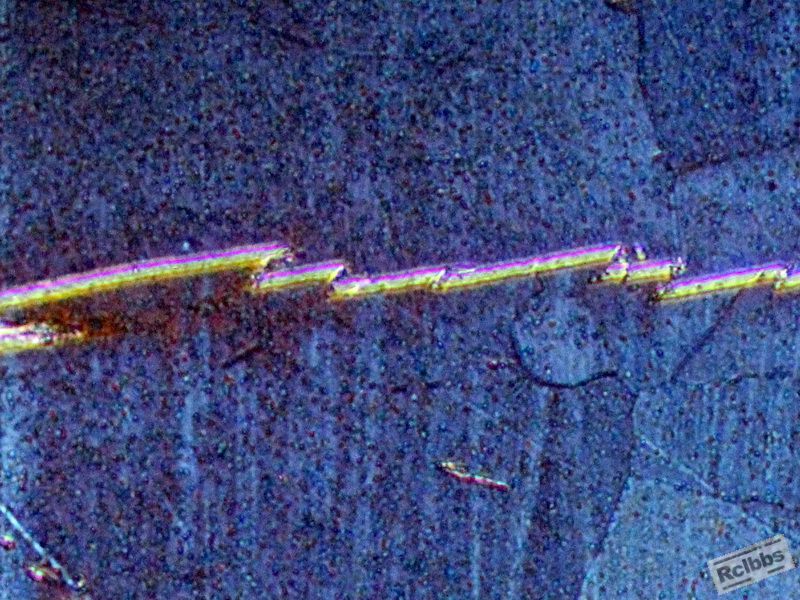

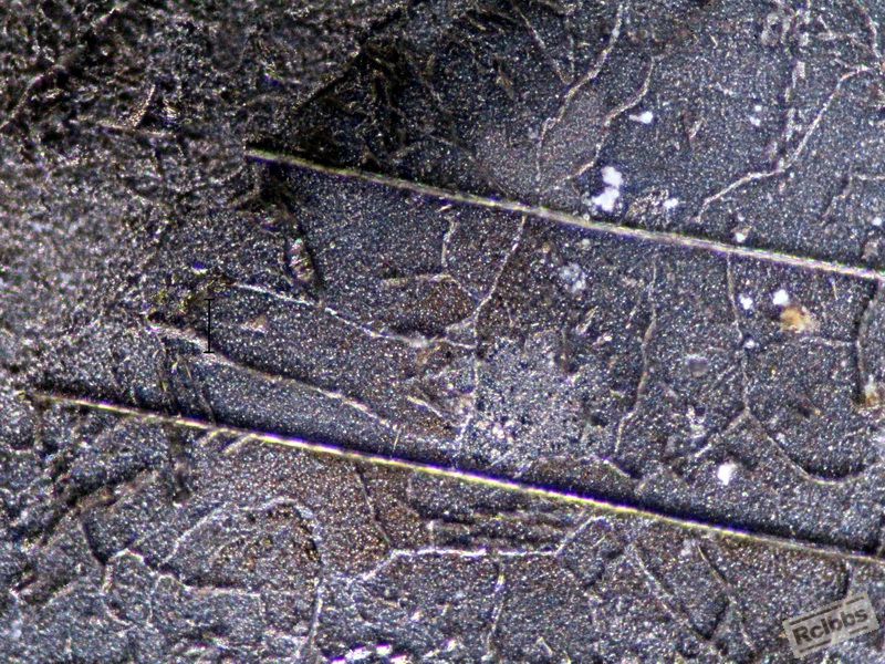

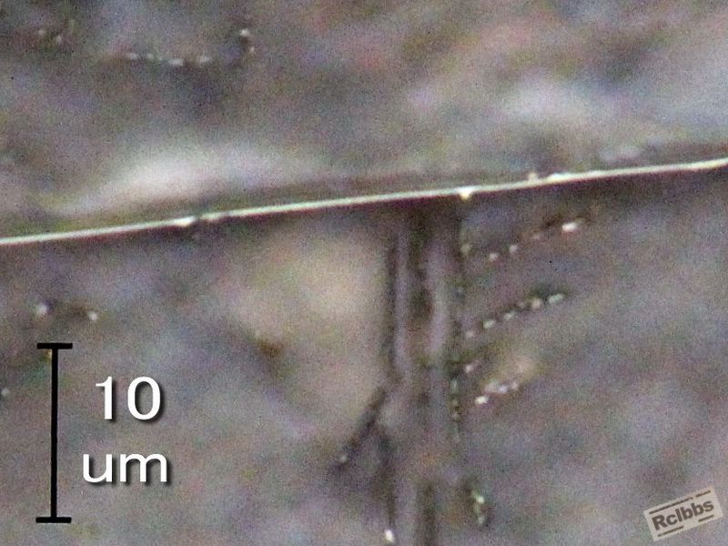

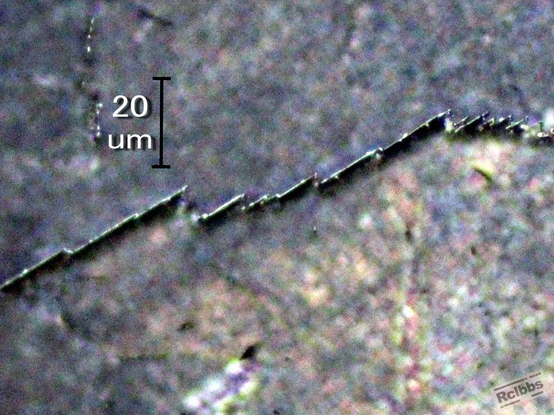

該試樣繼續浸蝕下去, 基地腐蝕更深, 碳化物突出更高, 對焦效果就不好了.
Note that the twin carbide plates  sticking out of the matrix more.
They act as blade and cut open the matrix of the steel.
孪晶 碳化物 薄(刀)片
孪晶 碳化物 薄(刀)片

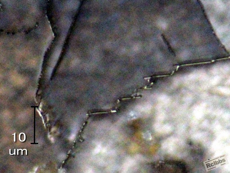

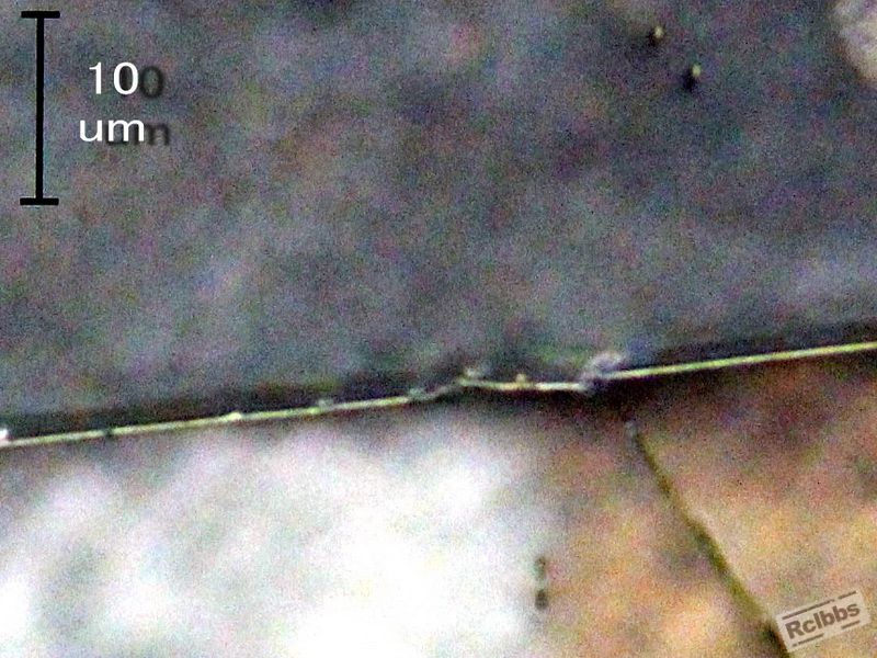

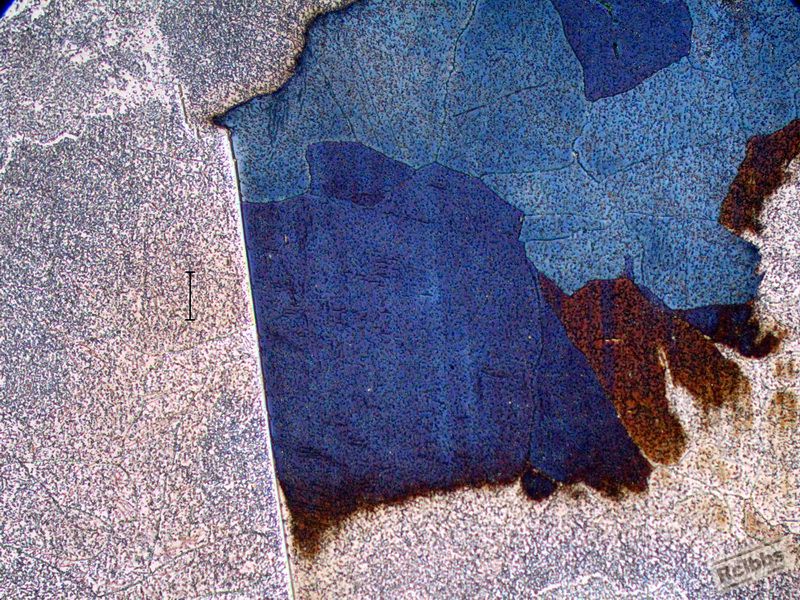

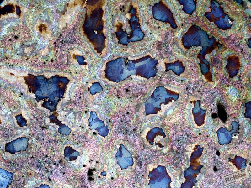

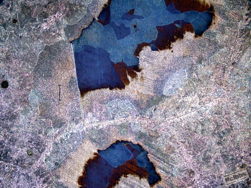

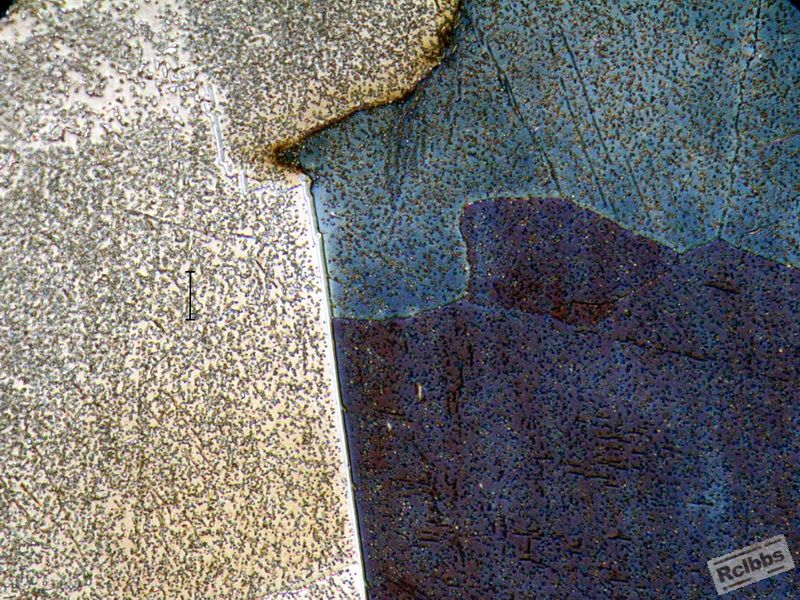

 楼主| 发表于 2015-11-2 20:36:33 | 显示全部楼层

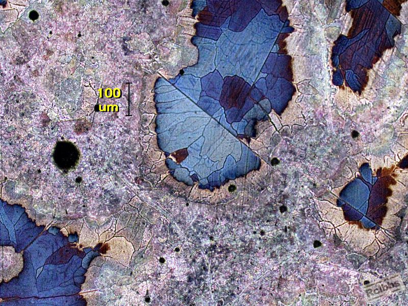

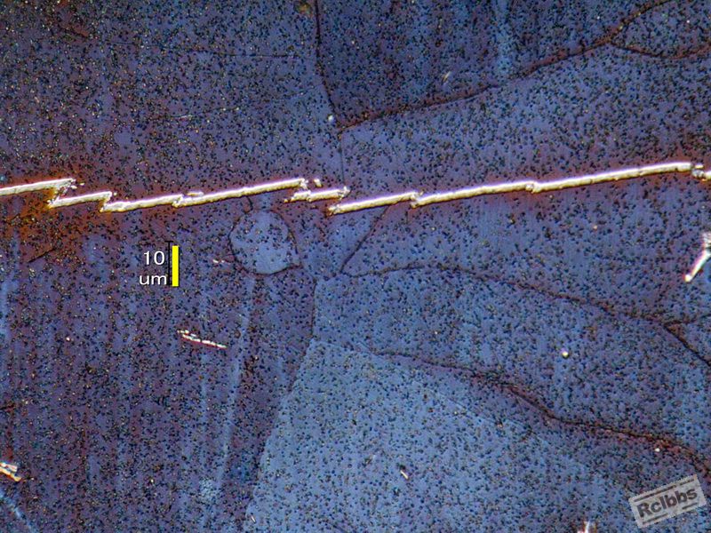

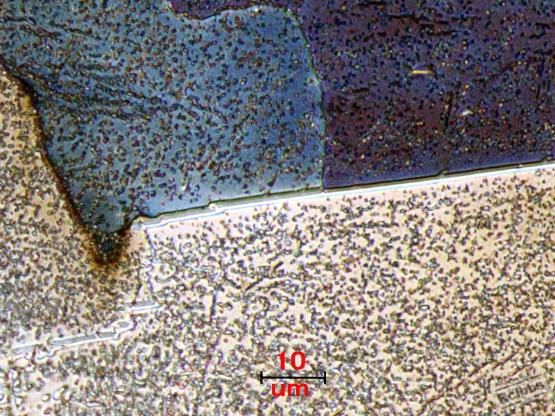

Twin boundary carbide
今天又照了些彩蝕的........................

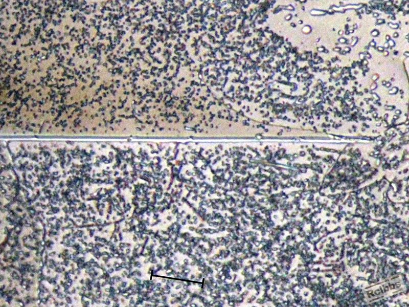

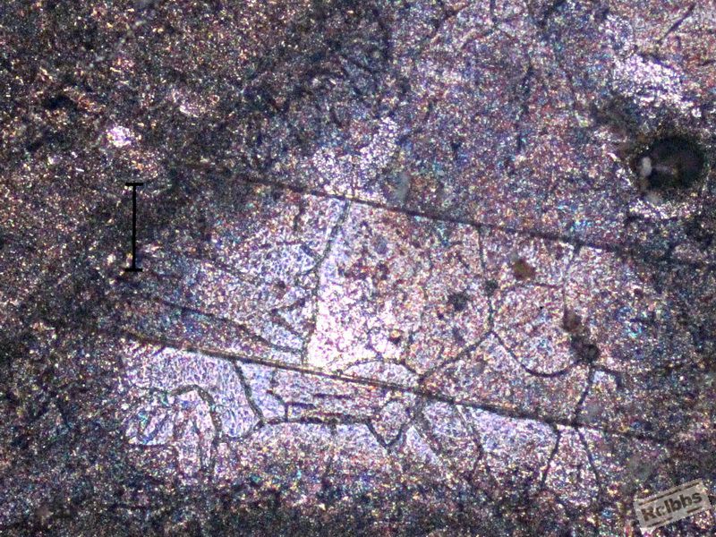

 楼主| 发表于 2016-7-29 22:27:18 | 显示全部楼层

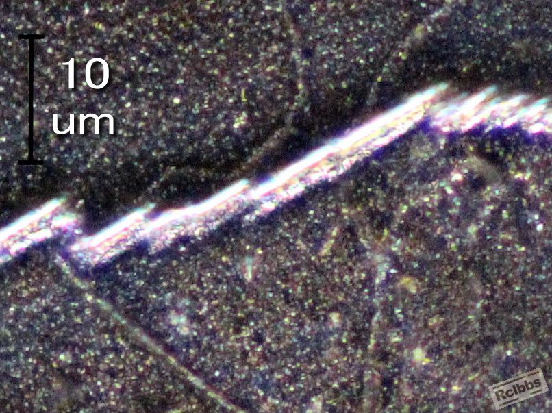

X46Cr13 tooling failed
X46Cr13   fatigue fracture surface....................
Tooling failed in a few  weeks. So, customer sent it back for complaint.
签到天数: 474 天
 楼主| 发表于 2016-7-29 22:33:41 | 显示全部楼层

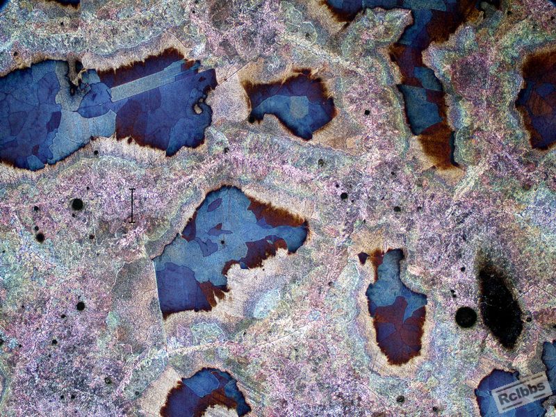

Microstructure  of this tooling.
Lots and lots of twin and grain boundary carbides which are
very detrimental to the toughness of any tool steel. These carbides appeared
after billet forging. But the problem originated from a poor diffusion annealing, or, soaking
of the ingot.
