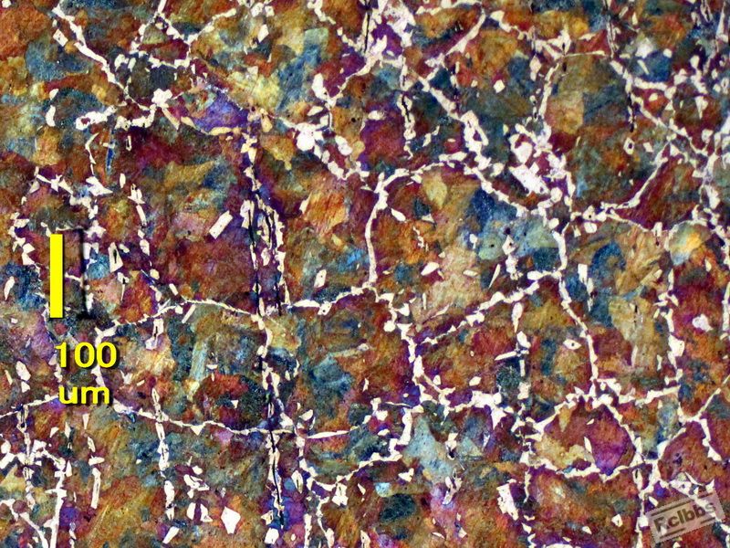

leomet 发表于 2015-4-14 18:09
平衡冷卻(爐冷)才會有此關係. Right? 空冷不遵循 lever rule.
我這試片隨便撿來的, 沒求證成份. 不要太認 ...
3Q   凑字~~~~~~~~~~~~~~~~~

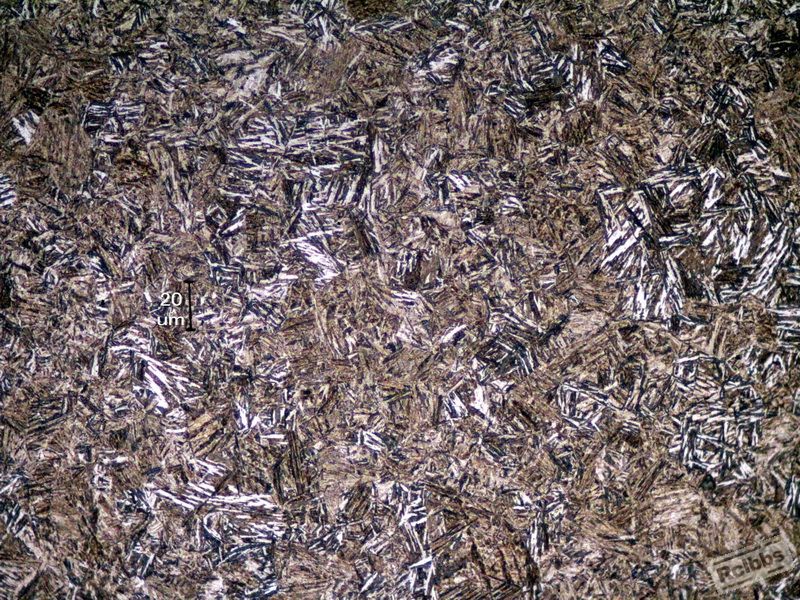

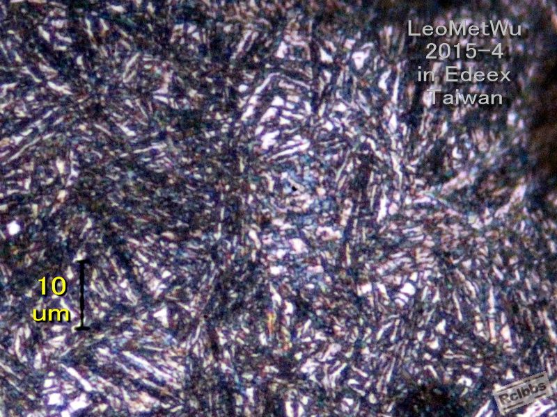

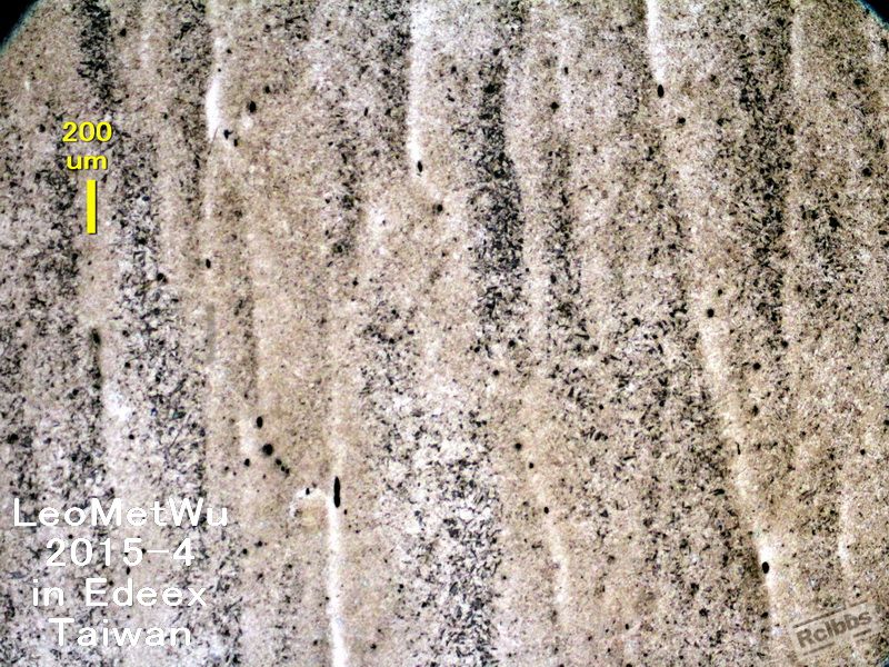

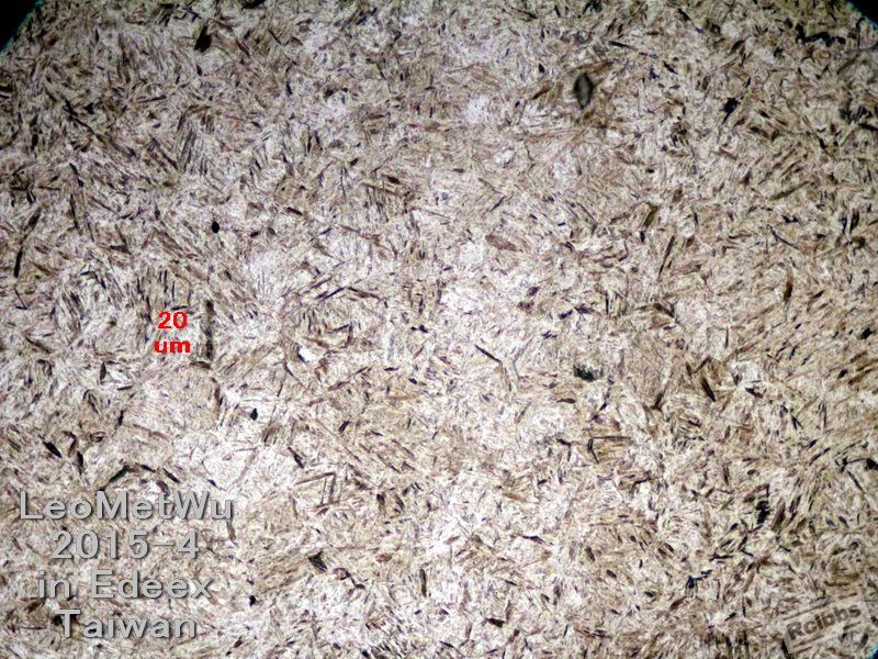

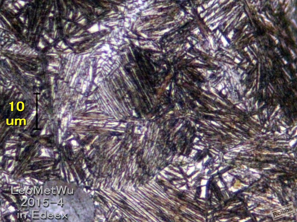

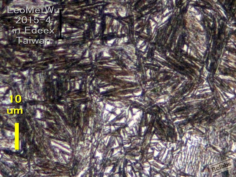

AISI 4340, 880Cx70min, as-quenched.
签到天数: 474 天
 楼主| 发表于 2015-4-25 19:03:28 | 显示全部楼层

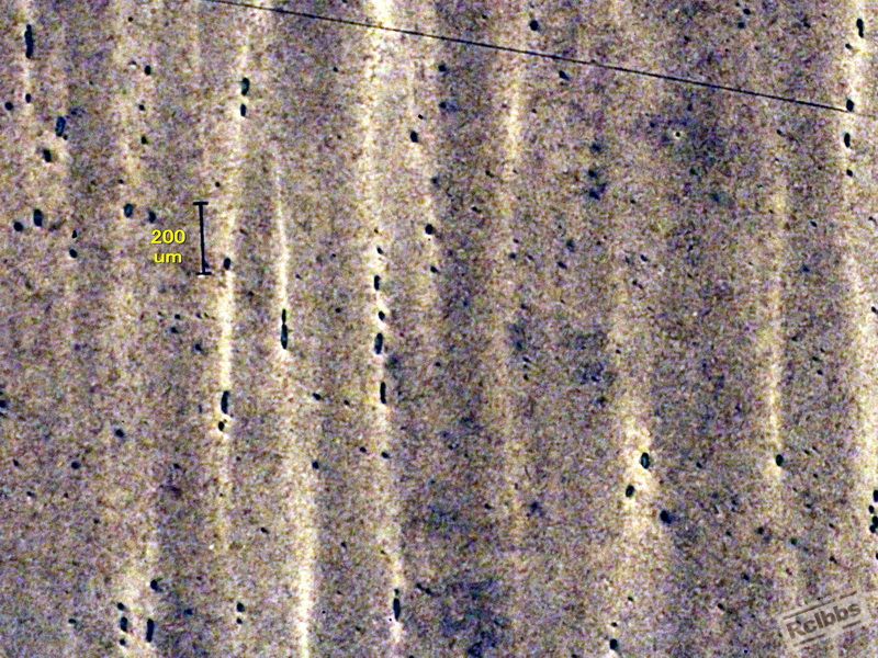

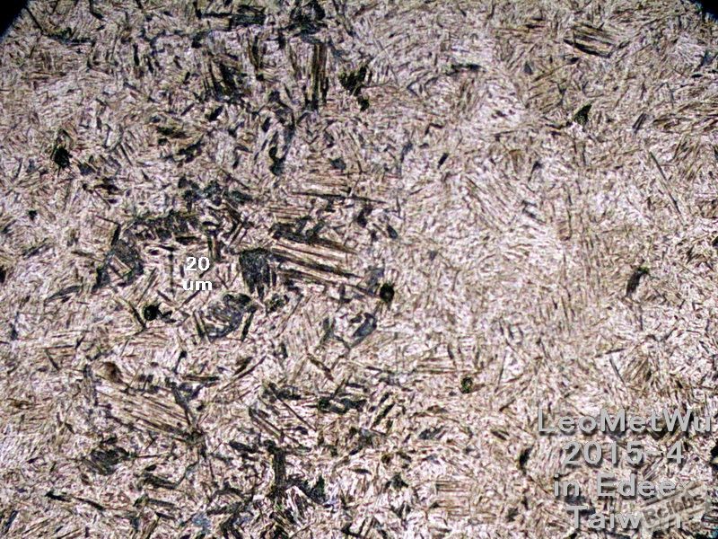

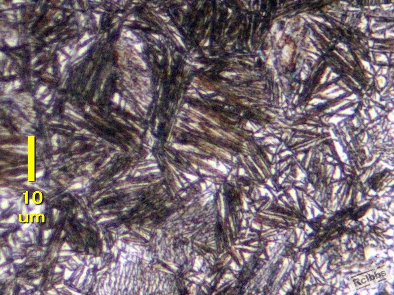

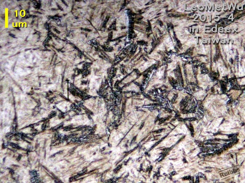

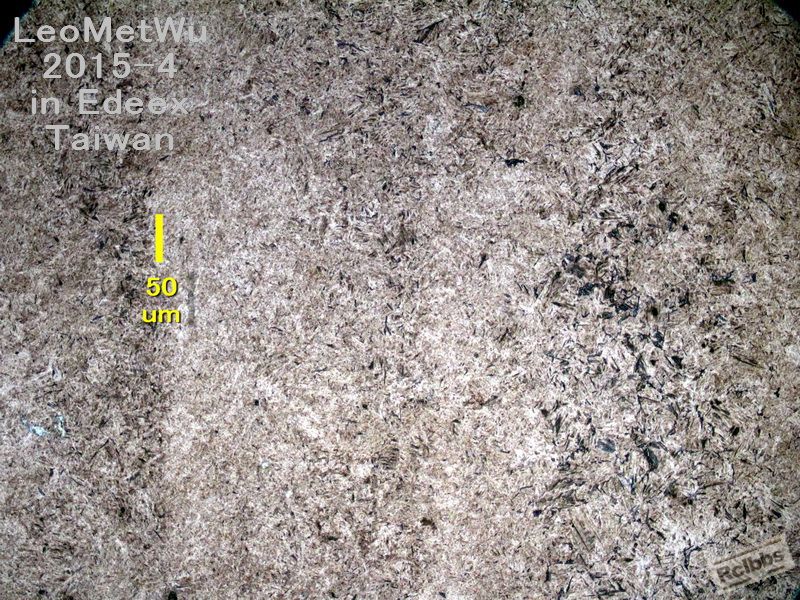

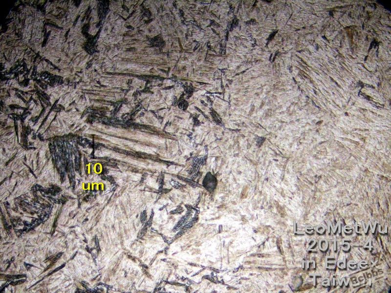

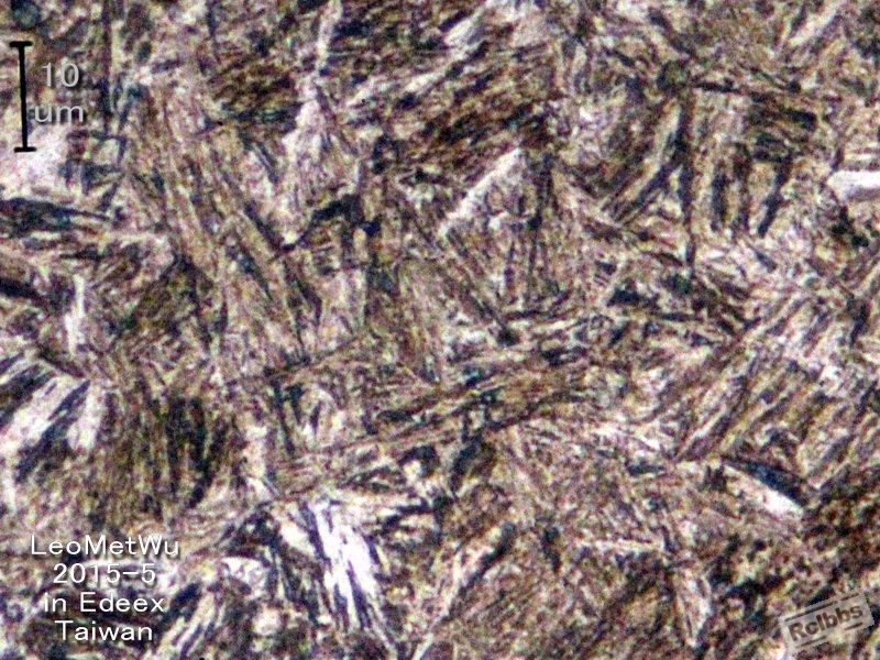

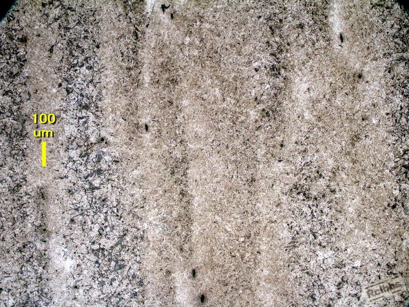

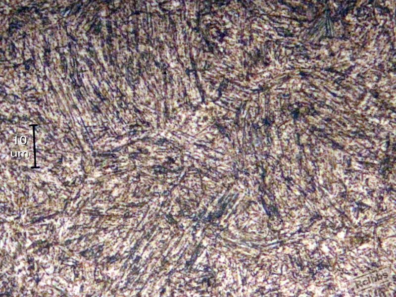

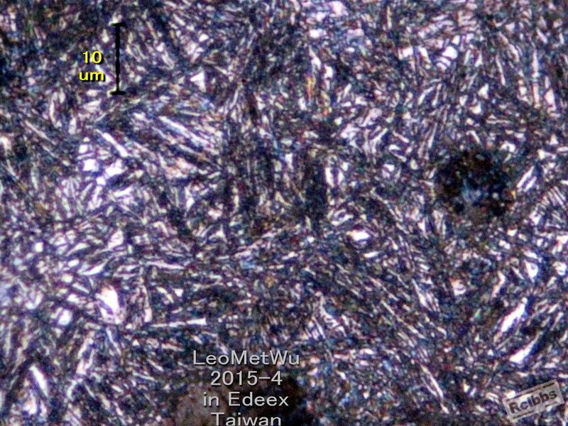

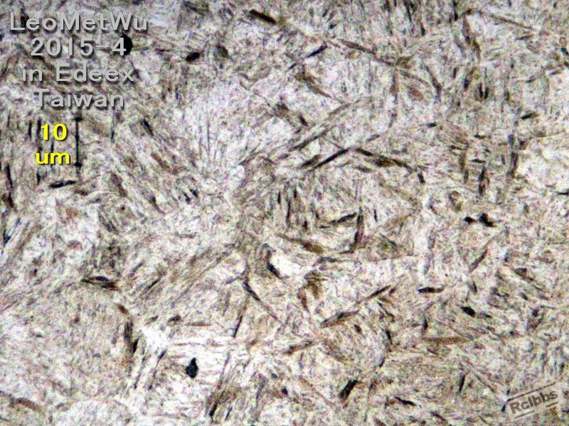

To study the % of non-M remained.
The non-M appears at the sites which were
Ferrite (solute-poor) bands before Austenization.
黑點為非M
黑點為非M

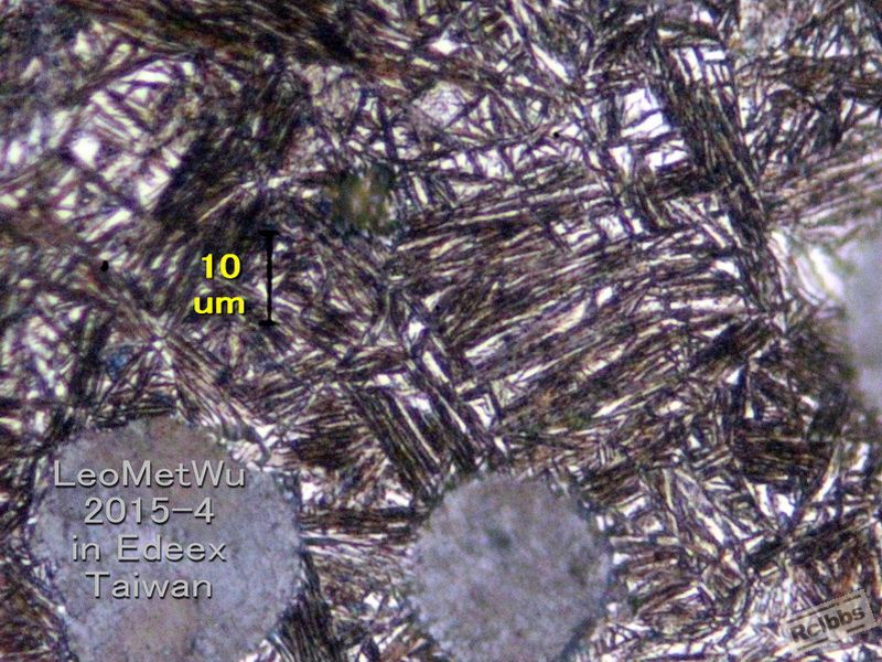

Austempered Ductile Iron
The high toughness of ADI comes from the finely interweaving of its L.B.(hard phase) and Austenite(soft phase).
You can imagine how difficult it is for a crack to travel through a matrix like this.

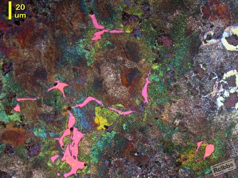

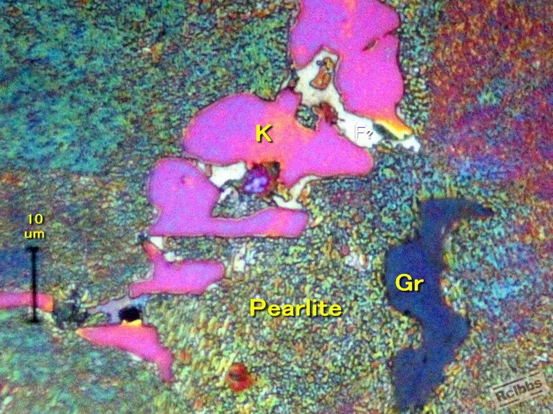

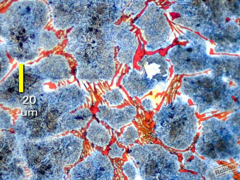

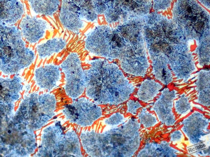

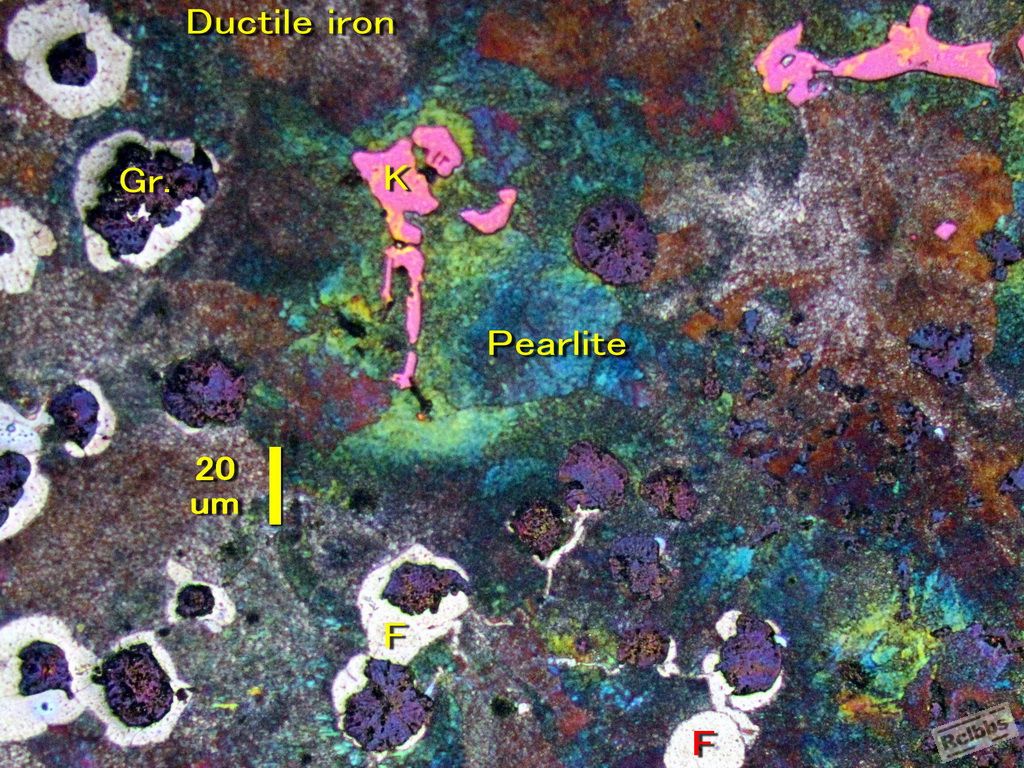

Ductile iron. Carbide + graphite in the matrix of Pearlite.
Carbide tinted pink.
Gr = Graphite = 石墨
Gr = Graphite = 石墨

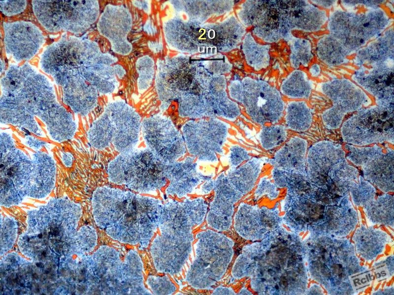

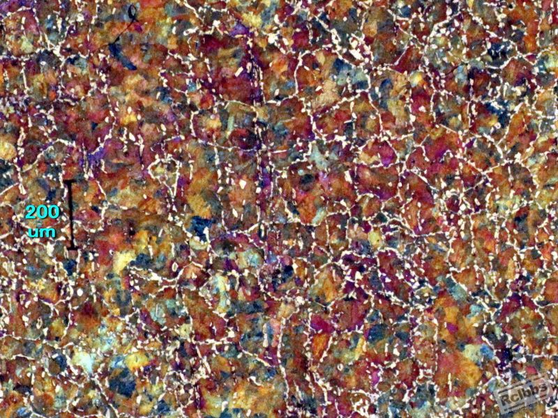

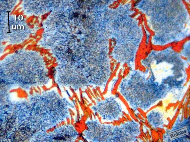

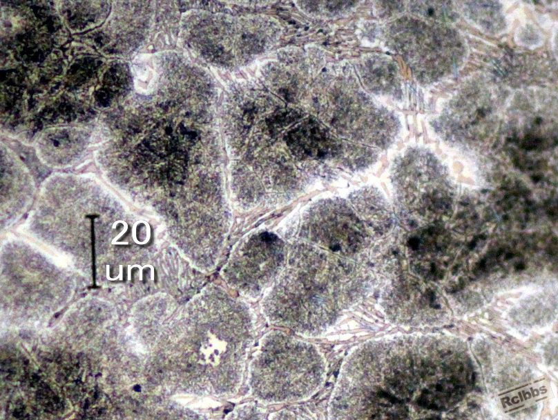

M2 HSS, as-cast condition.
彩蝕 前
彩蝕 前

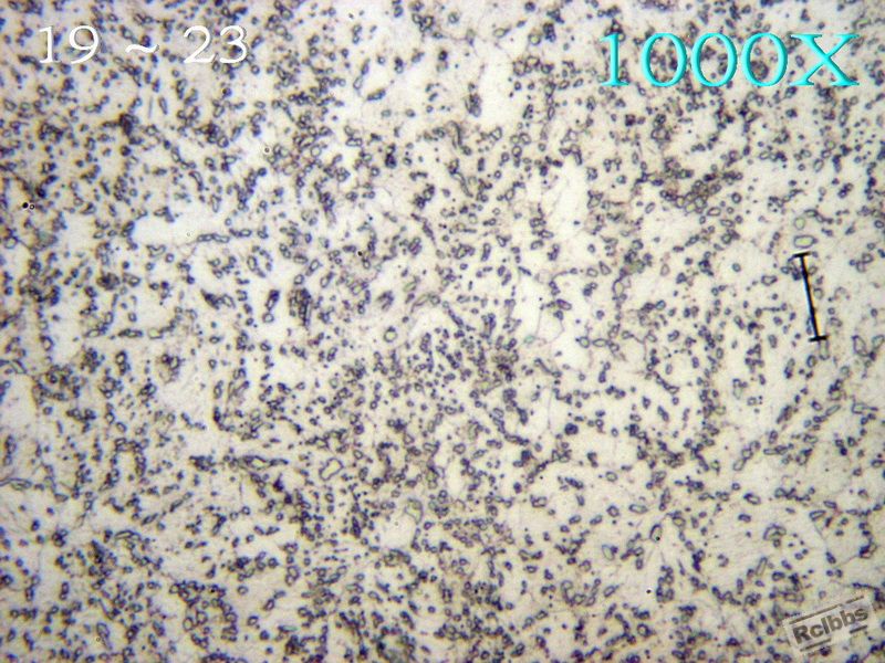

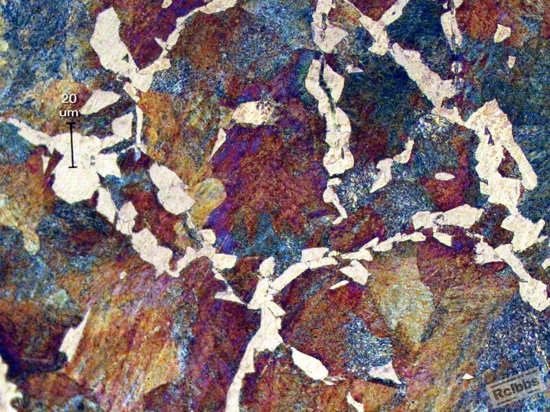

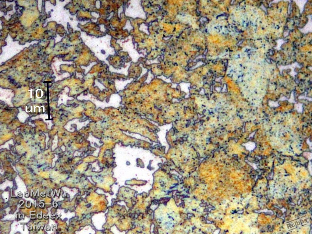

S45C;  750C 淬後 HRC 25;  550C回 HRC 14

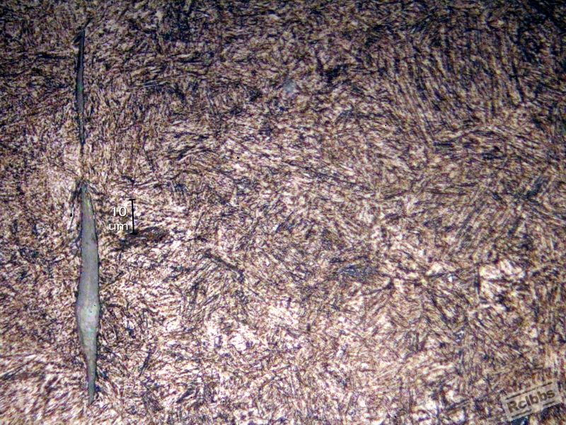

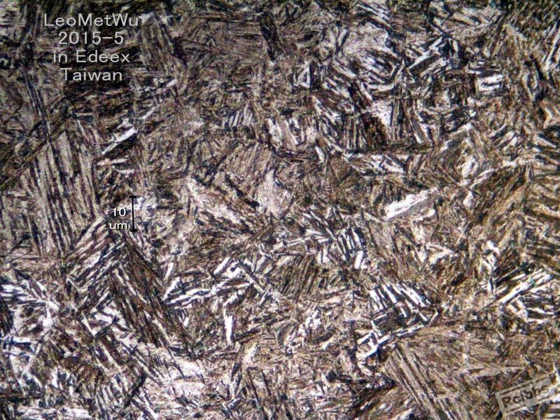

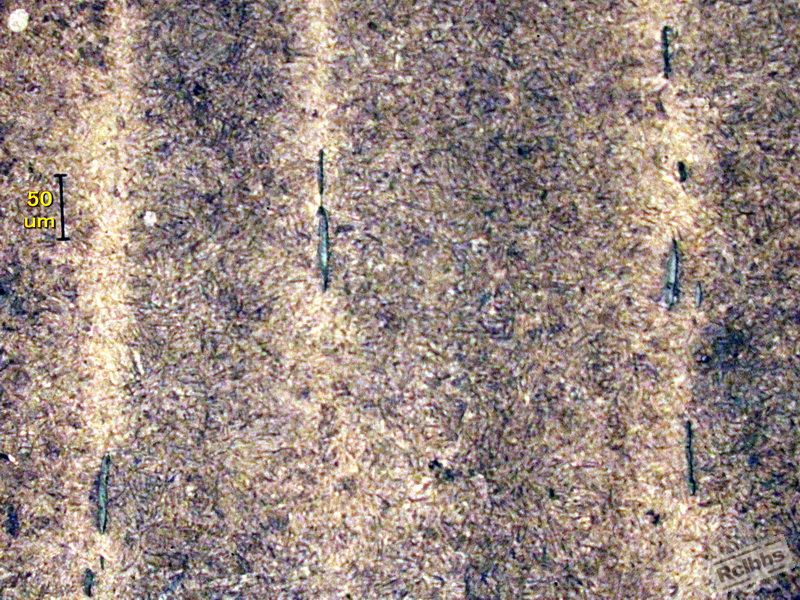

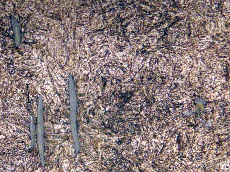

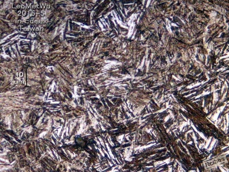

SCM 440 Austempered structure
夾雜物多了些.......................................................

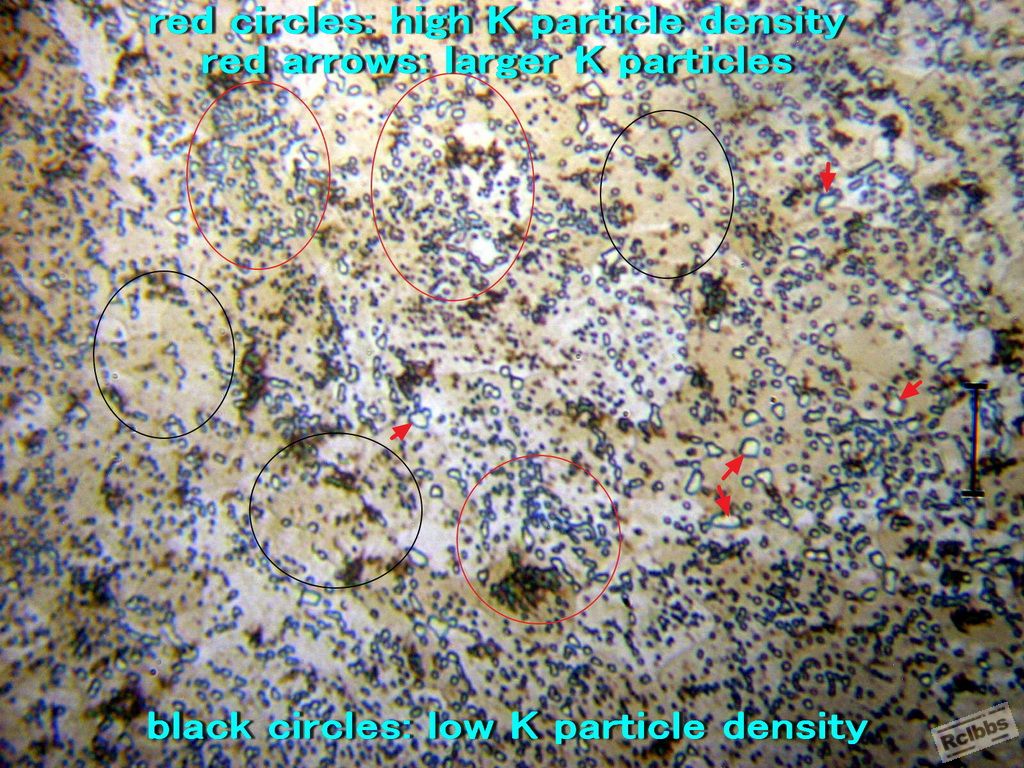

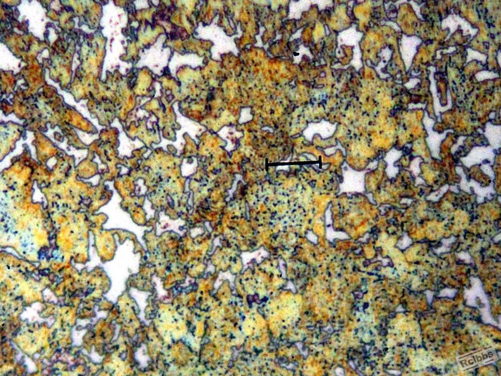

S35C  球粒化......................

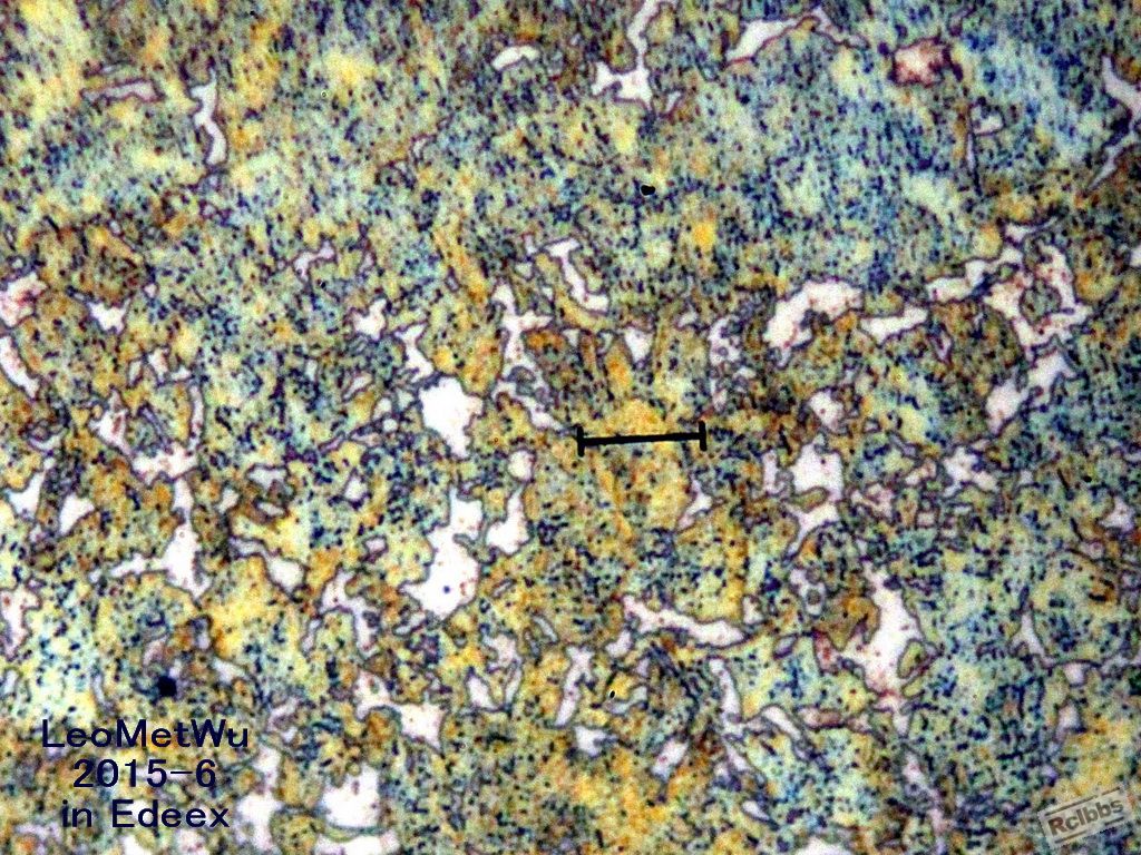

S45C 調質...........過頭了就成了球粒化退火.

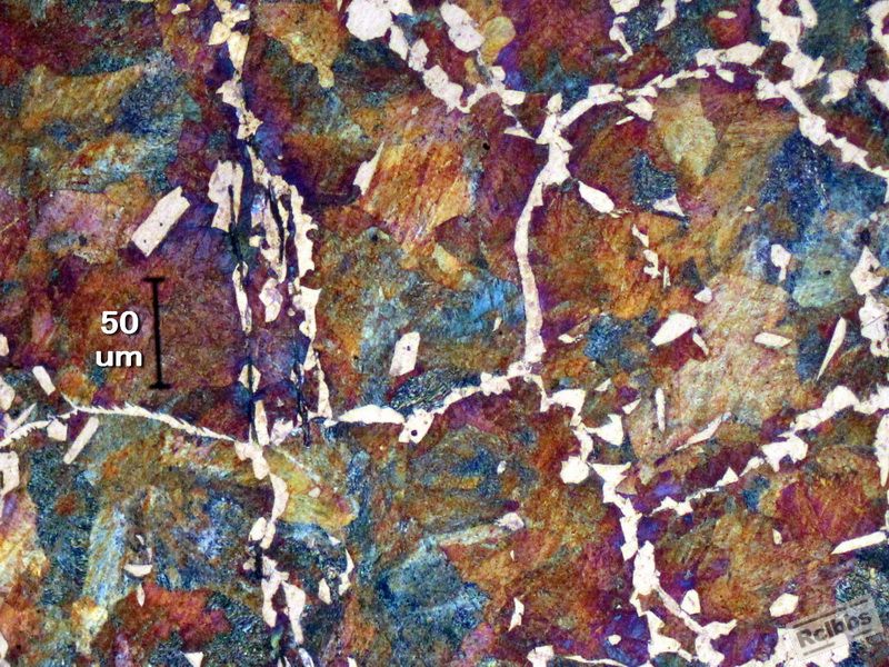

Colorful and beautiful !

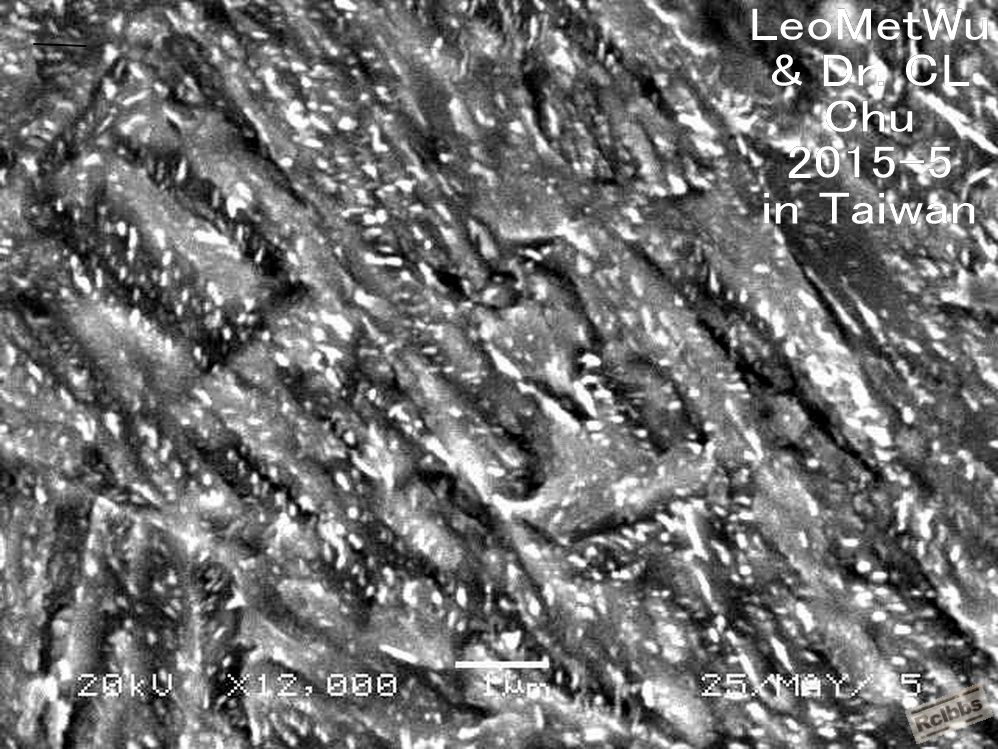

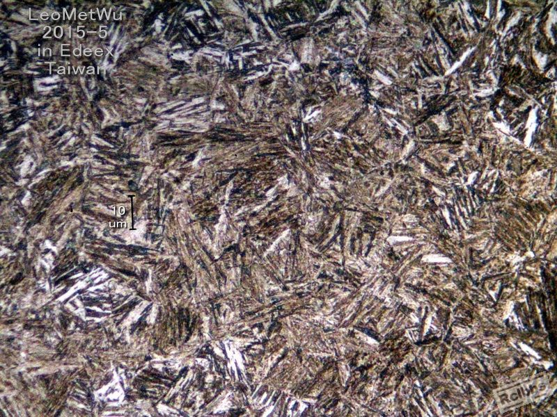

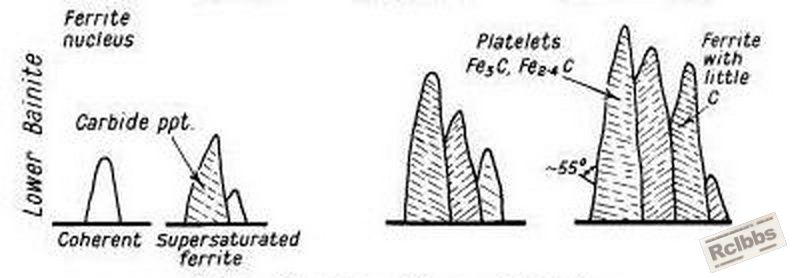

Lower Bainite 的 碳化物超微粒.
They say I am the best metallurgist in Taiwan. I'd say I am one of the best, and the oldest metallurgist in Taiwan.
No other people in Taiwan still doing the grinding and polishing work at the age of 64. Poor me? Lucky me?
OM at 1000X
OM at 1000X
SEM at 12000X
SEM at 12000X
submicroscopic K of lower Bainite
