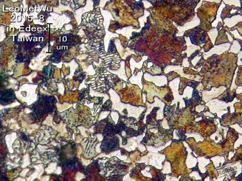

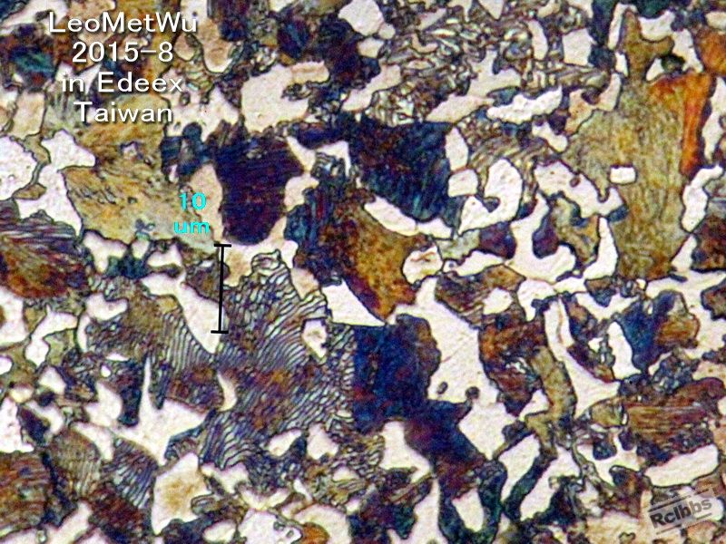

 楼主| 发表于 2015-8-7 08:48:03 | 显示全部楼层

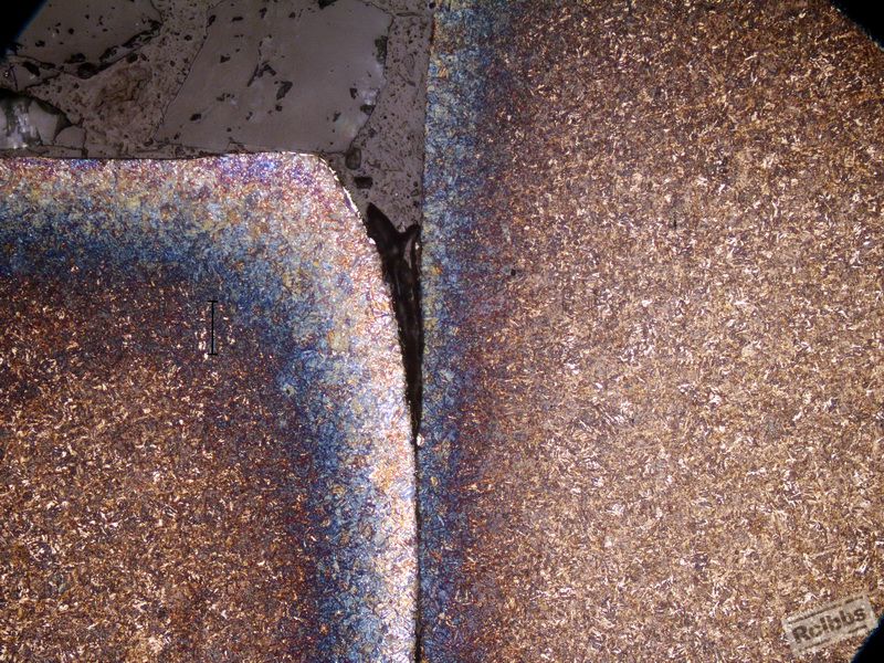

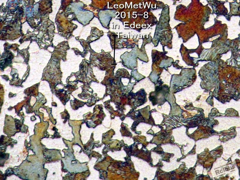

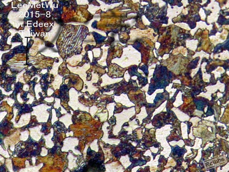

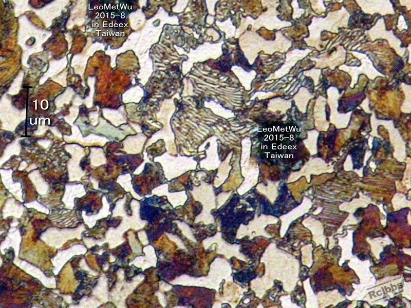

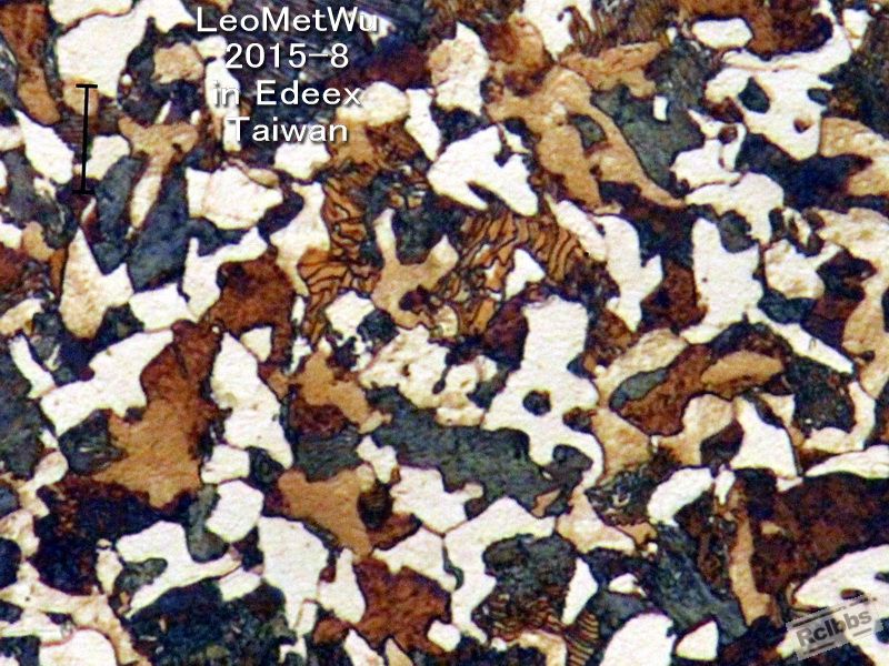

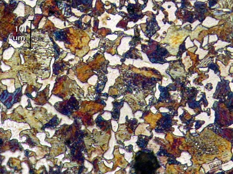

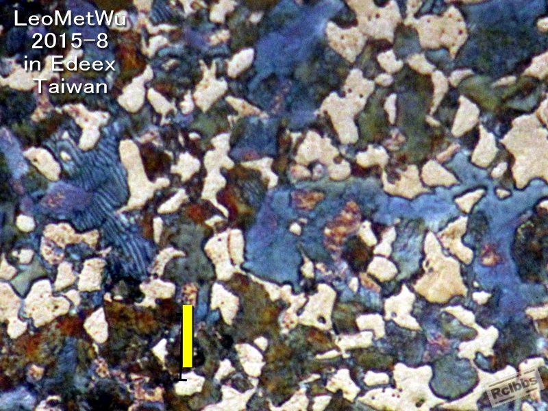

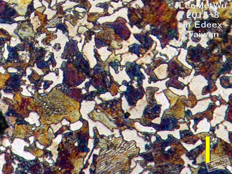

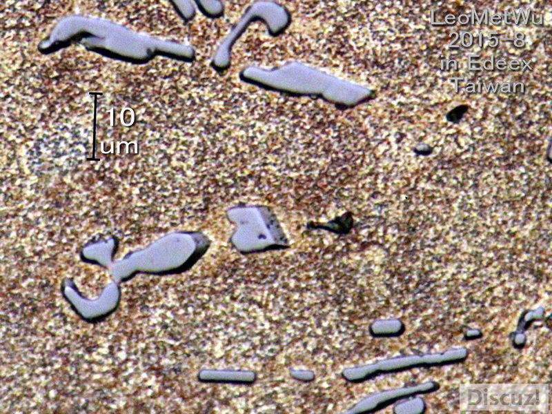

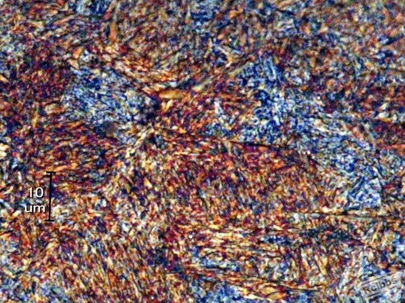

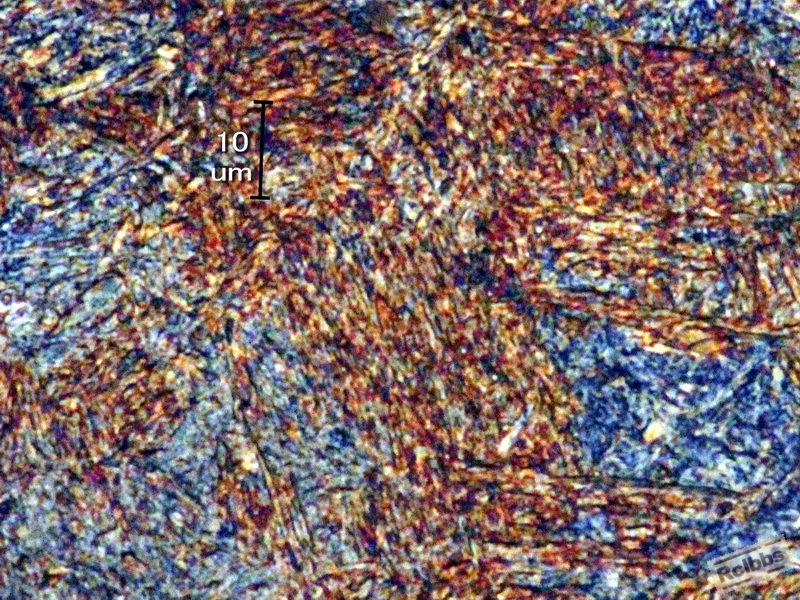

上面是S50C, Austempered. 這個也是, 彩蝕後如下:

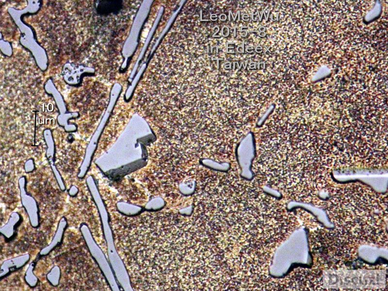

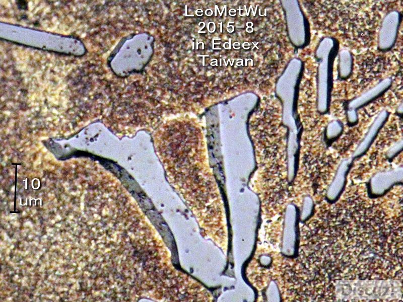

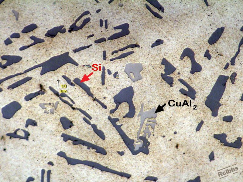

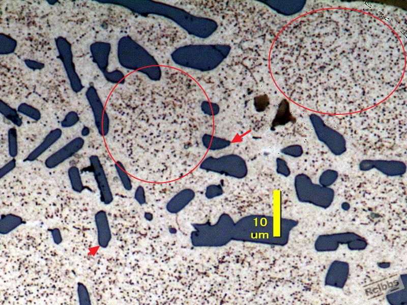

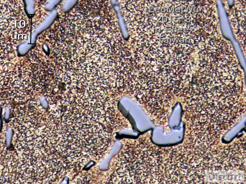

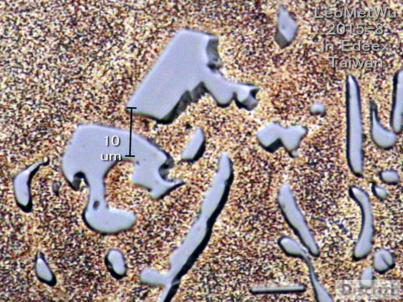

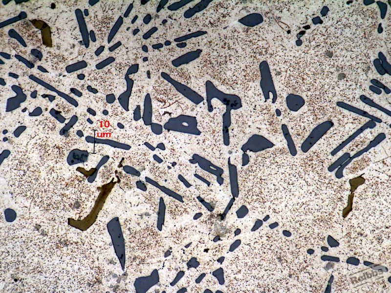

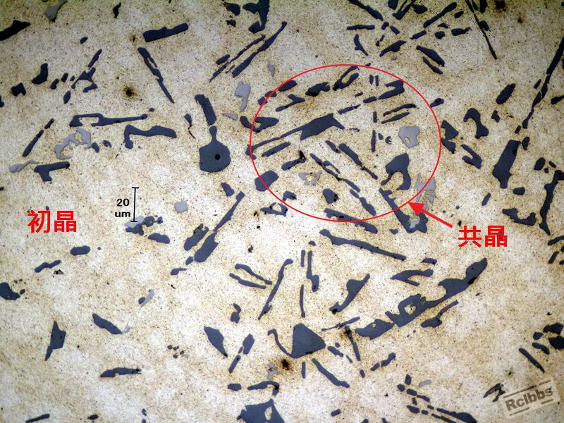

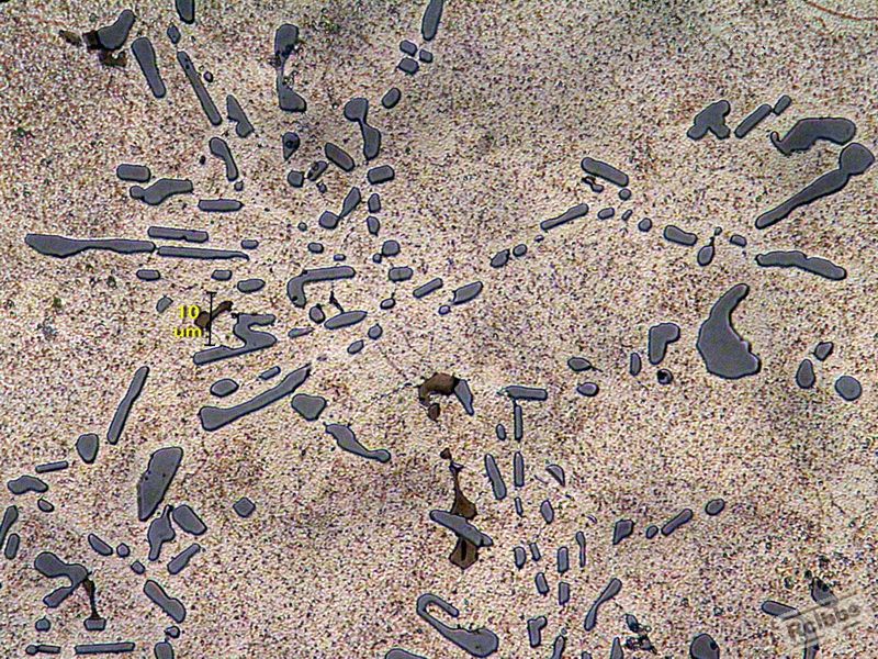

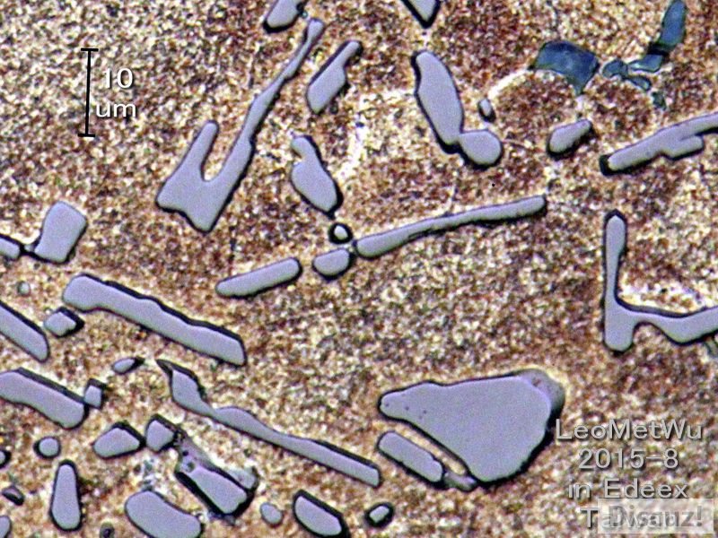

亞共晶 鑄鋁 hypo-eutectic cast aluminum alloy for engine block

稍重蝕. Si 顆粒凸出基地. 像不像沙灘上的石塊?

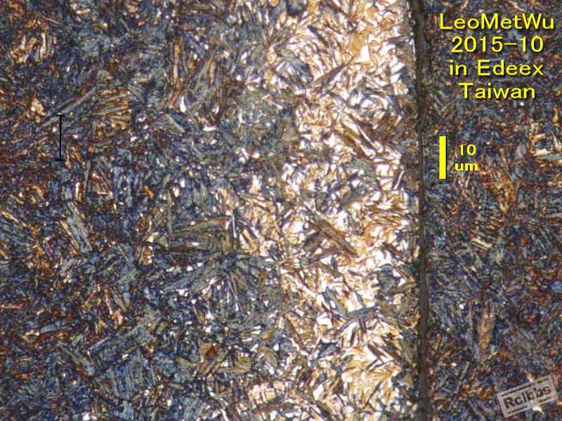

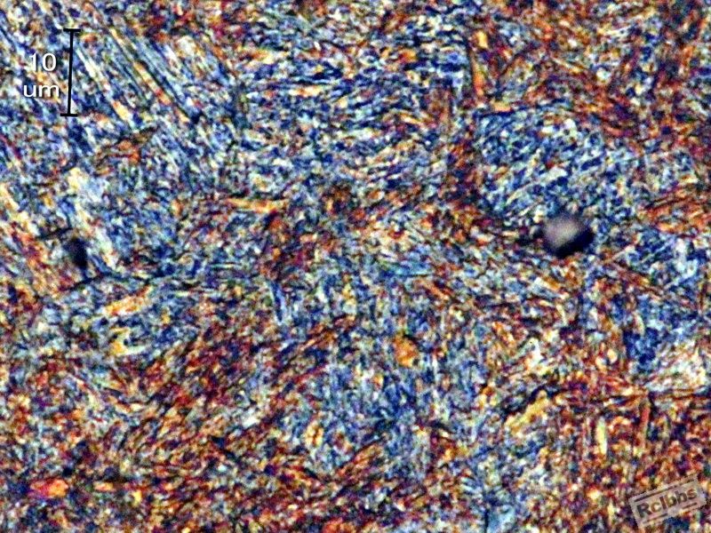

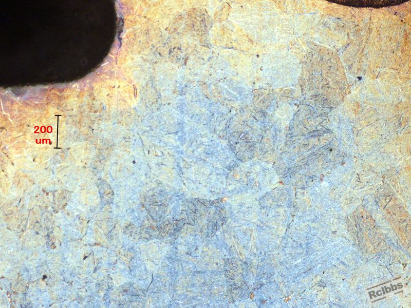

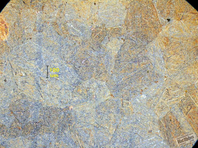

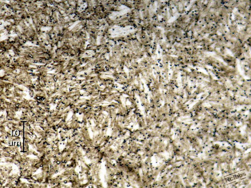

Bearing steel, 52100, SUJ 2, Austenized at 1150C and Q and T.
Heating at such a high temp purposely to obtain coarse grains for easier photo taking.
Fully Martensitic structure.
参与人数 1热处理币 +10 贡献值 +10 收起 理由
gtn1314 + 10 + 10 感谢上传!
签到天数: 474 天
 楼主| 发表于 2015-8-29 11:26:12 | 显示全部楼层

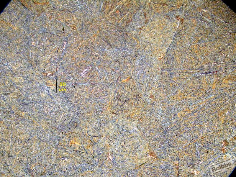

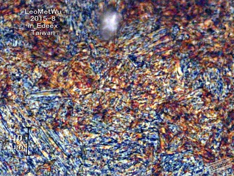

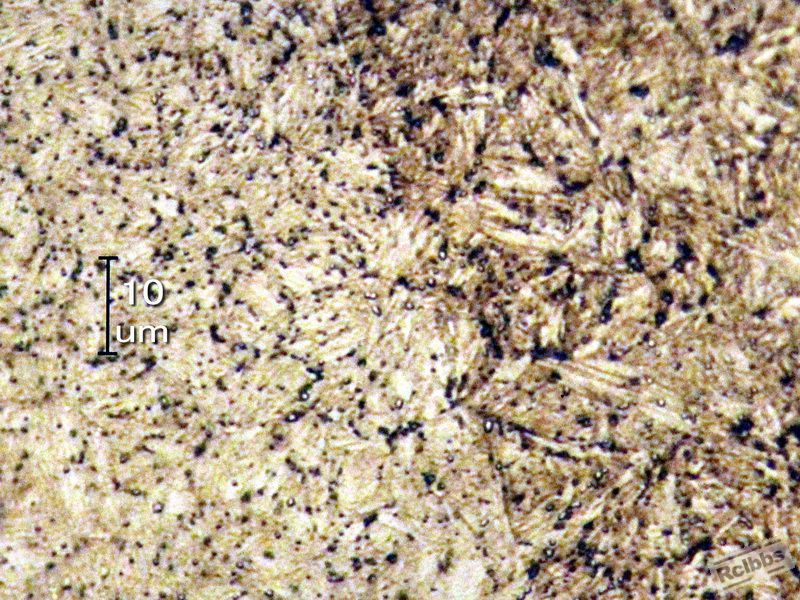

 楼主| 发表于 2015-8-29 11:37:10 | 显示全部楼层

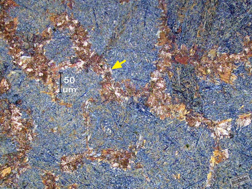

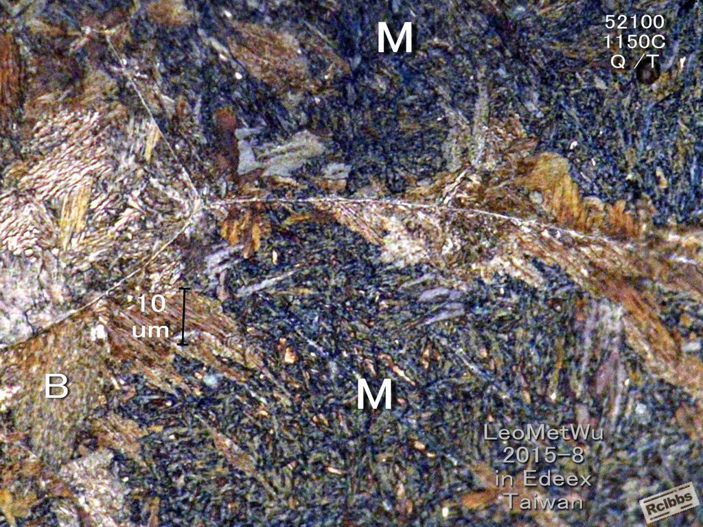

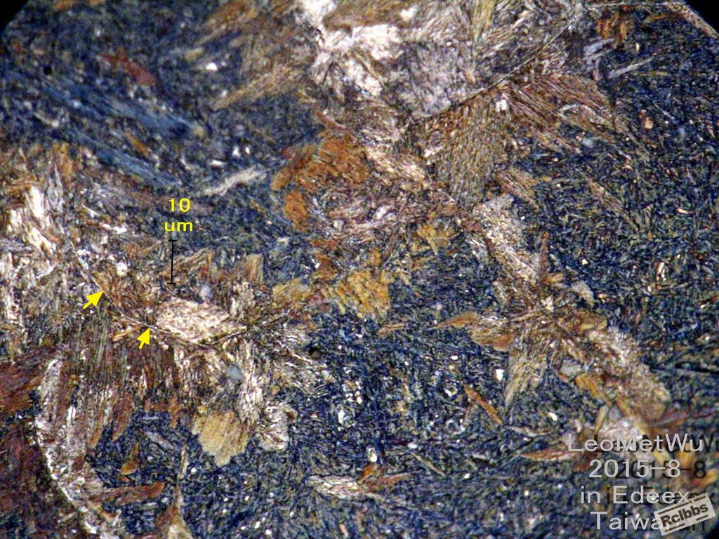

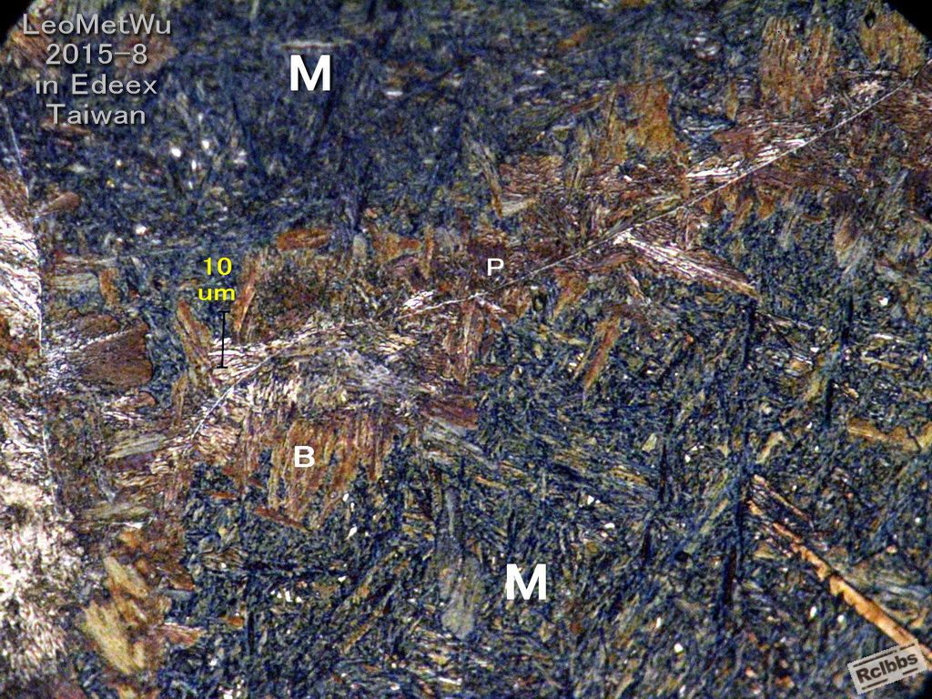

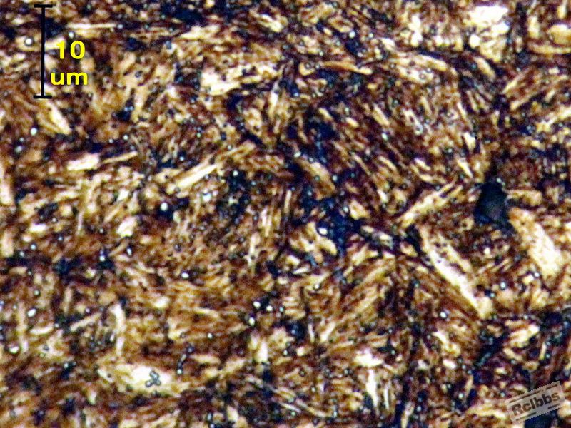

52100, 這個是冷速不足的試片. 晶界有非M出現.
签到天数: 474 天

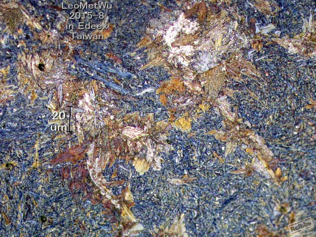

 楼主| 发表于 2015-8-29 11:37:11 | 显示全部楼层

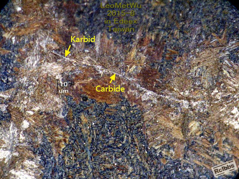

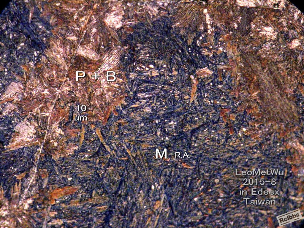

52100是過共析鋼, 所以最早出現在晶界的是Carbide, 再來是 P and B. 這些都叫 "非M". ---non-Martensitic

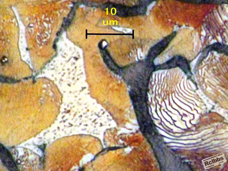

 楼主| 发表于 2015-9-13 19:15:23 | 显示全部楼层

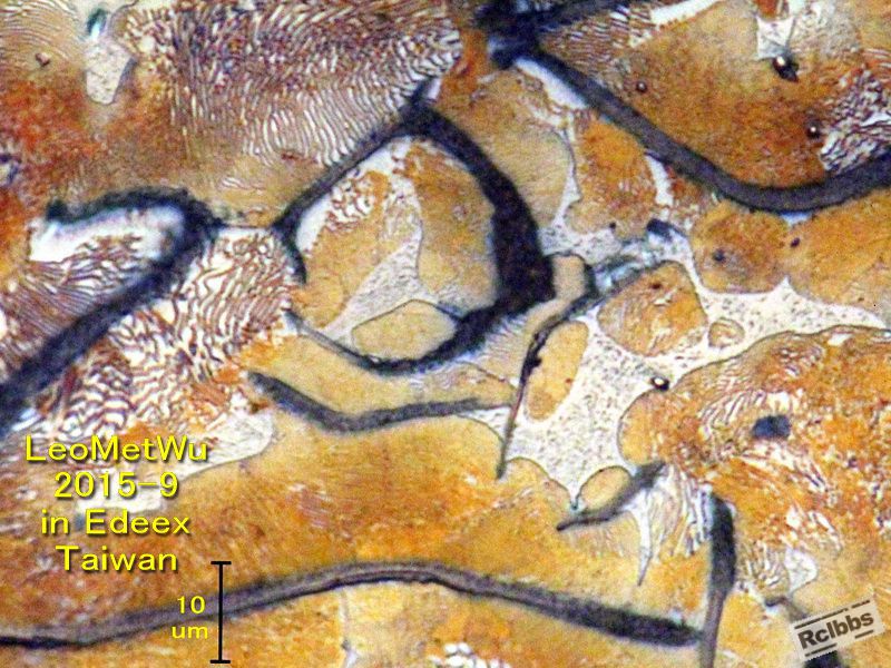

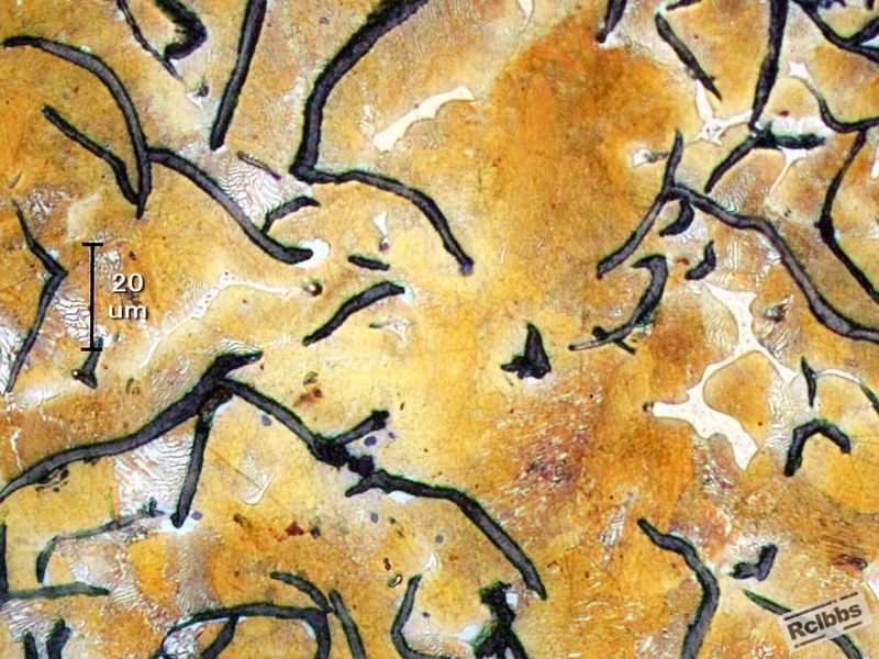

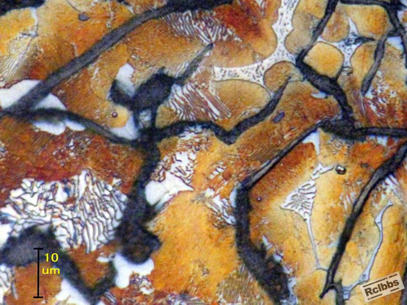

cylinder liner 金相.............
签到天数: 474 天
Steadite in gray iron

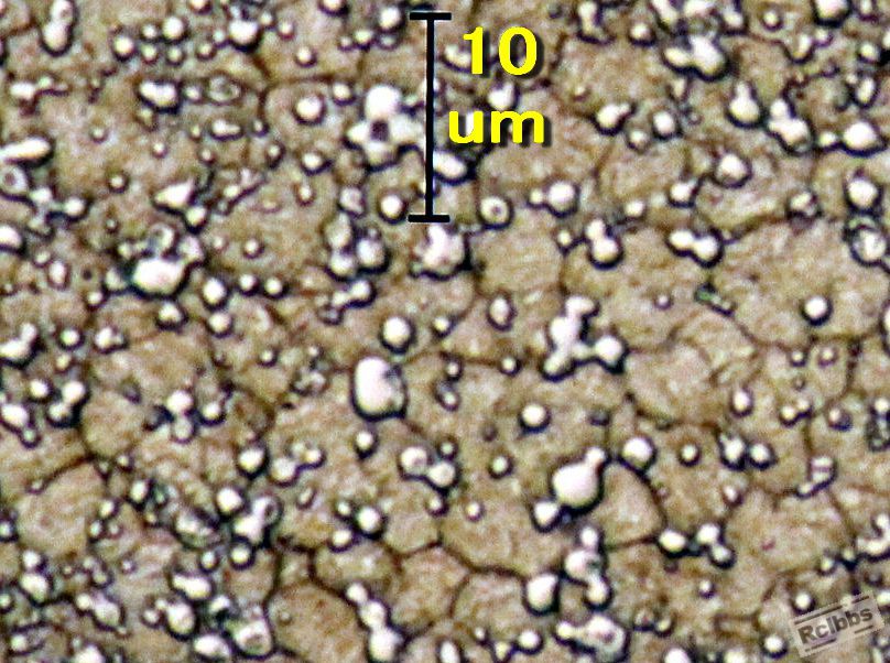

 楼主| 发表于 2015-9-13 19:23:04 | 显示全部楼层

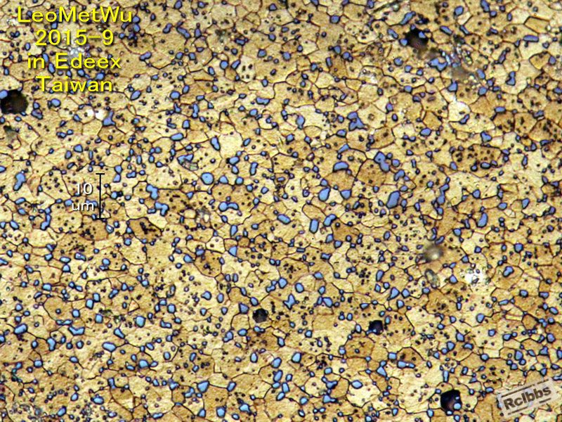

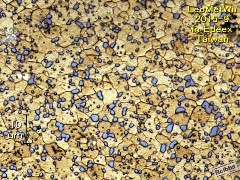

0.60%C steel for coldworking.
Spheroidized carbide particles in the matrix of Ferrite.
Note the fine grain size of Ferrite.
签到天数: 474 天

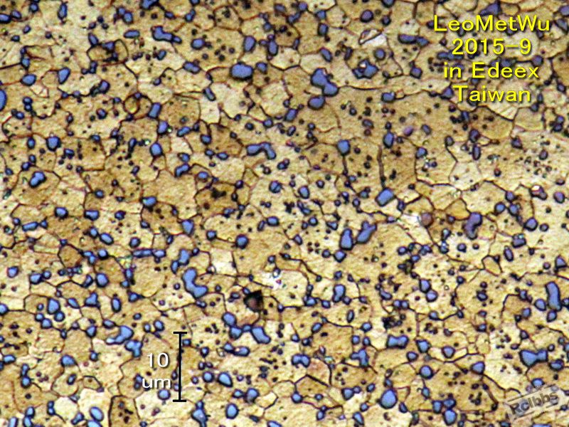

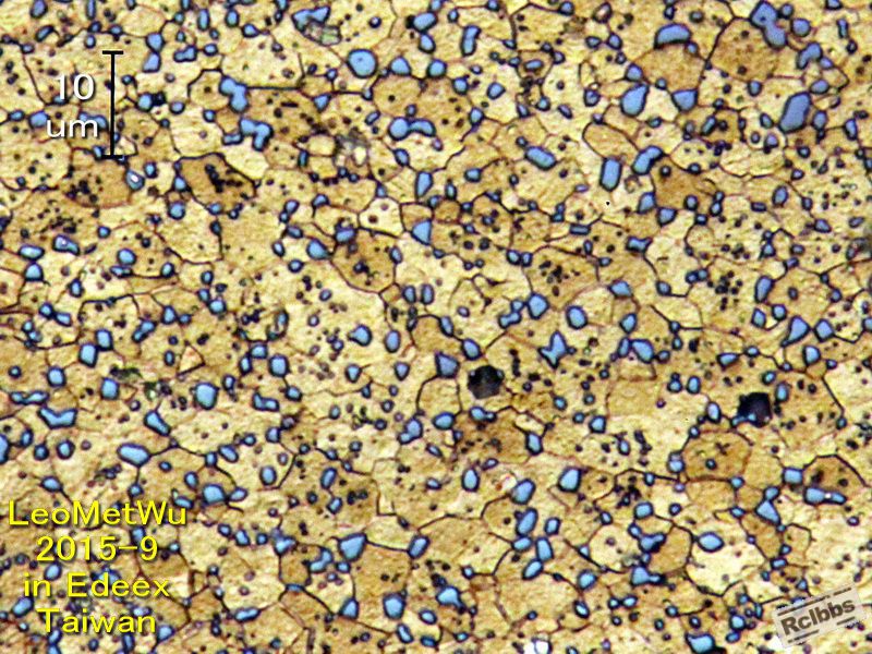

0.60%C steel for coldworking. Bicycle chain material.
Spheroidized carbide particles (tinted pale blue) in the matrix of Ferrite.
Note the fine grain size of Ferrite. << 10 um.

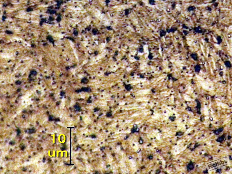

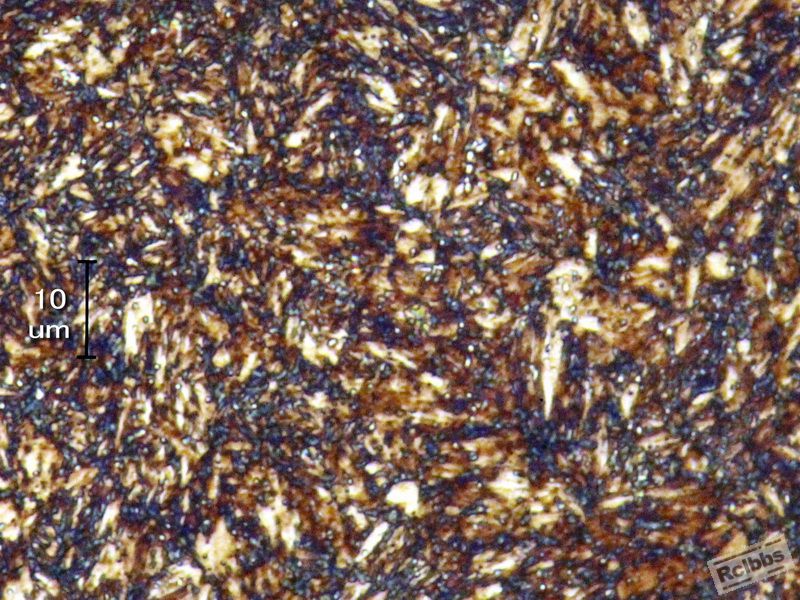

 楼主| 发表于 2015-10-4 10:56:51 | 显示全部楼层

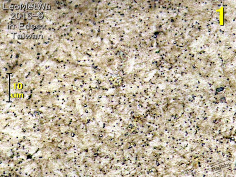

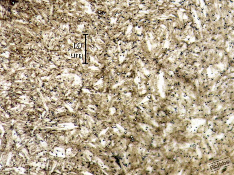

放幾張H13 Q/T 輕蝕照片
Carbide particles dispersed in the matrix of tempered Martensite.
This matrix- type hotwork tool steel is well-known for its toughness.

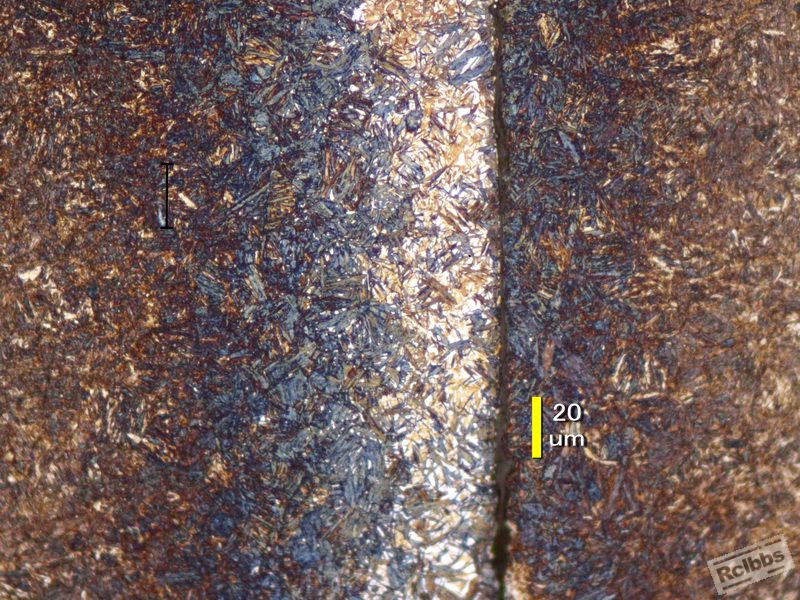

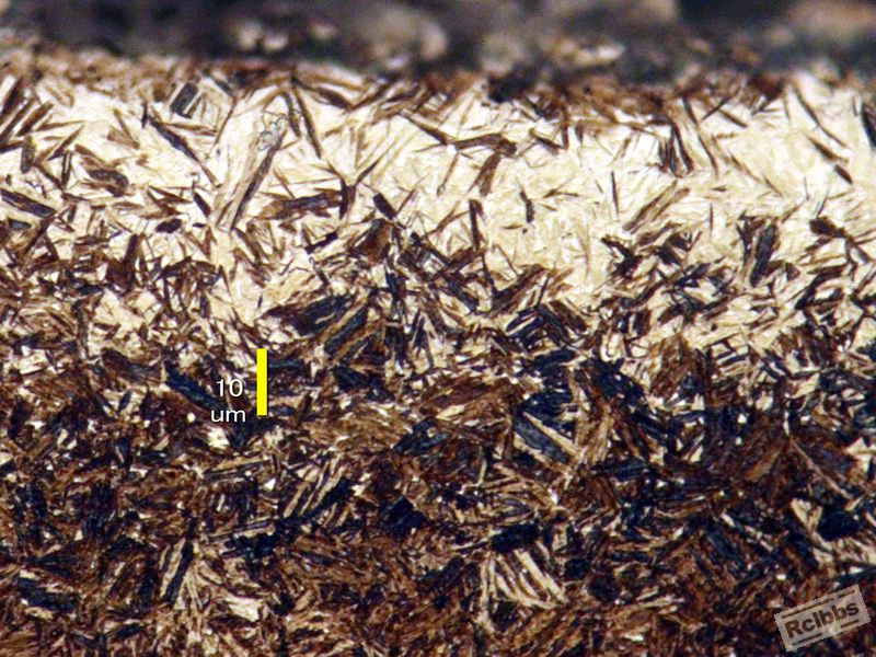

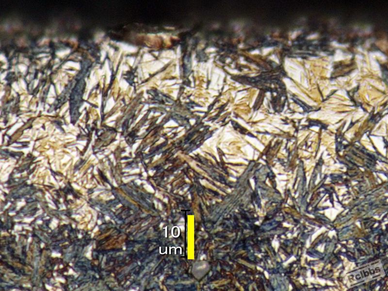

 楼主| 发表于 2015-10-10 18:55:28 | 显示全部楼层

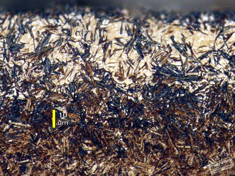

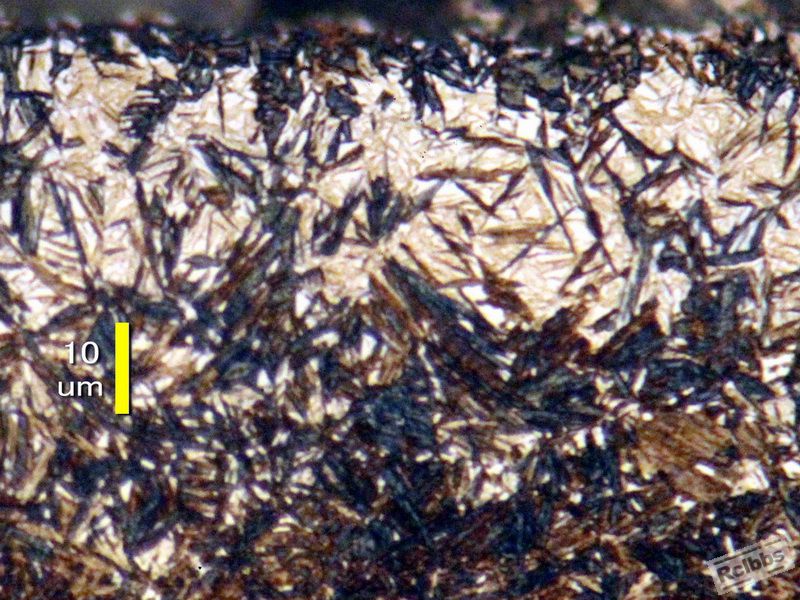

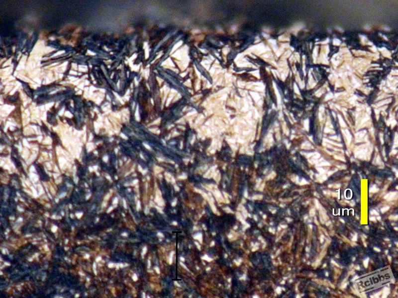

c.p. 0.8%; 870Cx30min; quenched in salt bath at 280C.
Too much R.A. & untempered Martensite in the surface led to poorer strength than those with no R.A.
Workpiece? It's a hush-hush.
left: NG; right: O.K.

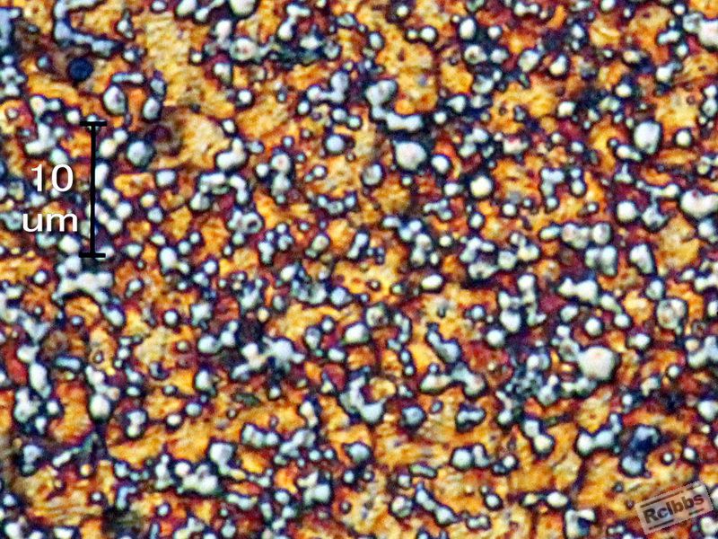

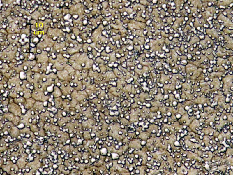

CPM 10V   P/M HS steel, Quenched, not tempered.
Coalescence of some carbide particles indicates that its Austenization temperature is a bit too high.
