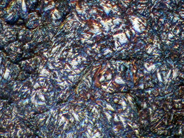

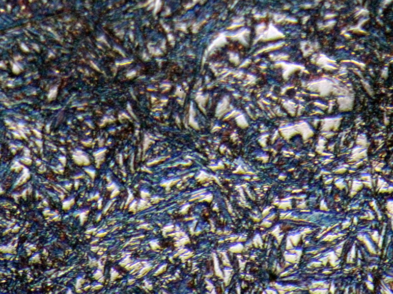

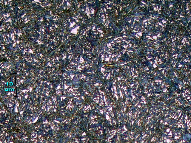

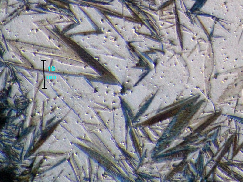

Retained Austenite in a caburized steel.
可看出RA有立体感?

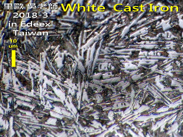

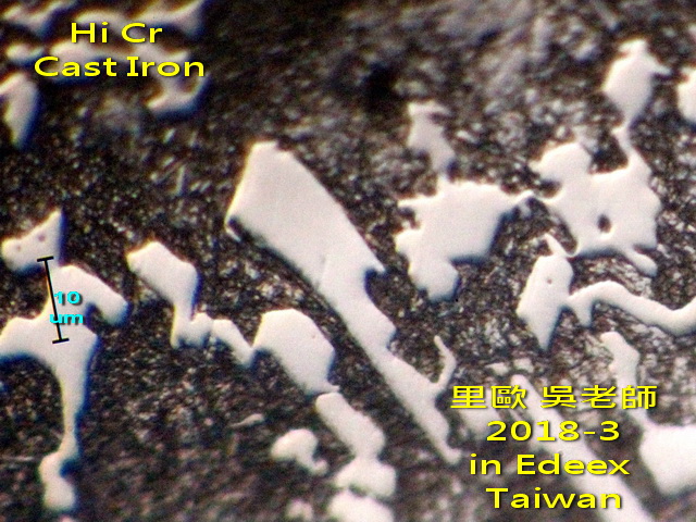

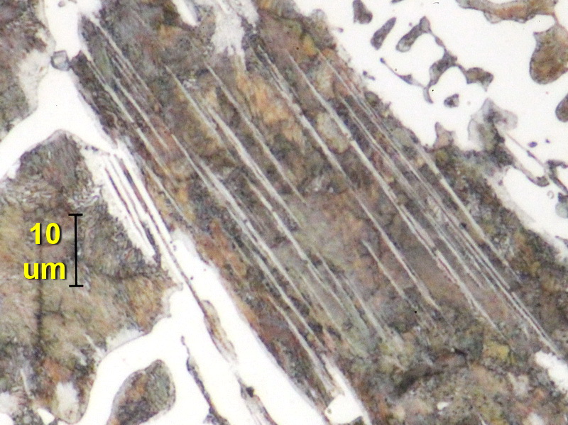

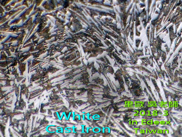

25Cr (中間兩張)  0Cr(上下兩張)  白鑄鉄  2.5D (近3D)金相照片

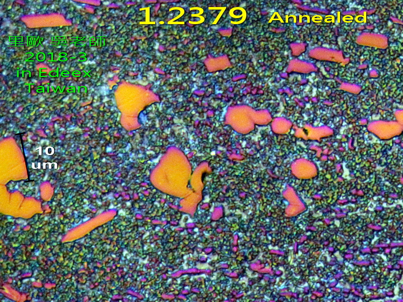

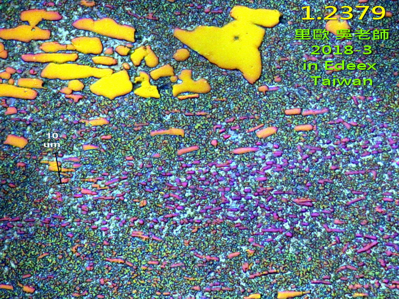

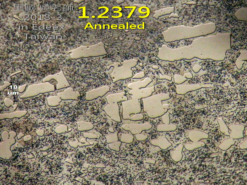

冷模工具鋼  原材料, 素材  照片欣賞
JIS SKD 11; DIN 1.2379  AISI D2

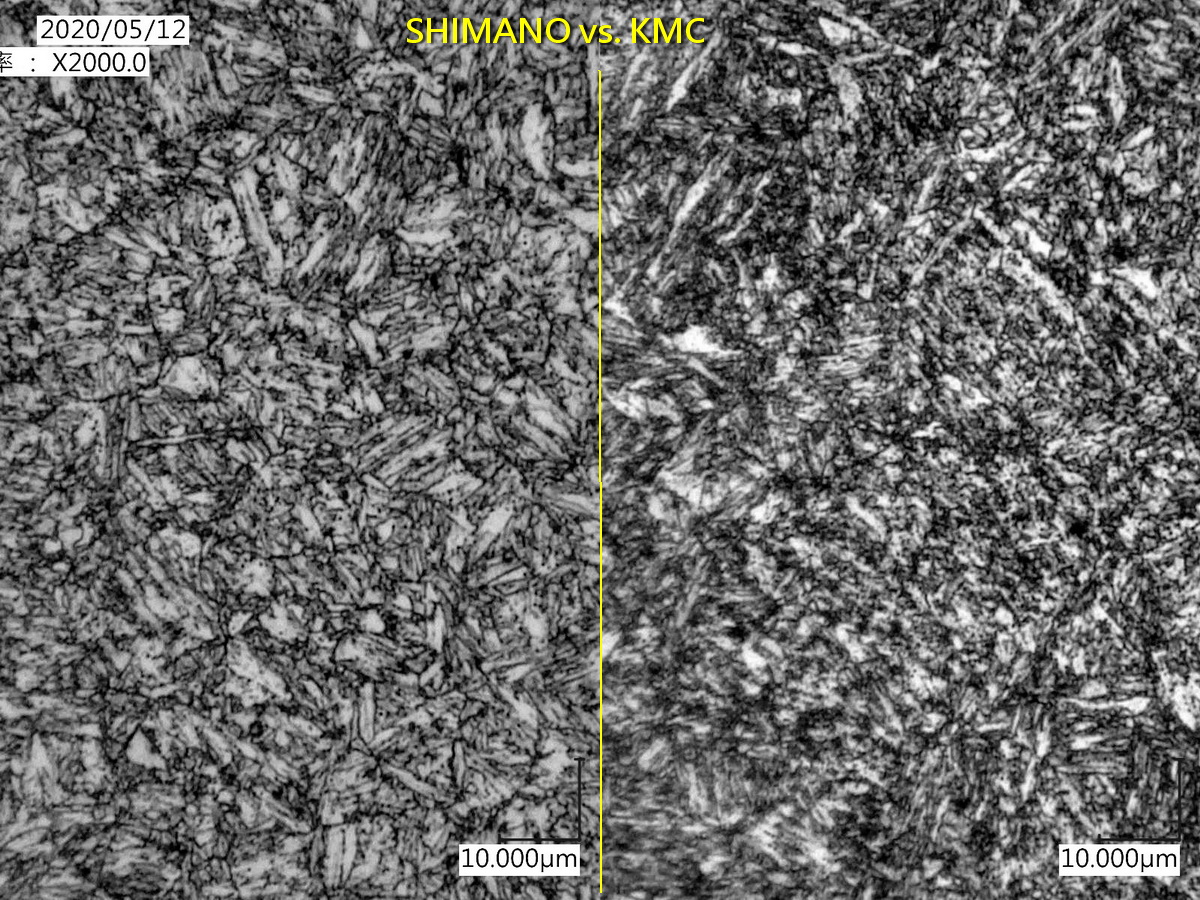

 楼主| 发表于 2020-5-14 08:29:46 | 显示全部楼层

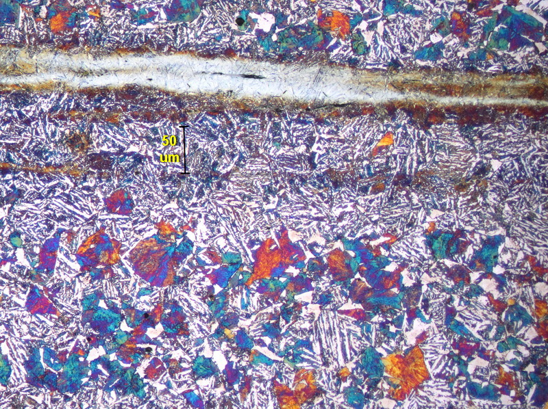

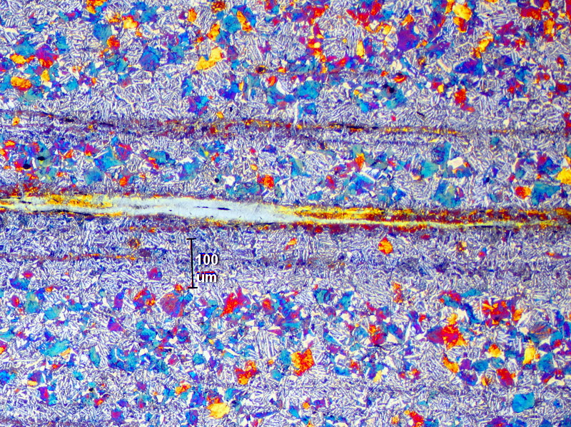

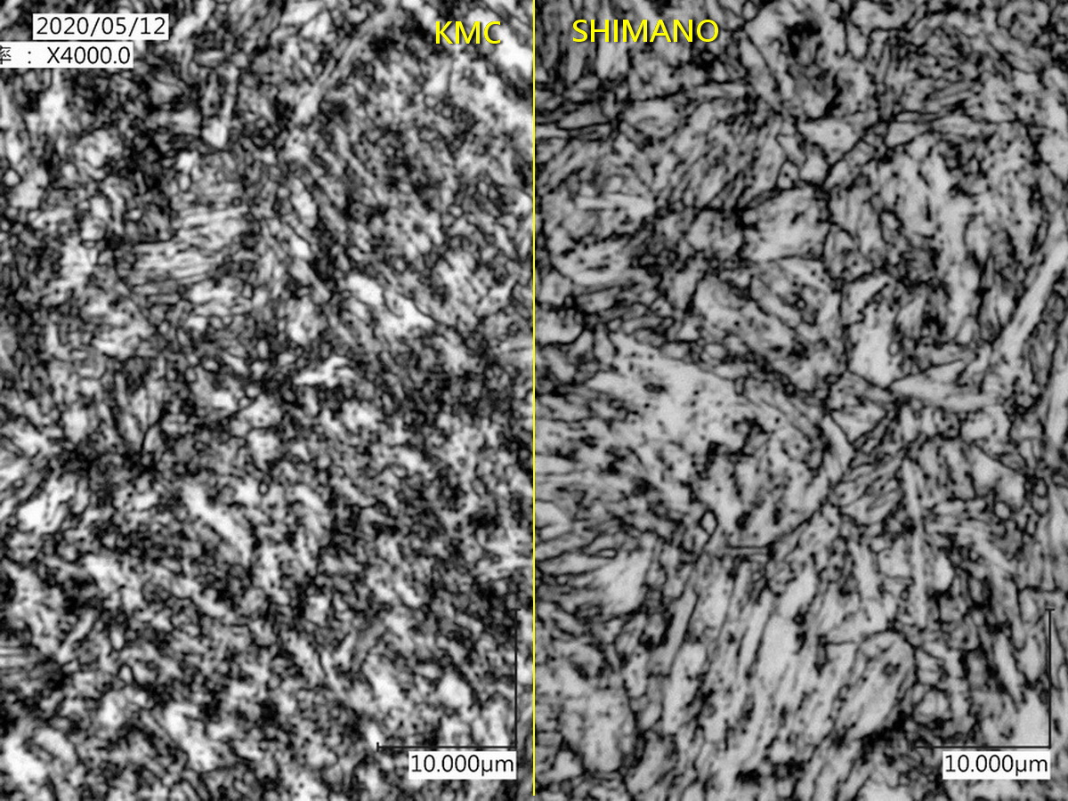

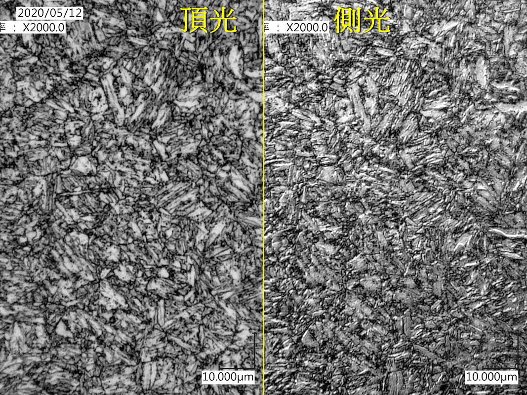

台日 鏈片金相 比較.............

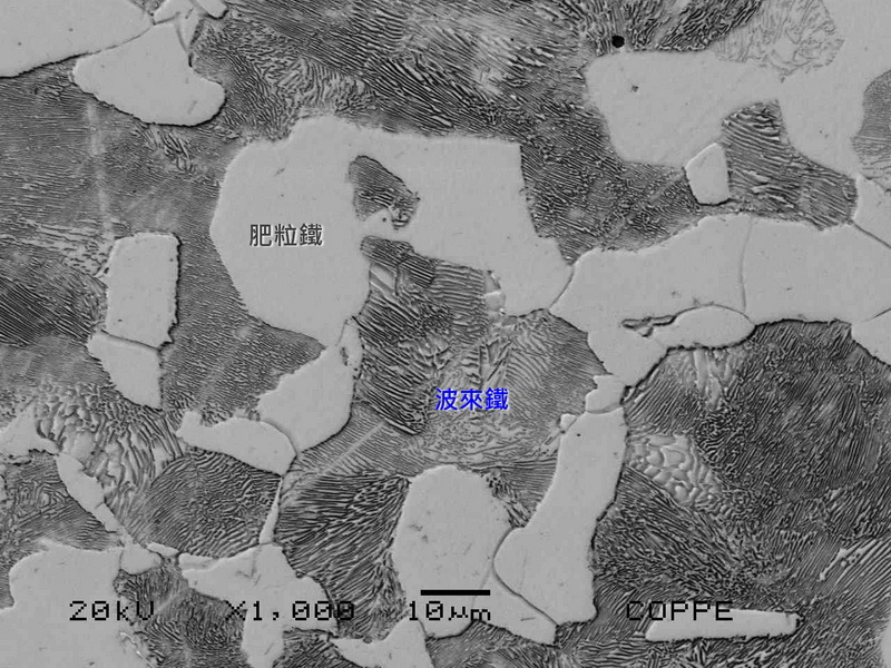

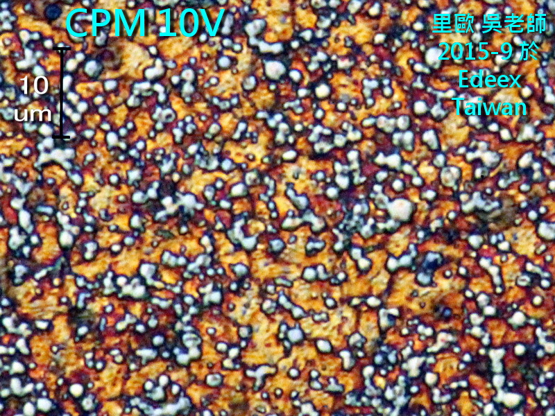

上些美照 大家欣賞. ... ... ...

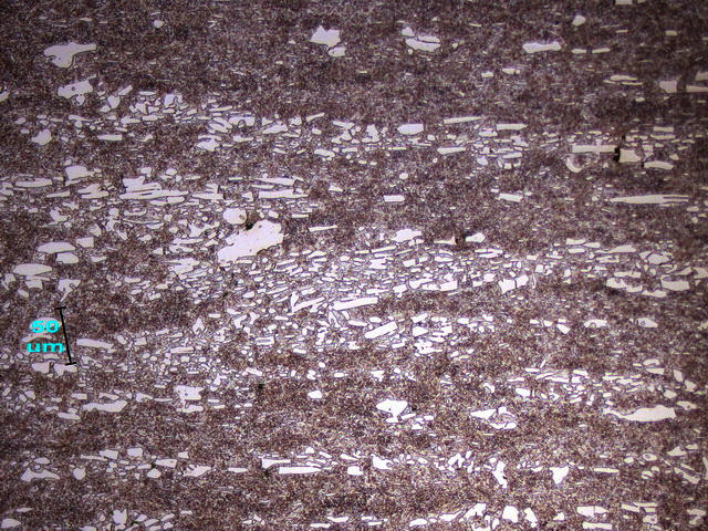

 楼主| 发表于 2020-9-27 06:45:56 | 显示全部楼层

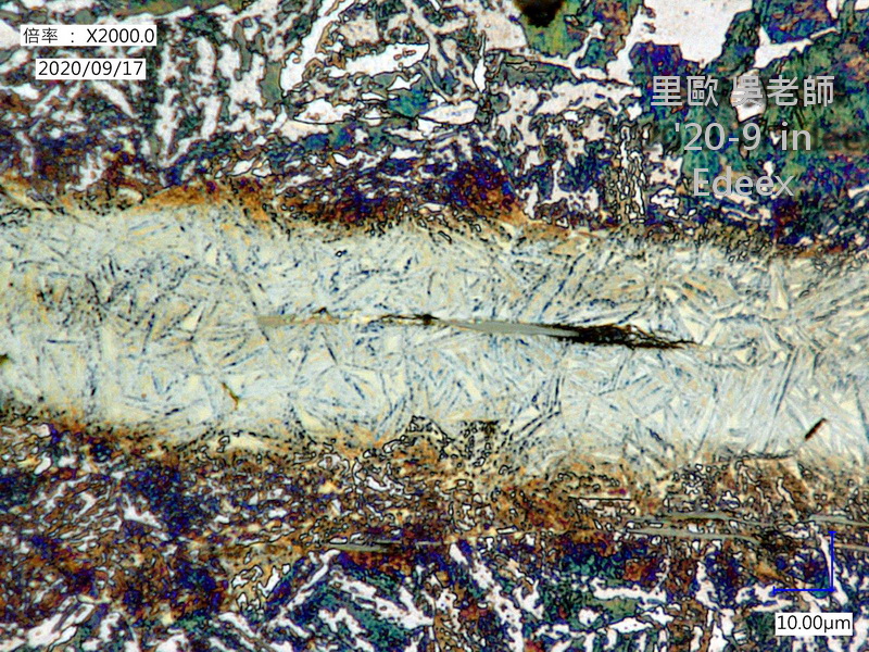

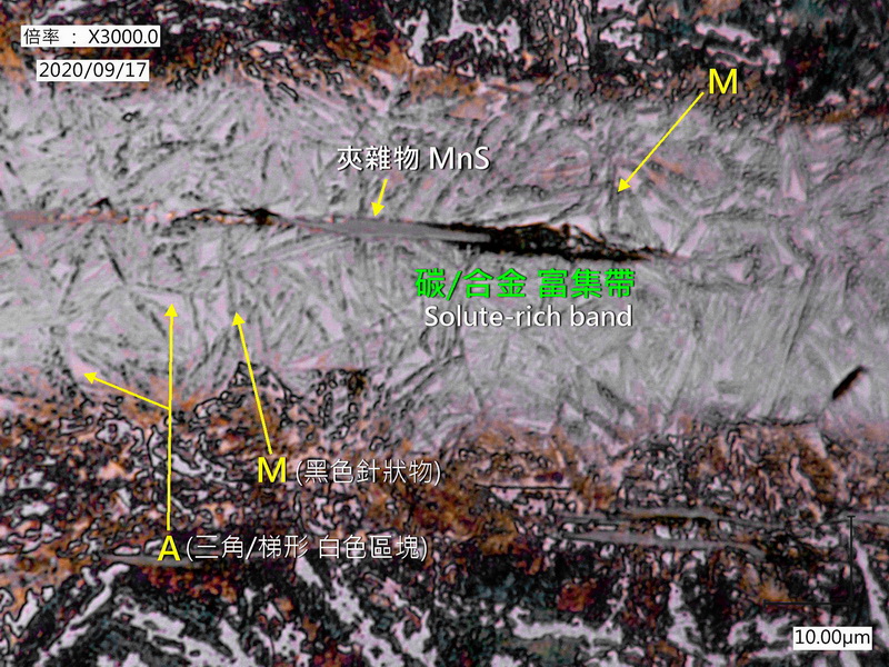

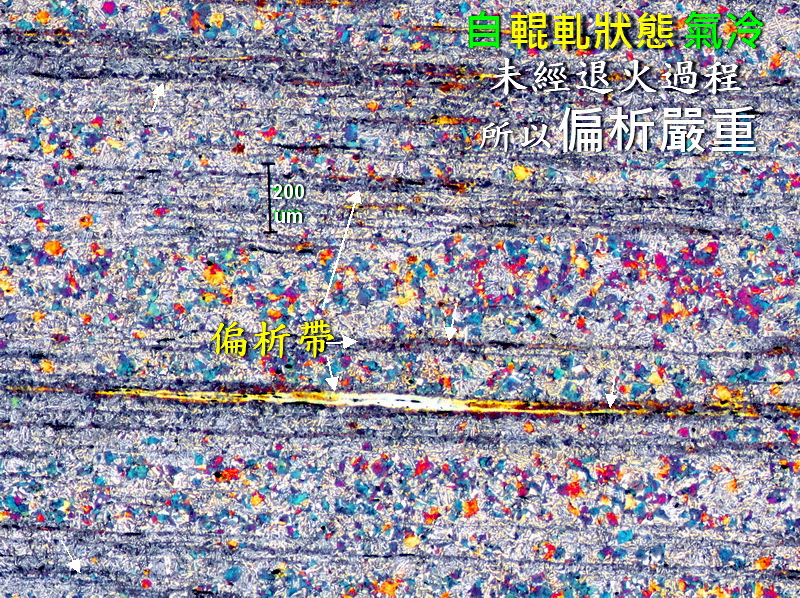

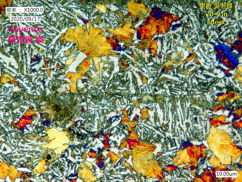

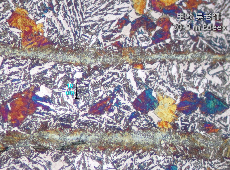

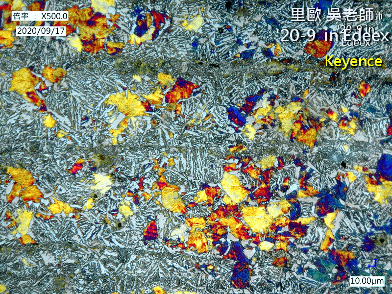

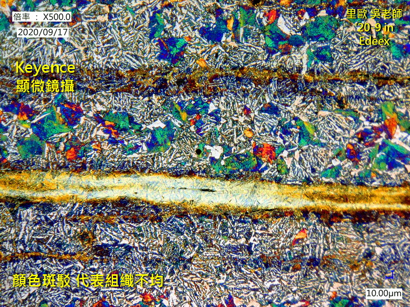

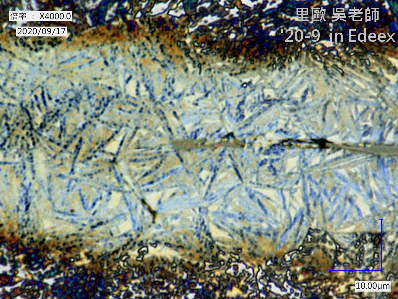

4140, SCM 440, as-rolled condition. 輥軋態,  常被冒充當作"調質鋼"販售.
Shot by the oldest metallurgist in Taiwan.

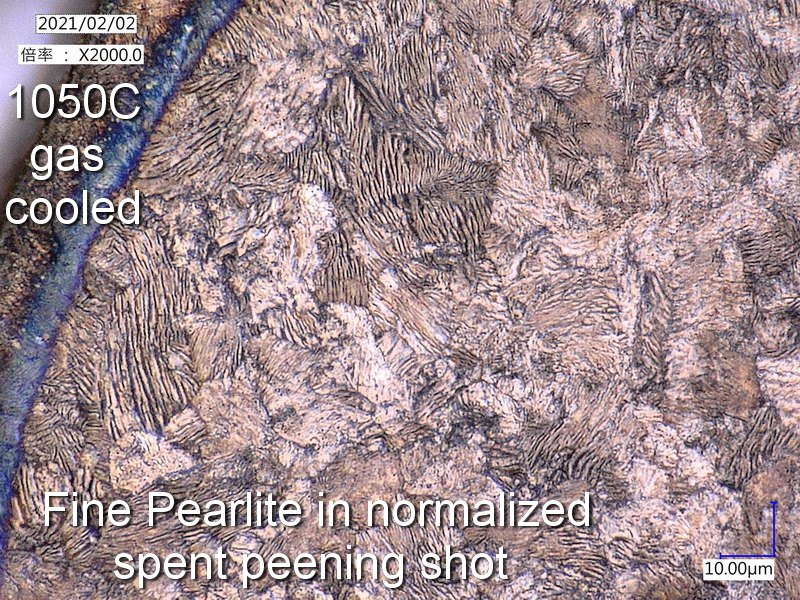

 楼主| 发表于 2021-2-23 06:04:33 | 显示全部楼层

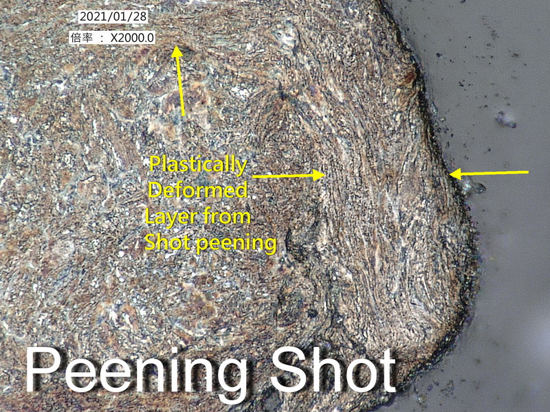

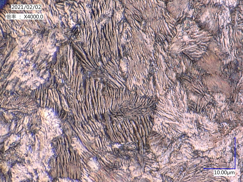

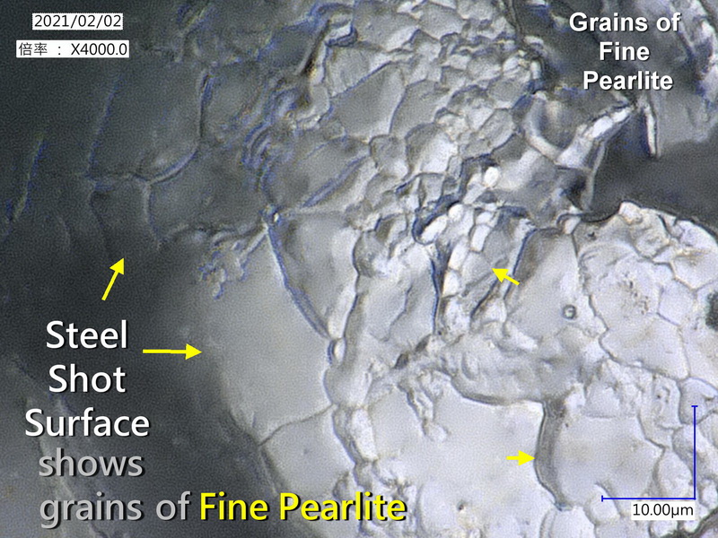

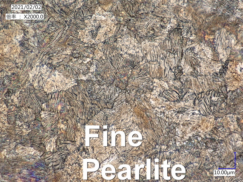

Spent peening shot, normalized in vacuum furnace.
See the new grains of fine Pearlite that grew from tempered Martensite.
3D photo
3D photo

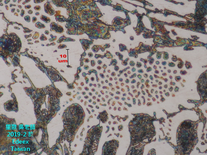

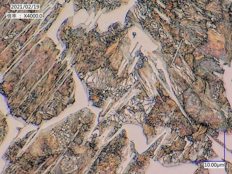

 楼主| 发表于 2021-2-23 06:20:09 | 显示全部楼层

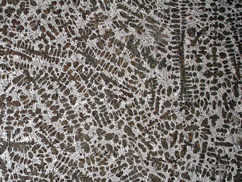

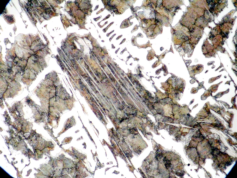

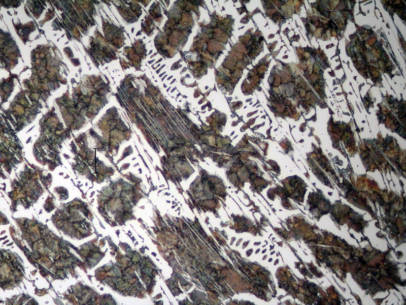

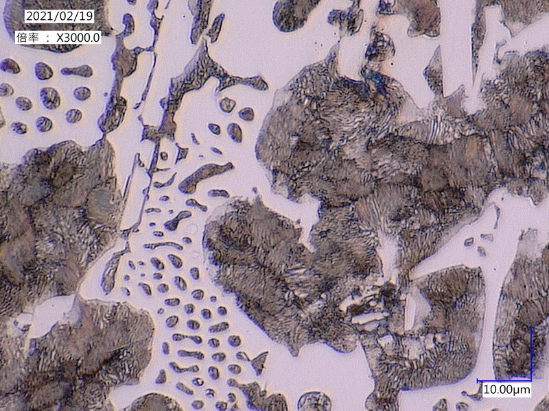

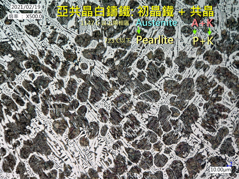

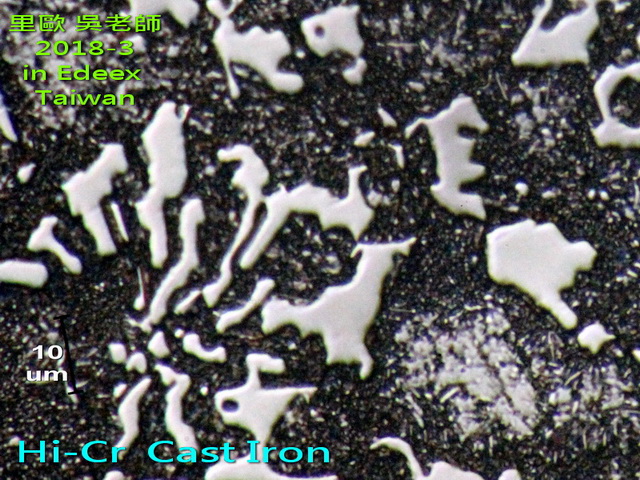

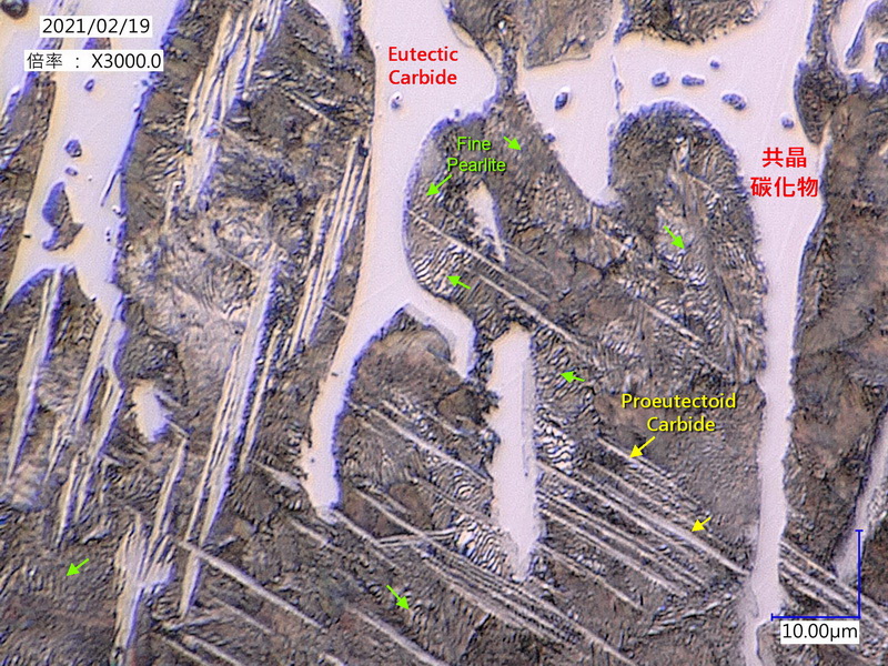

Hypoeutectic white cast iron
