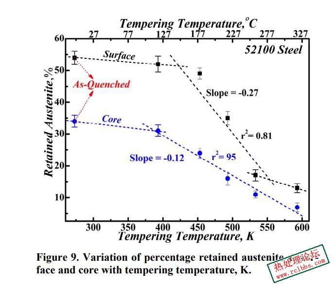

发表于 2024-7-11 14:25:10 | 显示全部楼层
wo63255052 发表于 2024-7-11 12:52
朱工!能不能请教一下对无碳化物层的看法?有好还是没有好,各自代表的意义又是什么呢?
It can be noted that there is very minimal reduction in
the RA till ~400 K (~127˚C) above which reduction is
steep (Figure 9). It can be seen that saturation tread is
observed around 520 K (277˚C) at surface; however no
such saturation trend is seen at core. A distinct change in
the slope indicates strong temperature dependence of RA
(Figure 9). The value of slope indicate rate of RA to
martensite transformation. It is quite evident from the
values slope that RA at surface transforms faster compared to RA at core. It directly related to the poor thermal stability of RA at the surface compared to RA at core.
The goodness of the linear Recent investigation indicates
that the higher RA contents at the surface increase the
fatigue life of the bearing
希望这个图片和英文能帮助你。。。

发表于 2024-7-13 10:46:59 | 显示全部楼层
the RA till ~400 K (~127˚C) above w ...
这个是温度对残奥的影响吧,还有表面残奥多的话怎么解决在使用过程中的尺寸变化呢? 还有哈,SKF的表面要求无碳化物层要求控制在小于15丝以内,这个量的话是针对热处理的吧,经过磨加工以后这个层肯定也是没有的了,那存在的意义又是什么呢?
