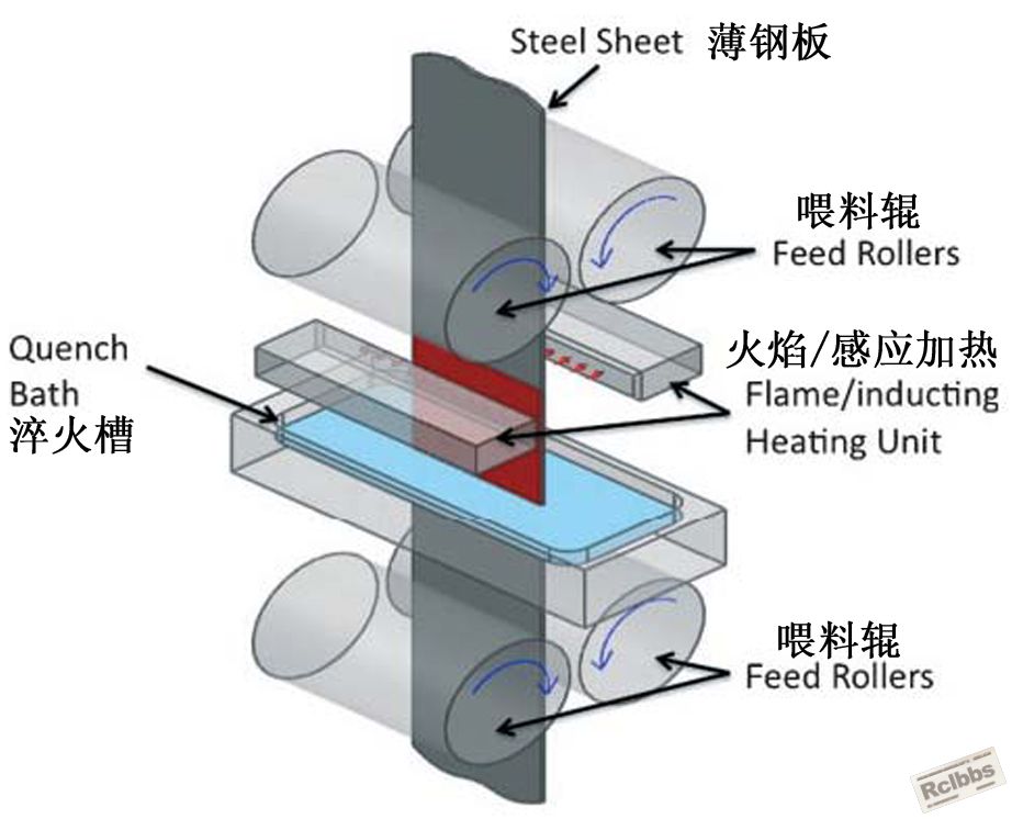

                                                                       1 Schematic illustration of experimental set-up of FP technique
        A schematic of the process set-up is shown in Fig. 1. The assembly consists of a pair of rollers that transfers the steel sheets through a heating and cooling stage. At a controlled distance from the top pair of rollers, the heating stage is placed. The heating stage is based on either oxy propane flame or electrical induction heating. The flame heating consists of 17 flame nozzles spaced evenly to spread the heat over the steel sheets. The above set-up has also been equipped with infrared pyrometers, instrumentation to drive the feed rollers, mechanical fixtures for positioning heating and cooling units, and heating intensity controls. Spot temperature check using an Ircon (美国IRCON公司的IRCON公司品牌)infrared pyrometer(红外线高温计) showed a small variation of temperature of approximately ±10℃ from the middle to the edges of the sample. Immediately below the heating port, a cooling trough is placed. To avoid inefficient heating due to the upward flow of steam, a graphite separator film is used to separate the heating and cooling ports. In this experiment, the steel sheets were fed through the heating and cooling system at a rate of 28 cm min21 while maintaining the peak temperature at 1100℃. In order to compare the flash processed samples with a reference sample, another AISI8620 unprocessed steel sheet was subjected to a quenched and tempered (QT) treatment (1000℃/2 min→quenched →tempered at 200℃/4 min).

        工艺结构简图见图1。这个装备是由传递薄钢板通过加热和冷却阶段的一对辊子组成。从顶部的一对辊子,加热阶段之间留出一个可控的距离。加热阶段是根据氯丙烷火焰或感应加热确定。氯丙烷火焰加热有17个火焰喷嘴间距,均匀喷射到薄钢板上。上面的装置安装红外线高温计,装置驱动喂料辊子。机械固定加热和冷却部件单元,和控制加热烈度。现场温度检测使用一个IRCON红外线高温计,从样品的边缘到中心的最小温度波动在±10℃。
在加热段下面,接着布置一个冷却槽。为了避免蒸汽向上流动影响加热,用石墨隔离幕来隔开加热和冷却区域。
在这个试验中,加热峰峰值在1100℃时,薄钢板走速是28cm/min通过加热和冷却系统。为了用瞬时处理的样品与参照样品比较,另一个没有经过处理的AISI8620薄钢板采用淬火+回火(QT)处理(1000℃/2min→淬火→200℃/4min回火)。
