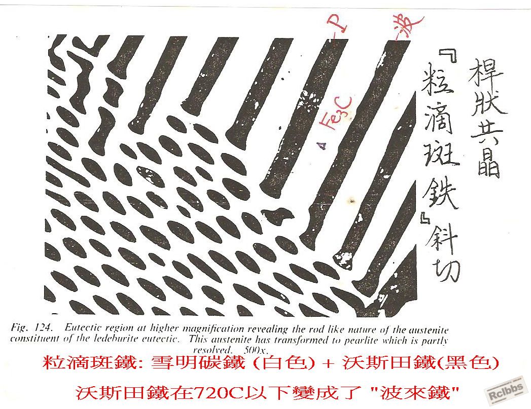

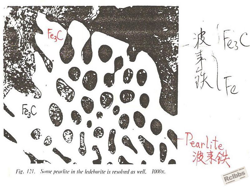

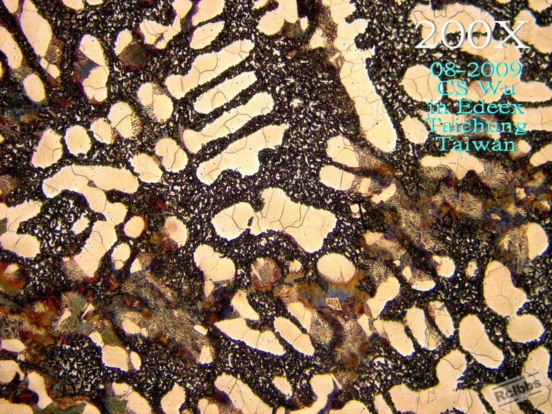

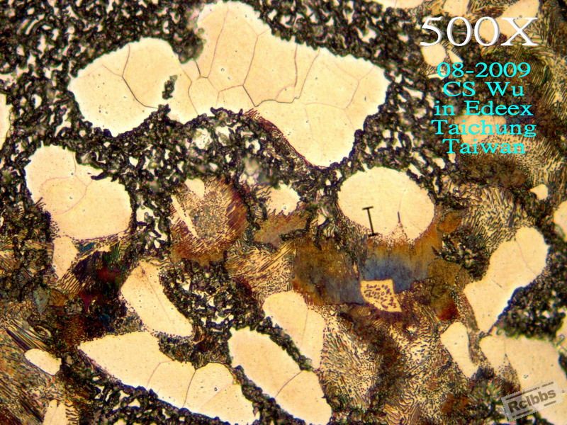

那位同仁有冷激铸铁金相图,麻烦发几张给看看,最好到有组织分析的,谢谢了。
签到天数: 474 天

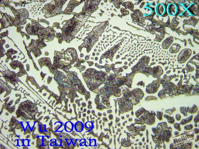

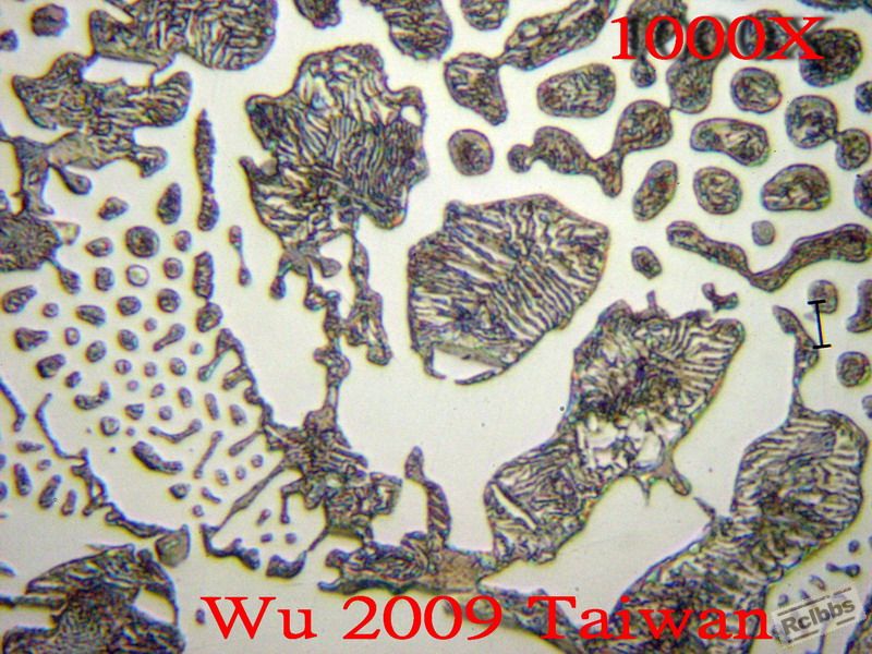

 楼主| 发表于 2009-7-21 07:54:32 | 显示全部楼层
回复 160# limeihua20 的帖子
Chilled cast iron = white cast iron
有些是英國書上的相片

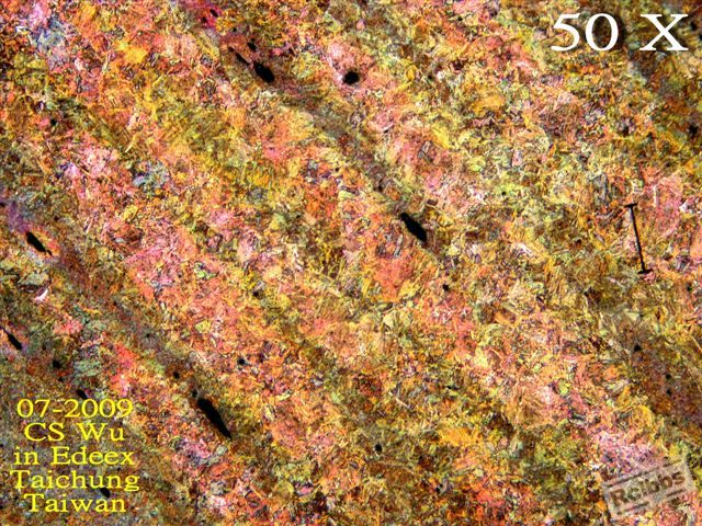

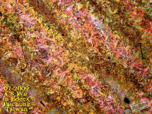

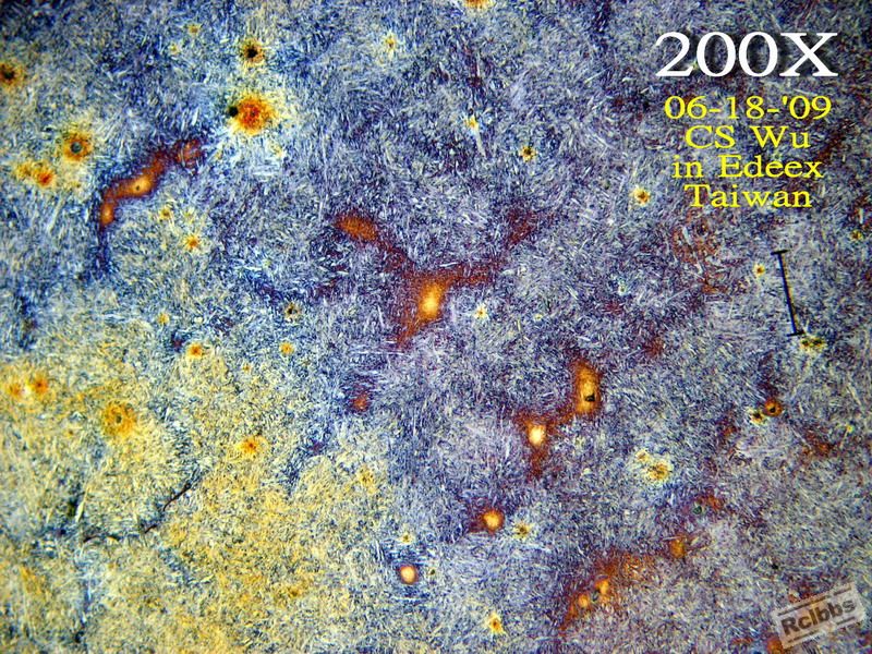

 楼主| 发表于 2009-7-25 15:13:00 | 显示全部楼层

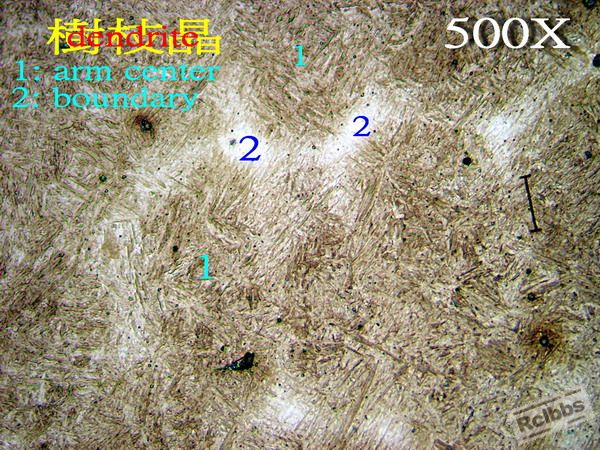

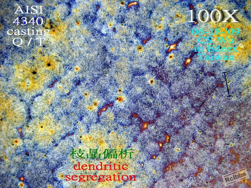

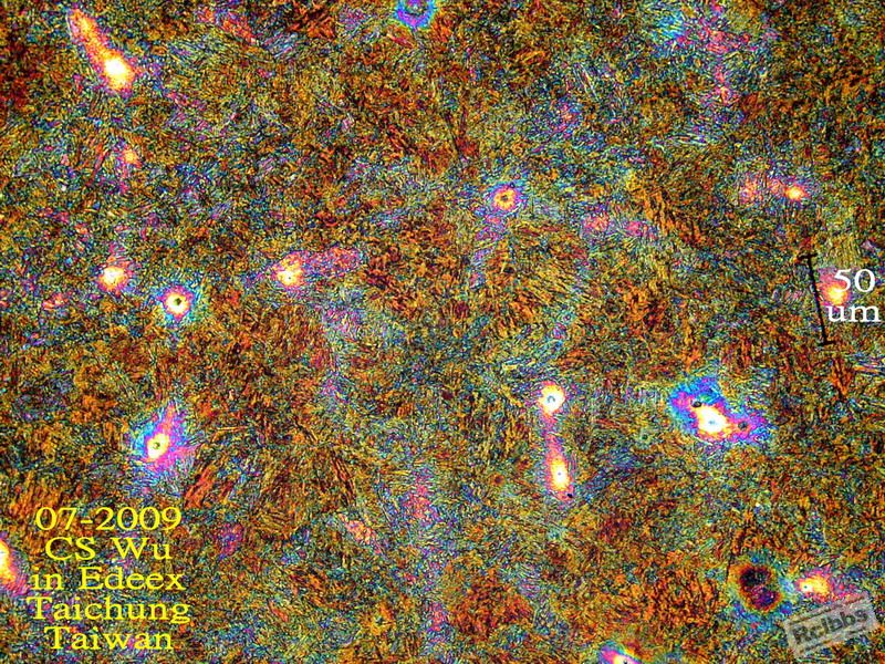

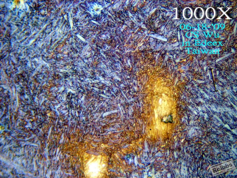

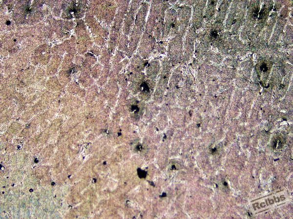

AISI 4340
Casting  鑄件  樹枝狀偏析
SNCM 440;    40NiCrMo?
Quenched and tempered.
Please note the dendritic segregation.
Photo ~1781: dendrite arm boundary (2) is solute-rich, rich in C and alloying elements. You will often find carbide particles and R.A. on these spots.

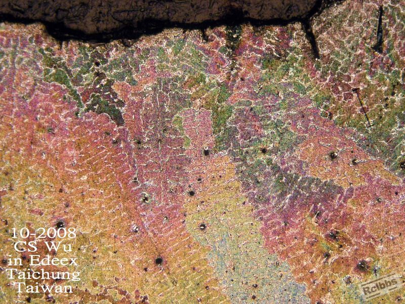

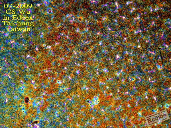

 楼主| 发表于 2009-7-25 15:40:57 | 显示全部楼层

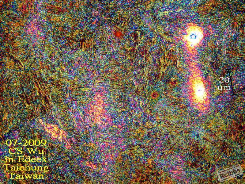

另一組相片
同上 same as above
光奌是 points last to freeze. 枝晶最後凝固奌.

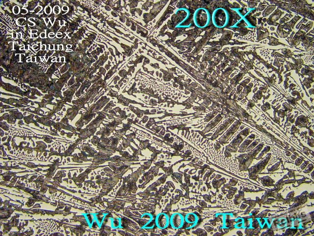

 楼主| 发表于 2009-7-26 22:56:06 | 显示全部楼层

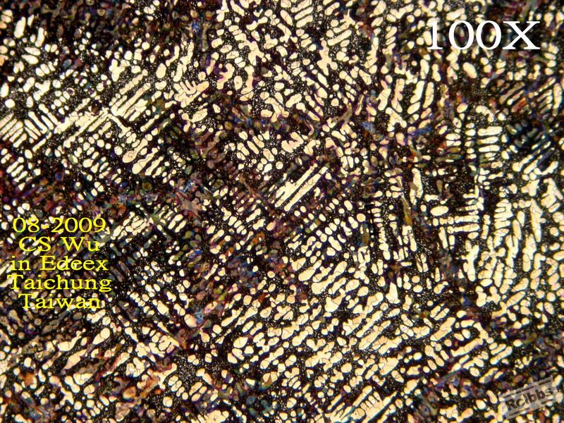

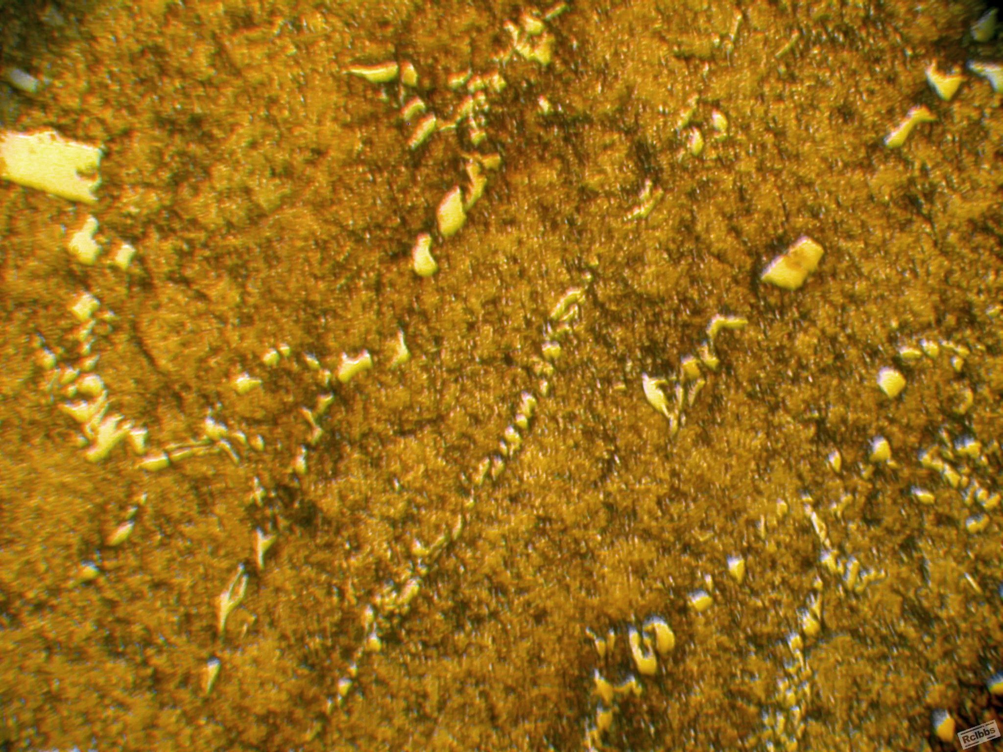

铸态奥氏体不锈钢
~ AISI 310 耐熱鋼  Austenite dendrites
with carbides particles between dendrite arms ( that is, dendrite arm boundary)
that are sites last to freeze.
[ 本帖最后由 leomet 于 2009-7-27 11:36 编辑 ] 本帖最后由 leomet 于 2009-10-25 13:27 编辑

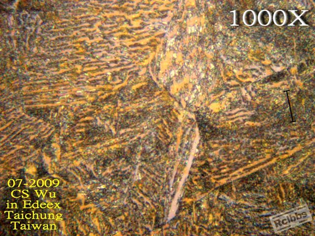

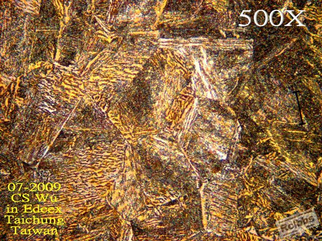

 楼主| 发表于 2009-7-29 09:22:41 | 显示全部楼层

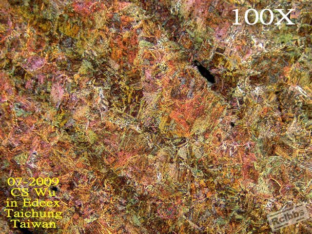

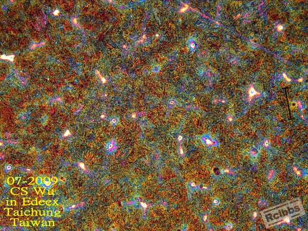

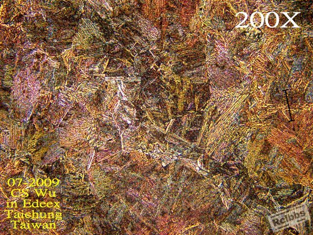

4140
給大家看圖說話.
1020 C air-cooled.

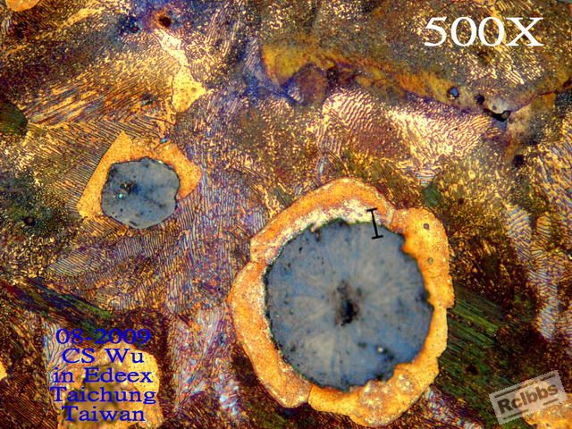

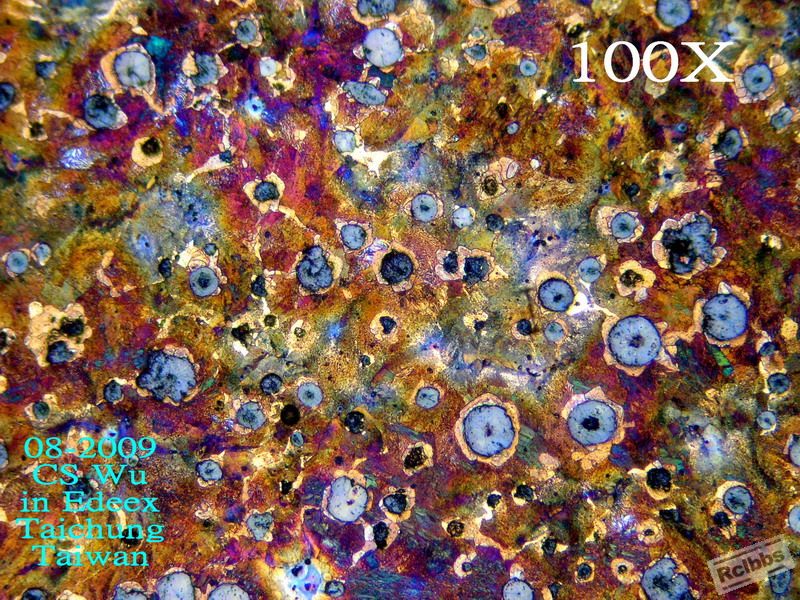

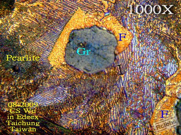

 楼主| 发表于 2009-8-1 10:22:19 | 显示全部楼层

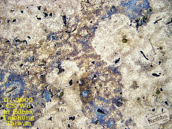

QT 铸铁金相 欣赏
JIS : FCD 650 ?
Not that bad !
[ 本帖最后由 leomet 于 2009-8-2 07:59 编辑 ]

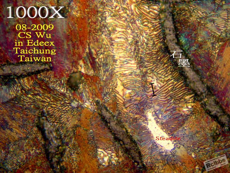

 楼主| 发表于 2009-8-1 10:47:34 | 显示全部楼层

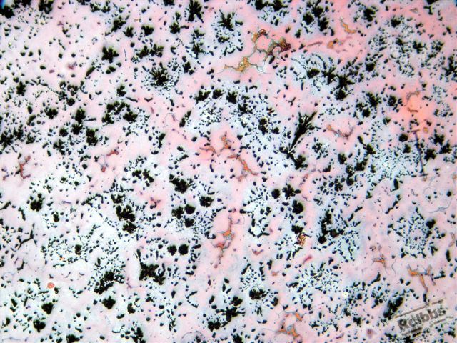

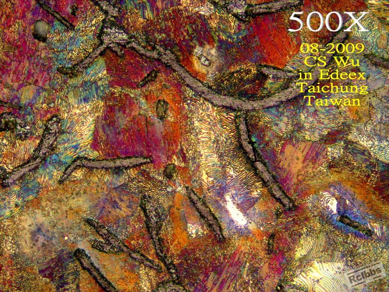

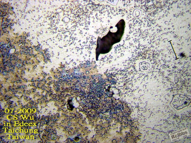

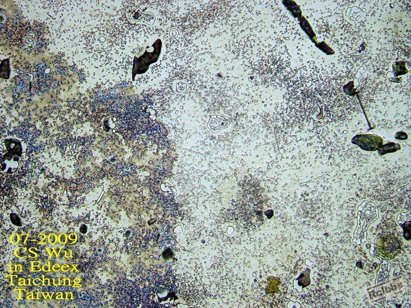

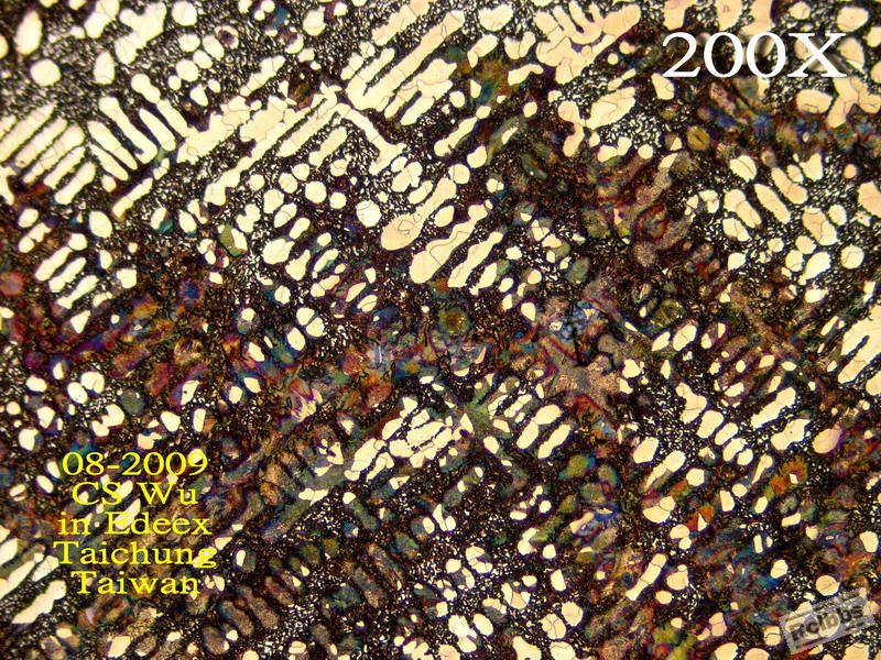

FT 铸铁金相 欣赏
I am a man of few words, So, no discussion here.
I am a man with a thousand photos, and I
  hope you guys enjoy seeing  the photos I post.
D-type graphite caused by  too much undercooling.
Casting probably poured at too low a temperature.
Or, that part of the casting (lug)  happened to be fed with  front metal.
[ 本帖最后由 leomet 于 2009-8-1 11:27 编辑 ]

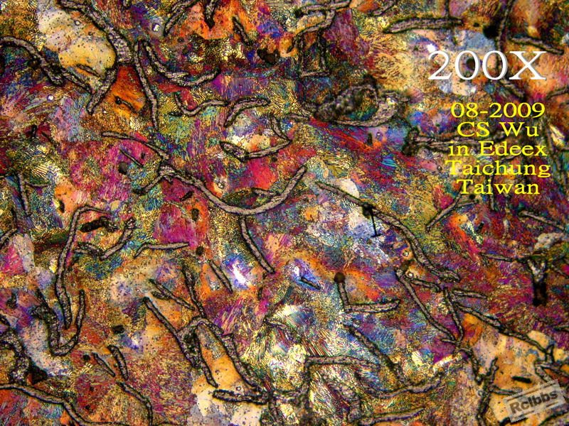

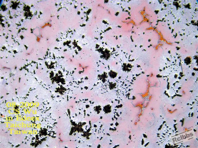

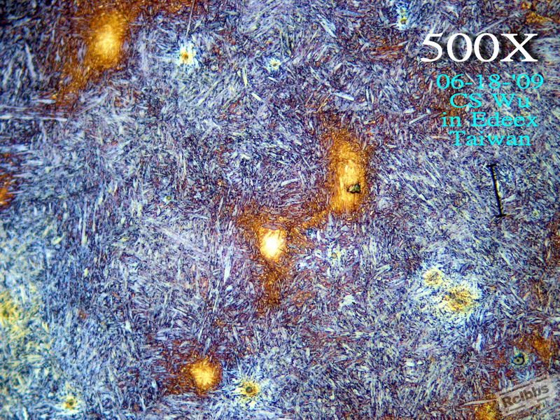

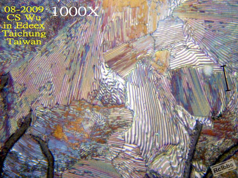

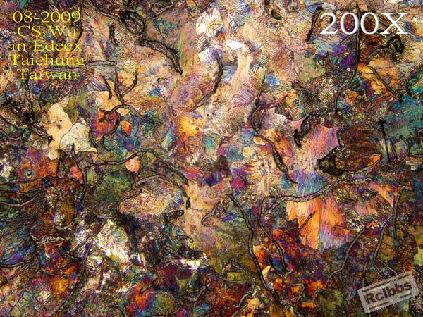

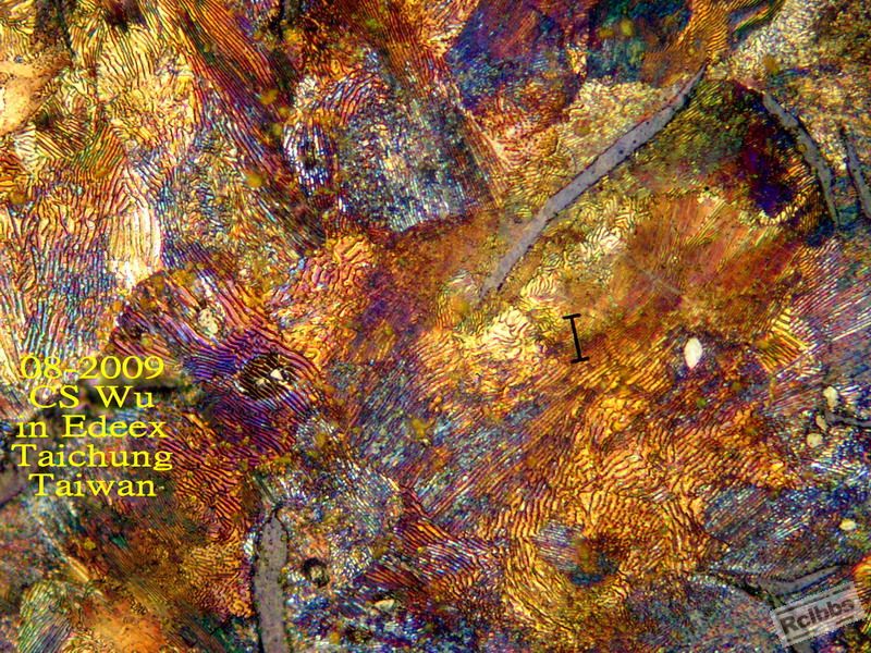

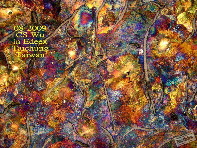

 楼主| 发表于 2009-8-1 11:23:33 | 显示全部楼层

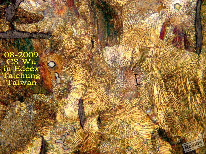

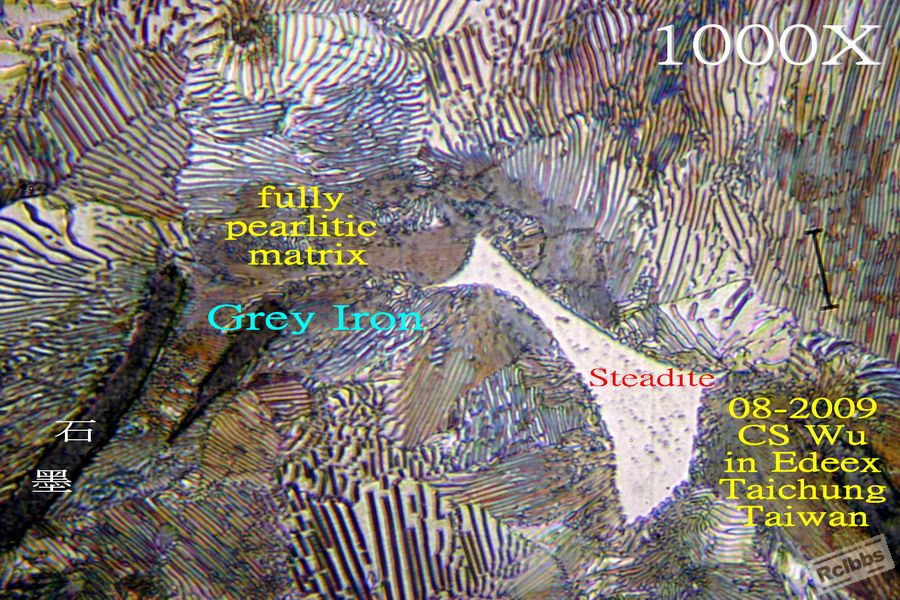

FT 铸铁金相 欣赏
Photos that feast your eyes.

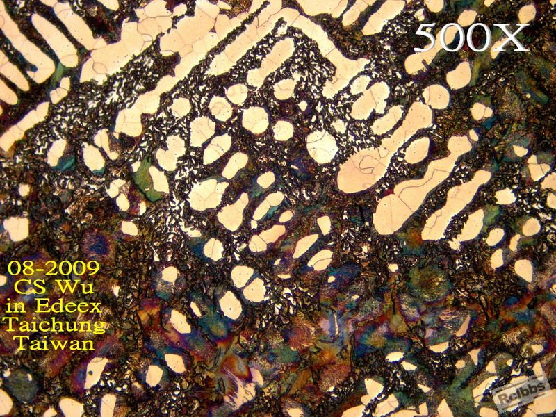

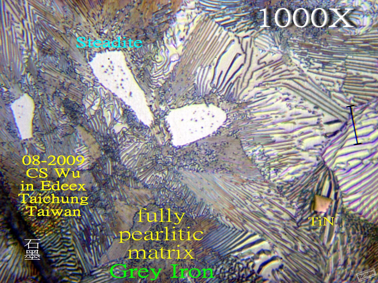

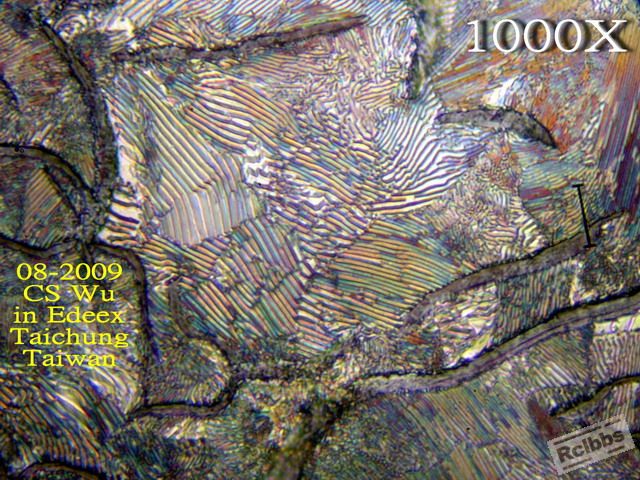

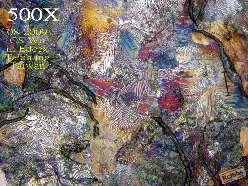

 楼主| 发表于 2009-8-8 07:21:35 | 显示全部楼层
FT 铸铁金相 欣赏
It will be a pitty not sharing with you.

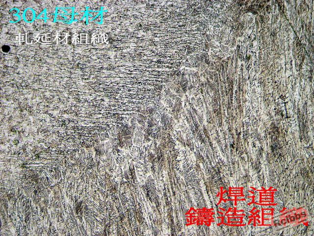

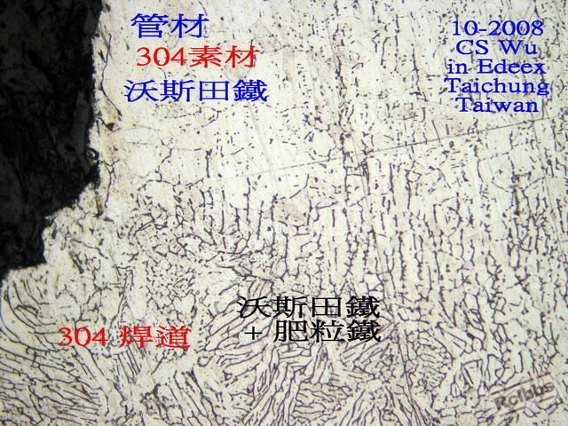

照片太漂亮了,是否有不锈钢904,2205的照片,上传一下,欣赏欣赏。
签到天数: 474 天

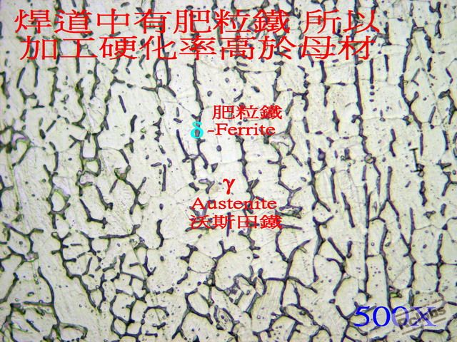

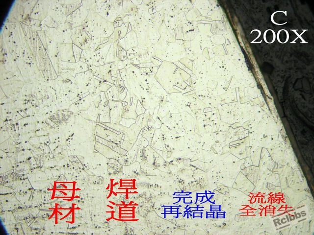

 楼主| 发表于 2009-8-9 07:26:00 | 显示全部楼层
回复 155# 盛丽丽 的帖子
不锈钢, the only one I did: AISI 304
[ 本帖最后由 leomet 于 2009-8-9 07:34 编辑 ]

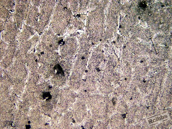

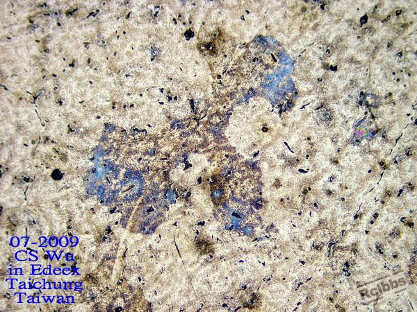

发表于 2009-8-9 09:42:58 | 显示全部楼层

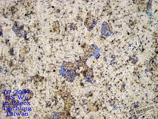

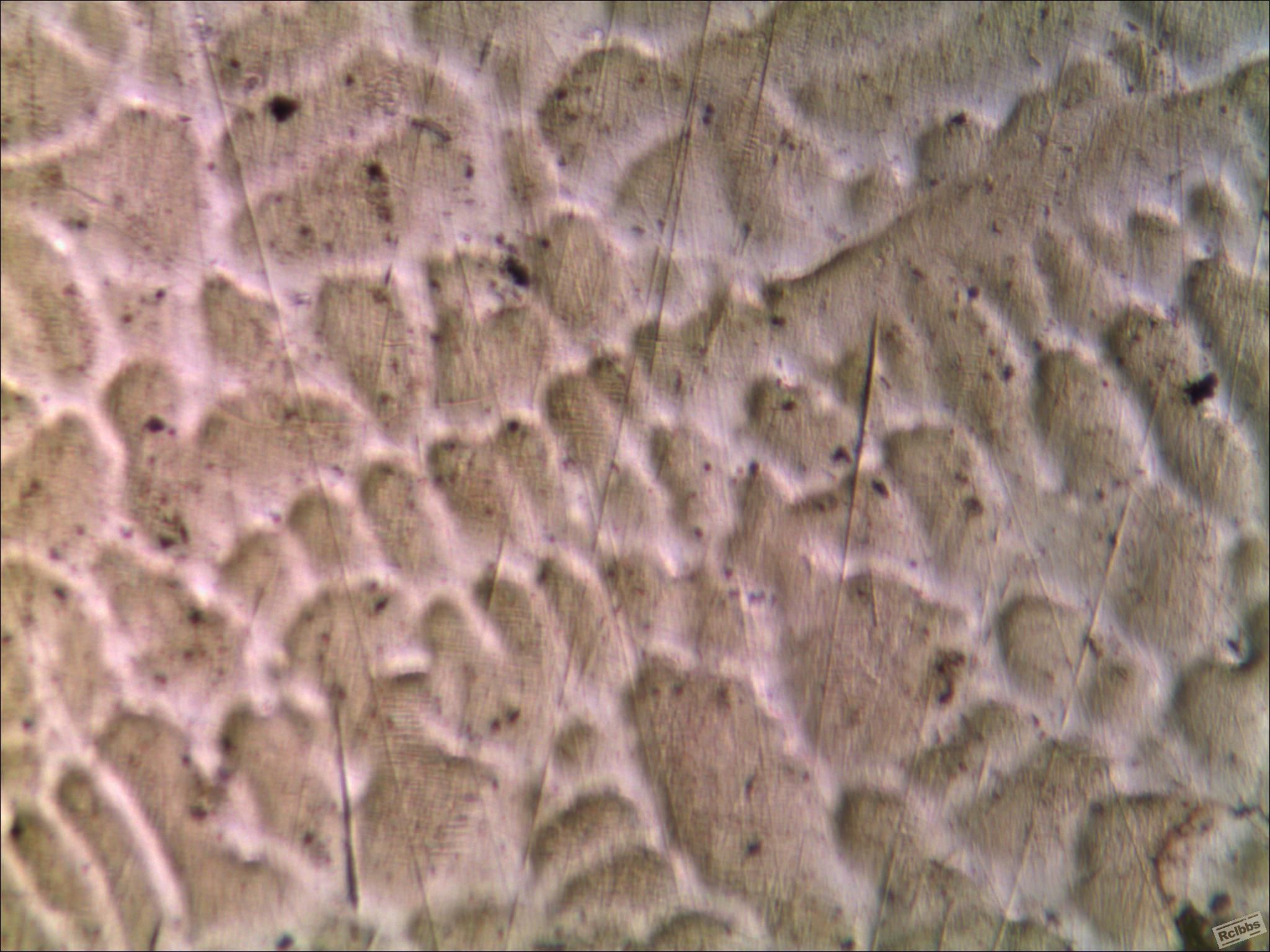

老师你好,请问此图材料904,状态固溶,王水腐蚀,个人认为白区是奥氏体,灰色区是铁素体,对否?
签到天数: 474 天
 楼主| 发表于 2009-8-10 07:15:07 | 显示全部楼层
回复 157# 盛丽丽 的帖子
If yes, it should be the other way around. Delta ferrite is white.
My opinion : only austenite phase exists after solution quenching.
I say so because there is no phase boundary.
This segregation is also named as " coring segregation". 漸層.
[ 本帖最后由 leomet 于 2009-8-12 23:47 编辑 ]

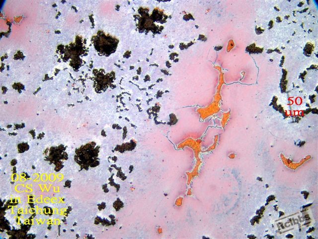

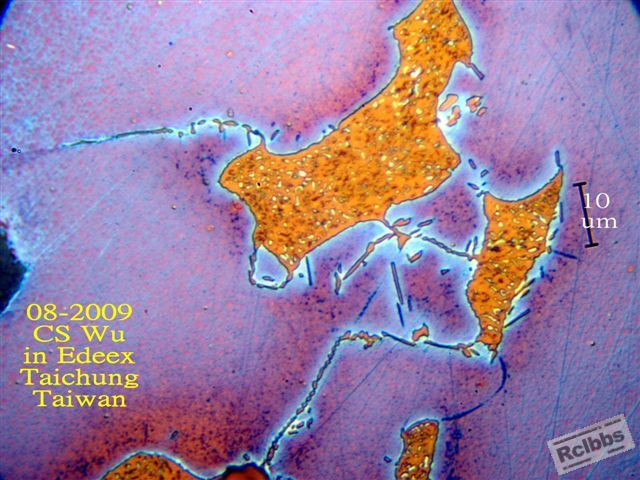

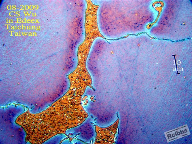

 楼主| 发表于 2009-8-13 00:00:33 | 显示全部楼层

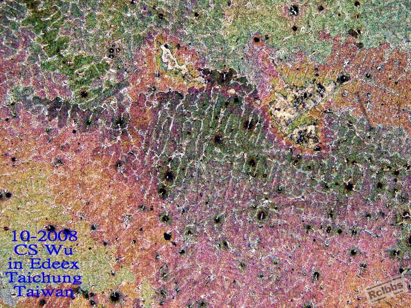

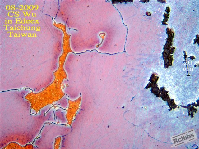

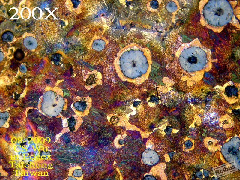

共晶碳化物 in 球鉄
Eutectic carbide  in the matrix of a 15% Ni ductile iron.
Nodularity of graphite is not-so-good.
[ 本帖最后由 leomet 于 2009-8-14 09:04 编辑 ]
