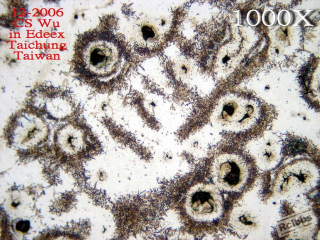

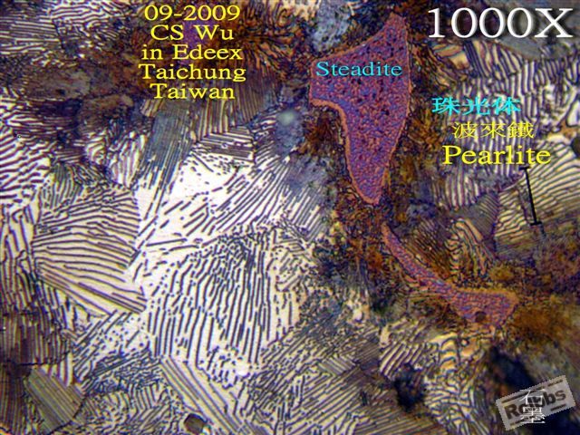

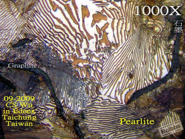

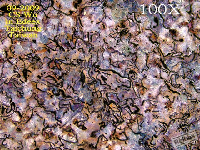

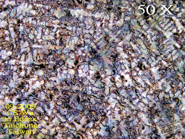

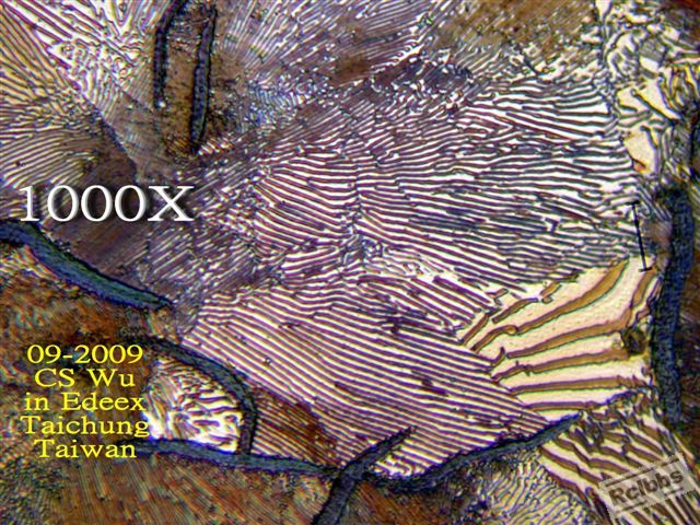

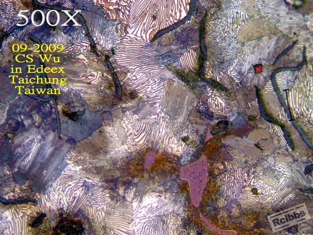

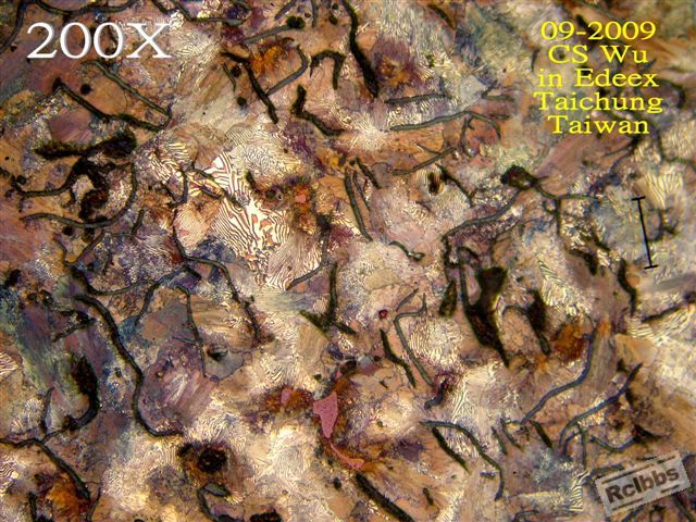

Grey Cast Iron  Sept 02, 2009 攝
These photos are
my footprints on the sands of time
in the field of metallurgy. 本帖最后由 leomet 于 2009-9-13 11:35 编辑

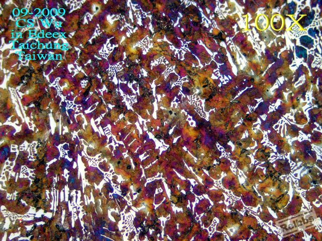

 楼主| 发表于 2009-9-9 20:39:42 | 显示全部楼层

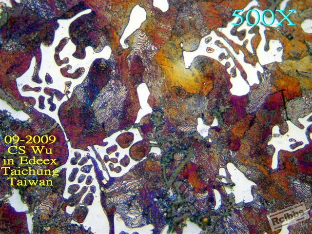

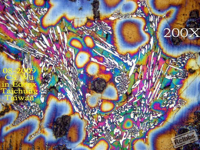

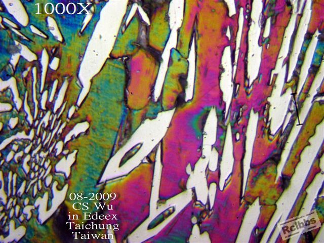

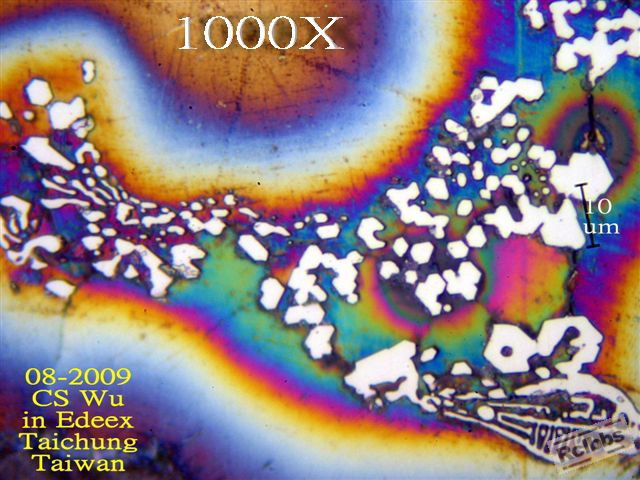

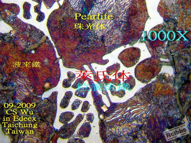

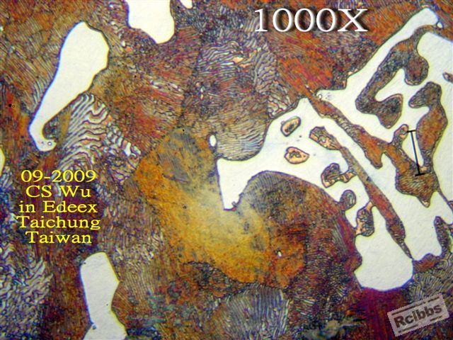

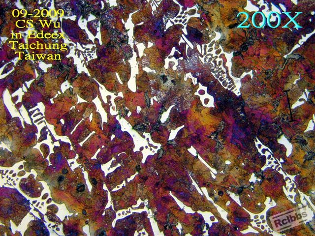

亞共晶 白鑄鉄
萊氏体鋼鍛造前, 其共晶碳化物大約就是這型貌.
鍛造將碳化物(耐磨相)打碎/散, 以提高切削性. 本帖最后由 leomet 于 2009-10-16 07:47 编辑

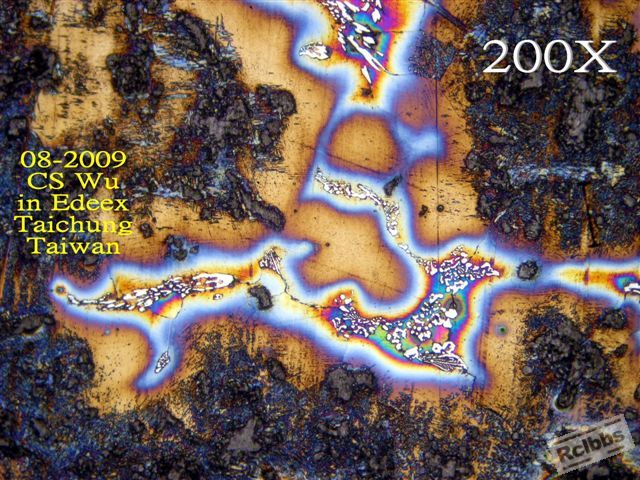

HAZ caused by abrasive wheel cutting without spraying cooling water.
Note the dendritic feature of martensite areas. Martensite formed
in these area because these areas are LFZ and are alloy-rich and have better
hardenability. 本帖最后由 leomet 于 2009-12-2 07:30 编辑

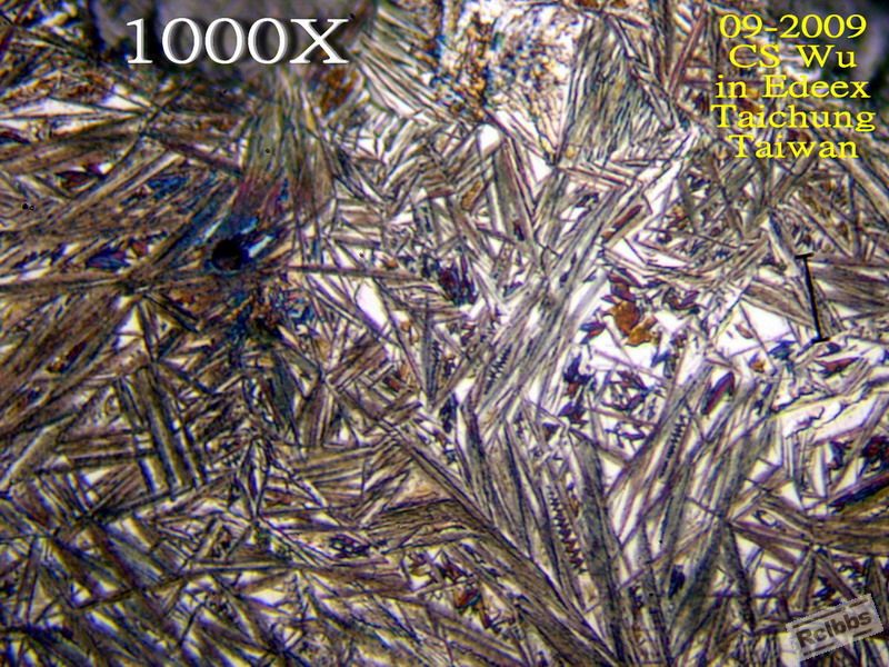

 楼主| 发表于 2009-9-30 17:26:41 | 显示全部楼层

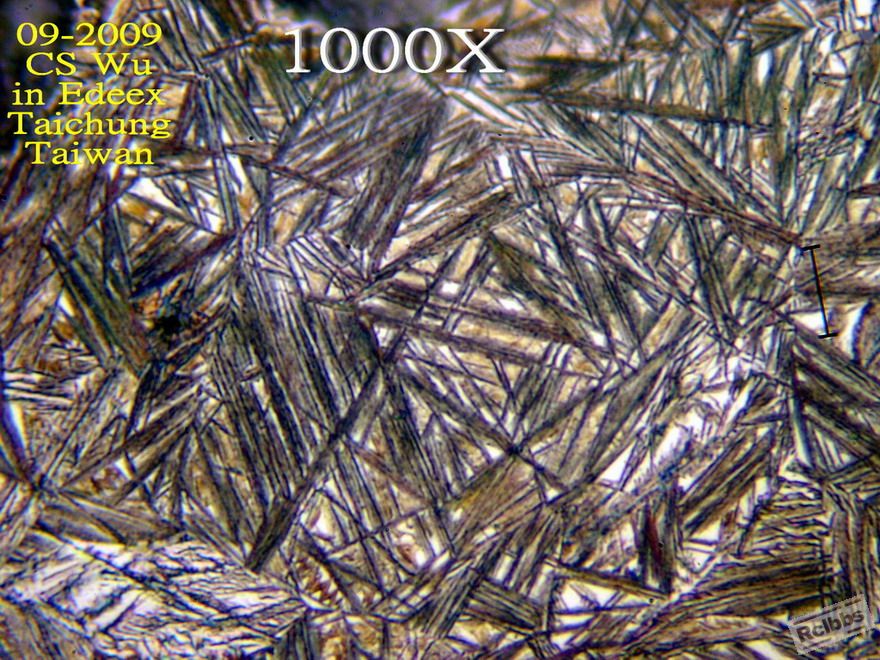

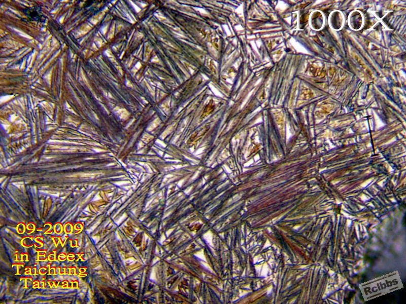

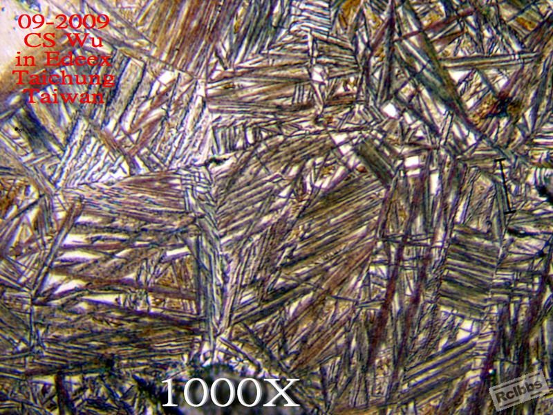

Austempered Ductile Iron,  1130 MPa UTS X 4% elongation.  300C salt bath.

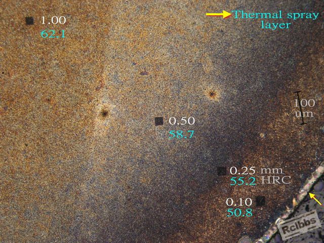

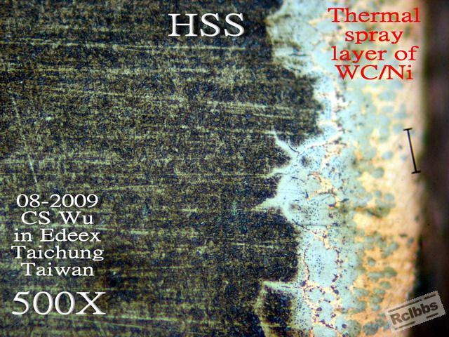

熱噴敷 Thermal Spray of  WC/Ni on a Q/T high speed steel part
Surface hardness number of HSS dropped a little
because of the intense heat input from thermal spray. 本帖最后由 leomet 于 2009-10-13 09:32 编辑

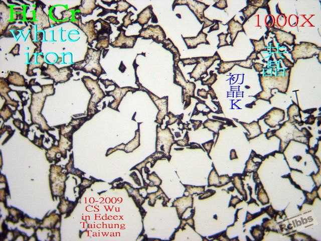

 楼主| 发表于 2009-10-24 22:08:29 | 显示全部楼层
173# leomet

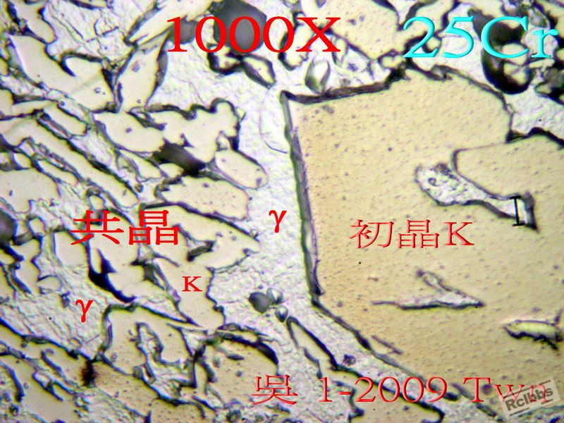

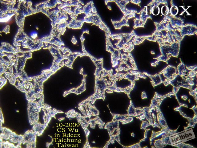

High Cr white cast iron
1st photo: carbide slightly tinted.
2nd photo: matrix of austenite slightly tinted.
3rd photo: same field as 2nd, dark field. 本帖最后由 leomet 于 2009-12-30 06:47 编辑

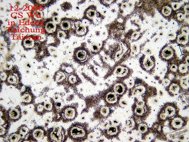

 楼主| 发表于 2009-10-26 07:55:41 | 显示全部楼层
174# leomet

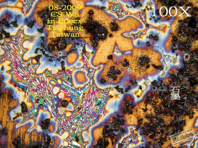

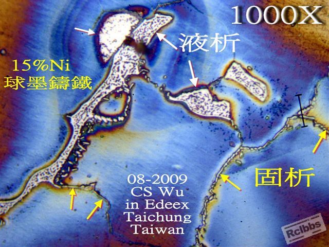

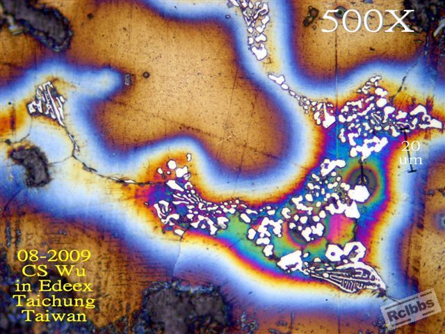

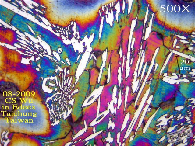

奧氏体球鉄 These photos are too good to be kept to myself.
Austenitic Ductile Iron with 15%Ni, posted previously
with different coloring.
Note the term 固析, ( 對應 液析)
固析carbide film on "dendrite arm boundary" is, most of the time,
the culprit that is responsible for most  toolings/parts  failed prematurely. 本帖最后由 leomet 于 2009-11-6 03:51 编辑

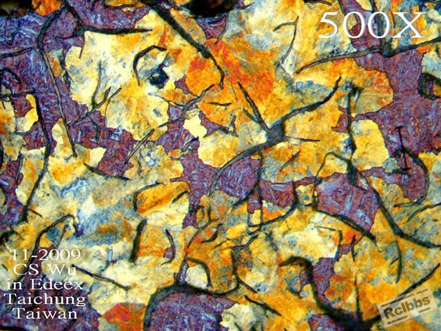

 楼主| 发表于 2009-11-14 09:41:11 | 显示全部楼层
175# leomet

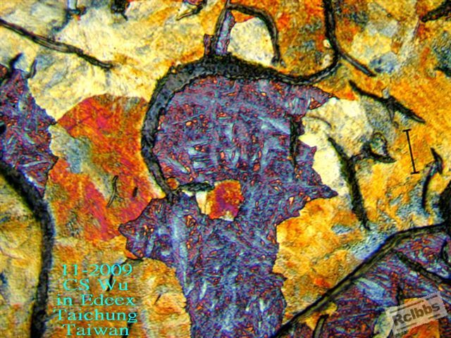

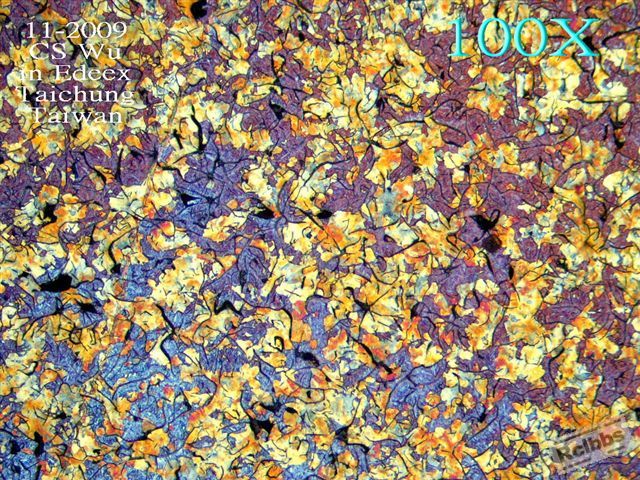

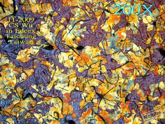

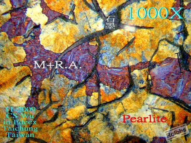

Continuous cooling transformation products of a grey iron.
white to orange area: fine Pearlite, upper temp product.
purple to light blue area: Martensite and retained Austenite. 本帖最后由 leomet 于 2009-12-2 07:28 编辑

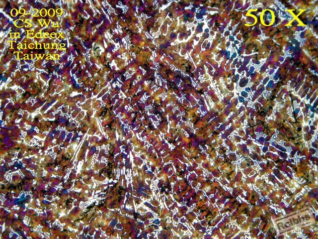

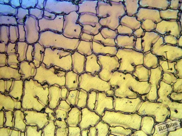

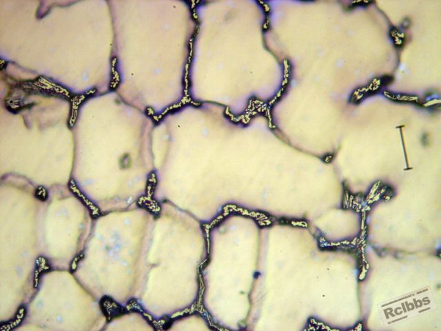

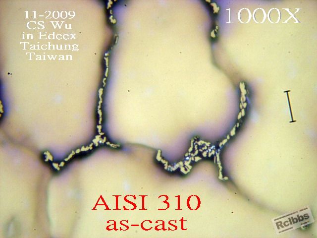

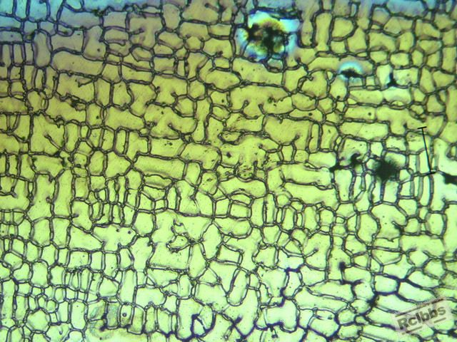

AISI 310, as-cast.
Austenite dendrites with carbide  in-between  "arm boundaries"
Either continuous or discontinuous, very thin carbide films  in-between dendrite arm boundaries often are found
after forging of tool steel, if homogenization soaking is not done successfully. 本帖最后由 leomet 于 2009-11-26 10:54 编辑

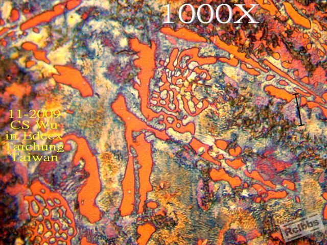

 楼主| 发表于 2009-11-19 06:07:42 | 显示全部楼层

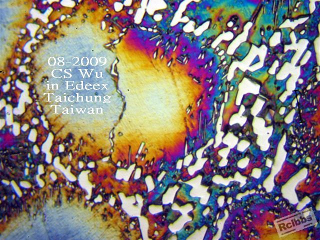

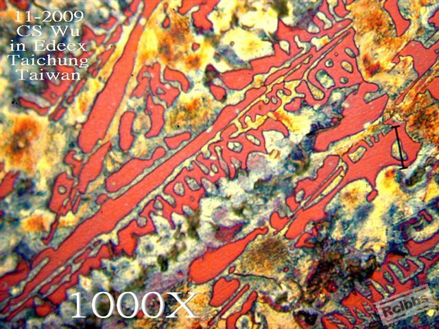

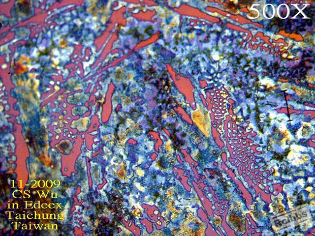

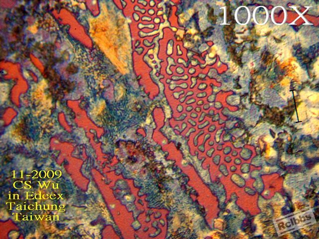

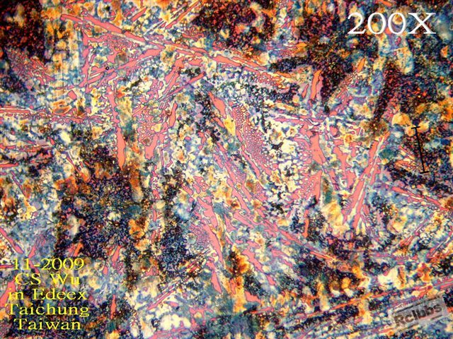

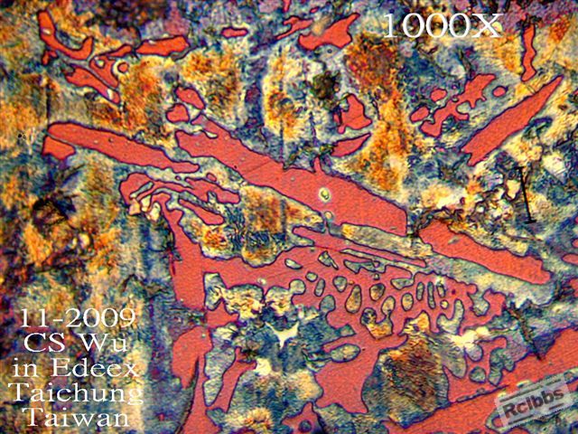

White cast iron, with eutectic carbide colored pink to red. 本帖最后由 leomet 于 2009-11-20 07:18 编辑
