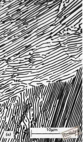

发表于 2013-5-7 09:36:56 | 显示全部楼层
Pearlite is often said to be a two-phased, lamellar (or layered) structure composed of alternating layers of alpha-ferrite and cementite that occurs in some steels and cast irons.
Pearlite was first identified by Henry Clifton Sorby and initially named sorbite, however the similarity of microstructure to nacre and especially the optical effect caused by the scale of the structure made the alternative name more popular.

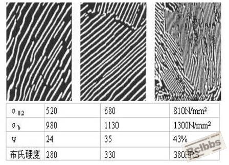

The strength of pearlite is determined by the scale of ferrite and cementile.
