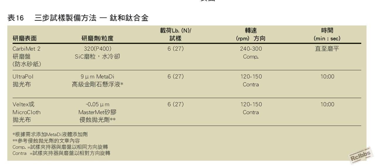

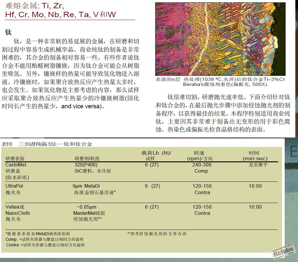

发表于 2014-11-21 23:53:19 | 显示全部楼层
• 240/P280 SiC Paper, Water Cooled, 6 lb(27N)/spec., 240-300 rpm, Comp., Until Plane
• 9-μm Metadi Supreme Diamond on Ultra-Pol Cloth, 6lb(27N)/spec., 120-150 rpm, Contra, 10 min.
• 0.05-μm Mastermet Colloidal Silica on Microcloth , 6lb. (27N)/spec., 120-150 rpm, Contra, 10 min. with attack polishing agent (1:5 mix of hydrogen peroxide , 30% conc., to colloidal silica)
Excellent results with CP Ti in Polarized Light

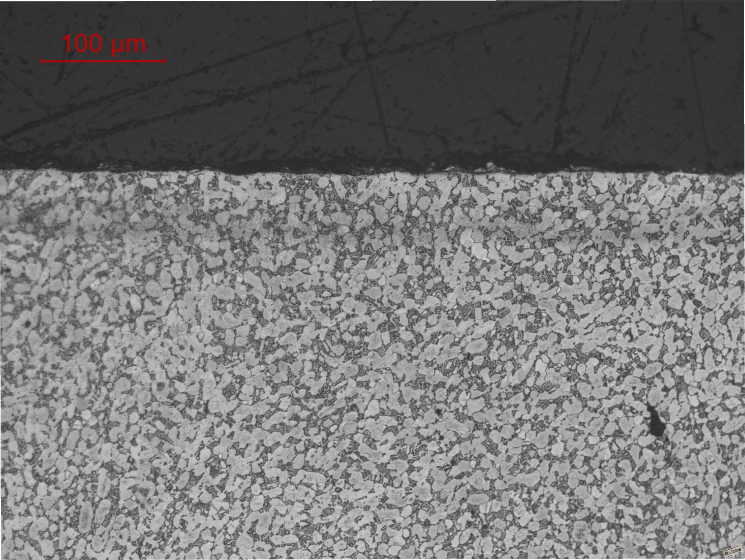

发表于 2014-11-22 06:36:45 | 显示全部楼层
TC4  200倍 腐蚀后的照片
