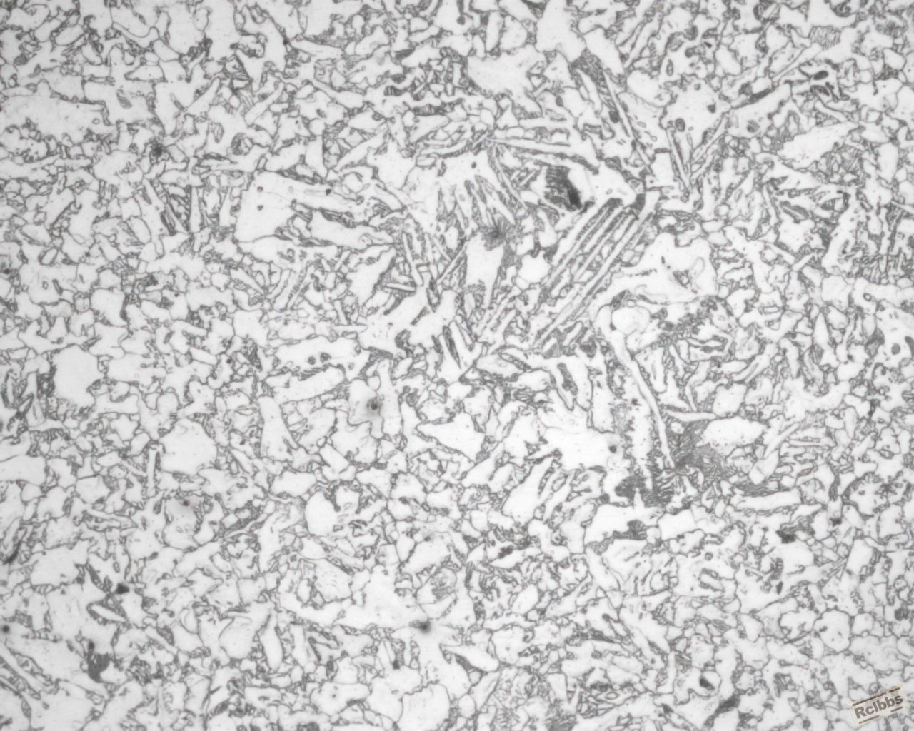

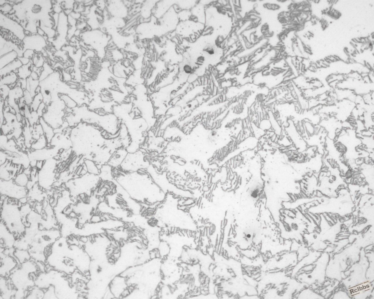

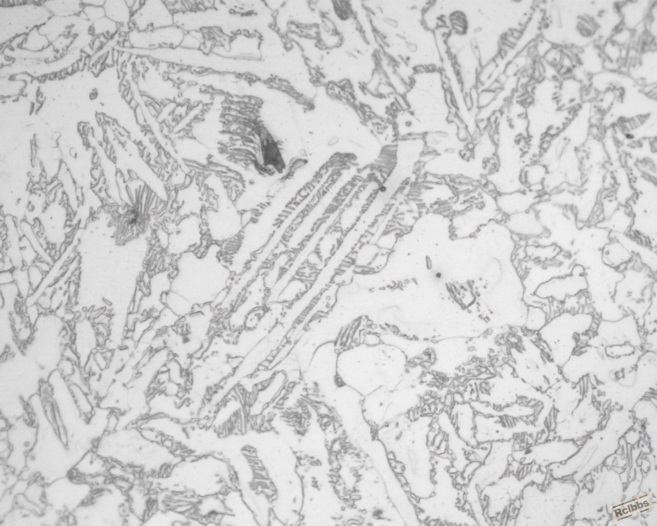

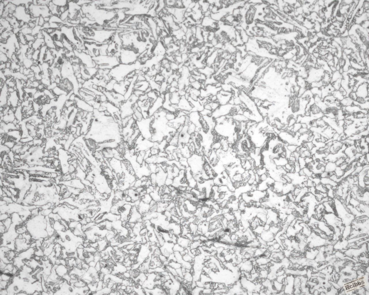

C%0.38 .Si0.19%.Mn0.57%   P0.015%  S<0.010
前两张是500倍的,后两张200倍的

块状F+P+少量针状F

铁素体+珠光体

这珠光体是不是太粗了点啊

The data of carbon content is 0.38. if the microscopic structure is P+ F ,We should find  around 49% P in the photo, But now, No more then 30% P was found in the photo,
So I think there must have some B in the sample.

应是经过退火的,组织为铁素体+珠光体。
原始组织中有魏氏组织。
