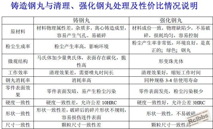

楼主: shotpeening
[讨论] 为什么国内厂家大部分用的抛丸介质还是选择铸钢丸而非钢丝切丸
 火.. [复制链接]
 楼主| 发表于 2010-10-23 15:34:44 | 显示全部楼层
Reduced parameters        Cast steel shot         Carbon steel cut wire shot
Raw material        bad physical property, more impurity, produced via centrifugal casting, air bubble generate easily ,broken easily         Material has a uniform composition, less physical defects, even wear, easy control
Dust generation rate         High dust generation rate, bad for the environment         Low dust generation rat, friendly to the environment, the true environment-friendly steel shot
Micro-structure         Add a little Austenite into Martensite, surface carbonization        Deformation pearlite
Work efficiency        Bad blasting effect, more time required        Good blasting time, reduce the time
Shots consumption rate        High consumption rate        Decline 70% compared to cast steel shot
Parts surface effect         Part surface staining, contaminated by dust easily        Bright surface, little dust
Hardness uniformity        Bad hardness uniformity, acceptance tolerance can be HRC10        Uniformly hardness,  not easily crumbled
Shape uniformity        Bad shape uniformity, scraps in irregular shape damage the parts’ surface        Uniformly shape,  not easily crumbled
Size uniformity        Bad size uniformity        Uniformly size, not easily crumbled
