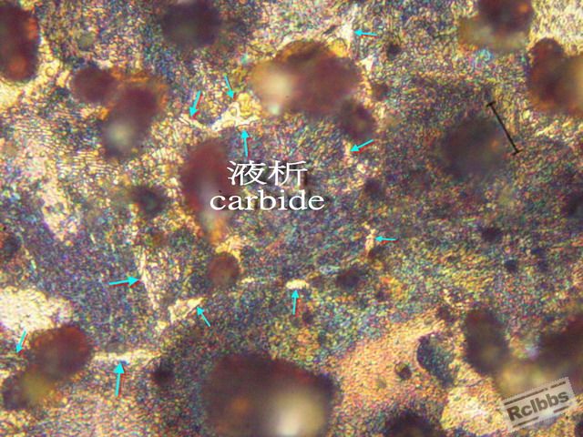

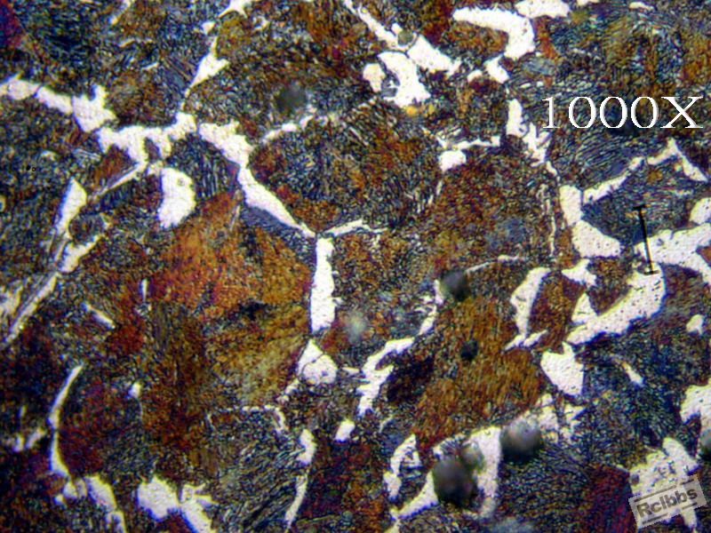

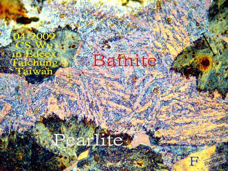

More photos from this faulty steel axle that cracked during induction hardening.
後來覺得這些 的確不是碳化物.

吴老师是个经验丰富的前辈,但上面的白色组织我个人认为不是碳化物,碳化物与碳含量有关,这种材料不可能出现这么多碳化物,是不是碳化物可以在倍数高的显微硬度计上检测一下硬度就知道了

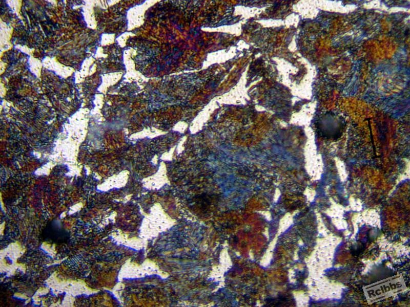

To all:
Is there proeutectoid carbide in this normalized 45# steel?
It says in textbook that proeutectoid product in 45# steel is Ferrite.

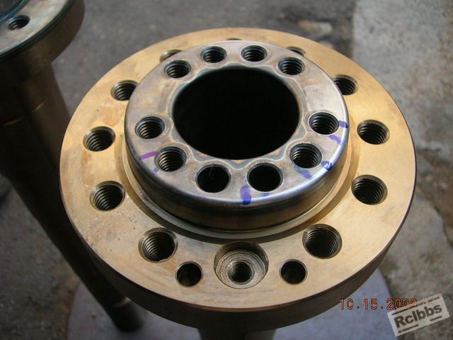

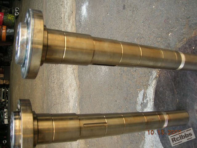

The above micrographes are from the axles shown below.

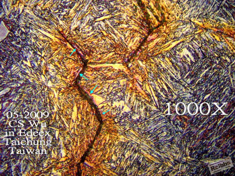

These axles for lathe showed microcracks after induction hardening. Some showed microcracks after tempering. 本帖最后由 leomet 于 2009-11-16 08:22 编辑

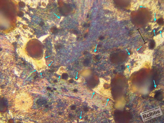

On my second thought, I think you are  correct about this. I should change my view point on this, some how.  Thanks for reminding me.
Those white spots  might be over-saturated austenite. But some carbide particles are among them is for sure. It is these
carbide particle ( in bad shapes) that give induction heattreaters headaches. 本帖最后由 leomet 于 2009-11-19 06:42 编辑

可以分析一下,42CrMo在什么情况下会有碳化物:
     42CrMo属亚共析钢,无论是在那种状态下都很难出现游离态的碳化物。

发表于 2009-11-21 12:59:00 | 显示全部楼层
此图片不像液析,液析不会沿晶界成网状分布,而多是沿变形方向且量少无多边形形态

是铁素体吧】

看着不像碳化物。你可以做一下电镜。打一下成分不就知道了
