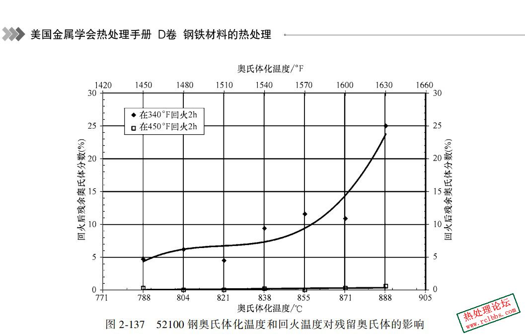

According to Boyer (Ref 21), in many
instances, finely dispersed residual austenite in
amounts up to 30% is not detrimental to pitting
fatigue strength of fully dense steels.                                     见  P263页,  ASM HANDBOOK  VOL 4D
